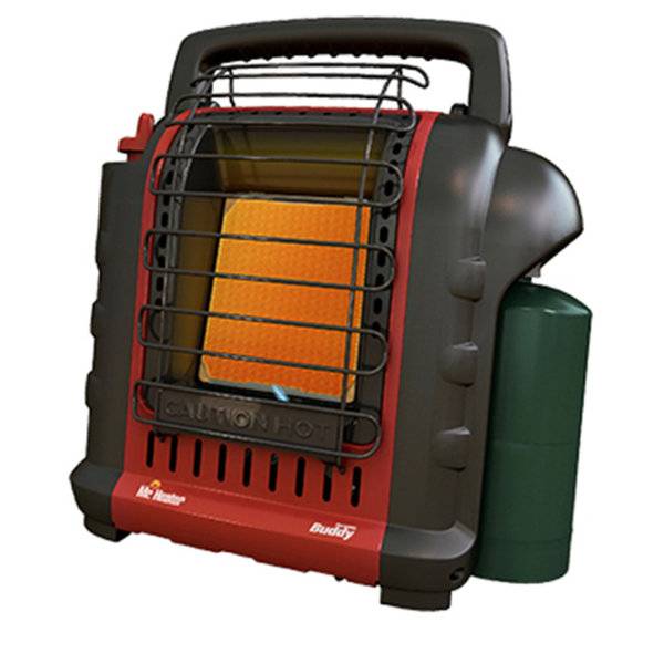

That's what I used with a Mr Heater Buddy heater for about 4 years before I could afford a better alternative.

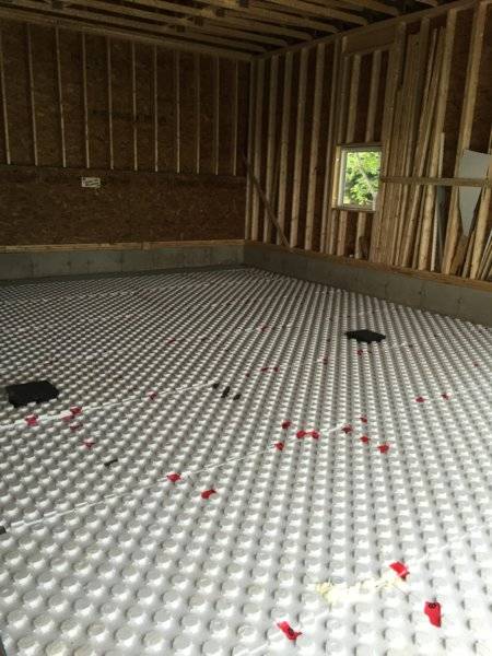

, in almost 40 years using them no problem ,no in this age I have been checking into the radiant heat tubes
If you set the thermostat a 70F on both scorched air and radiant the radiant will likely use more fuel but the space will be too warm
If you make it comfortable with both the radiant will use less as objects are not drawing your heat and if the floor is warm you do not need your head to be
I installed a pair of tube heater in a shop that did trailer repairs and when I saw the owner the next year I asked if his gas bill went down and he said no but I got to work in a tee shirt and water never froze in the corners any more
You are looking for something to keep your shop from freezing between stoking your wood heater
I would go with the radiant tube heater just over your main work spot comfort for you well the wood heater warms the rest up
