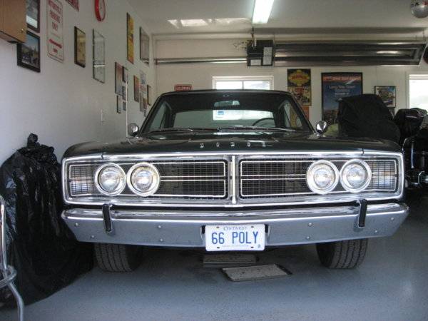

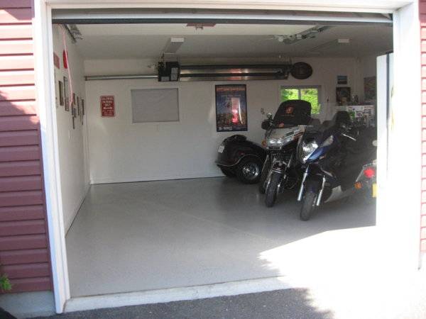

Here's the solution I used - a tube heater. Built my shop in '04 & was going to install a wood stove. Once I realized what it would cost to meet fire code up here, floor space lost, wood cost & storage, etc. this heater was a bargain - $2200. installed, I dug the gas line trench & framed the roof structure to hold it. No pilot light & sealed combustion chamber means it's perfectly safe. I used a "honeywell" household thermostat. Because it's radiant heat, the whole shop maintains the same temperature & it has worked flawlessly ever since.

I like the idea of these but everybody I talk to says because they blow threw a tube then exhaust they aren't as effecient as a unit heater. Doesn't mean they'r not great but my primary concern is fuel usage, I'm looking at units that are 93% effecient.
