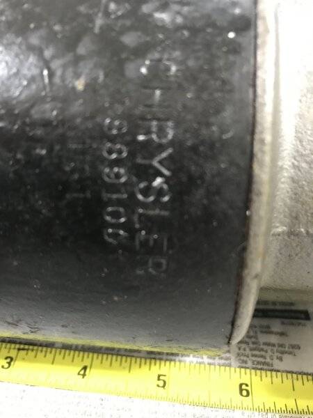

This direct drive starter is in my 66 Hemi. Case number is 1889100, also 131 below that.
Nose number is 3924.
Seems to be a six cylinder starter with a manual transmission or Hemi nose on it.

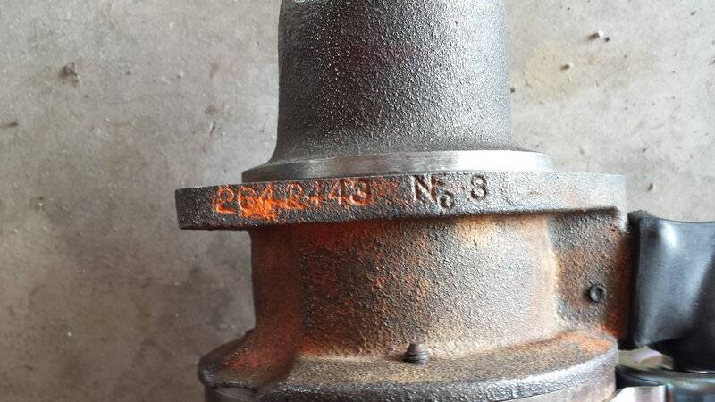

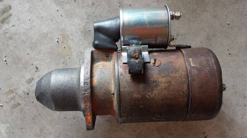

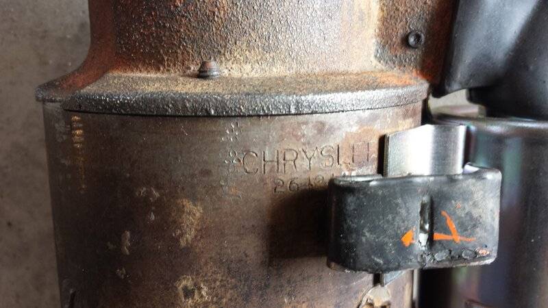

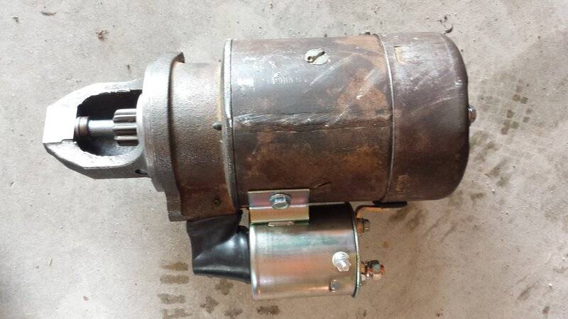

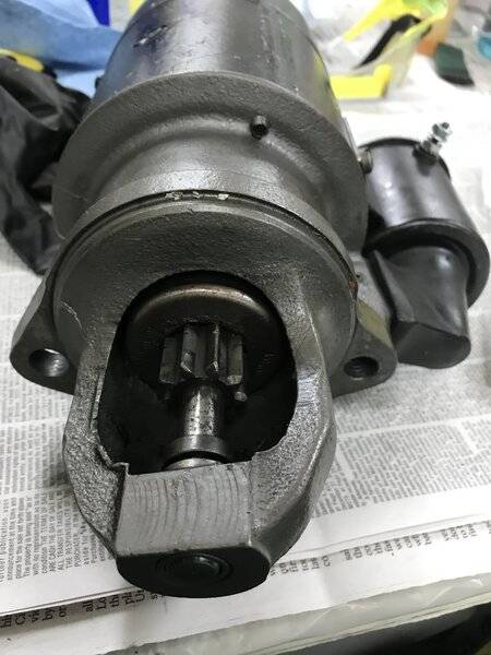

Mine seems to be fine Fran - just removed it and the manifolds to re-coat them. Thought I would try to find out something about it. I think it has a different snout on it. Here are some pictures - maybe they will generate some info. The main case is 5-5/8” long and about 4-1/2” in dia. It secures with 3 bolts and like most things with a Hemi, it’s a pain to pull.

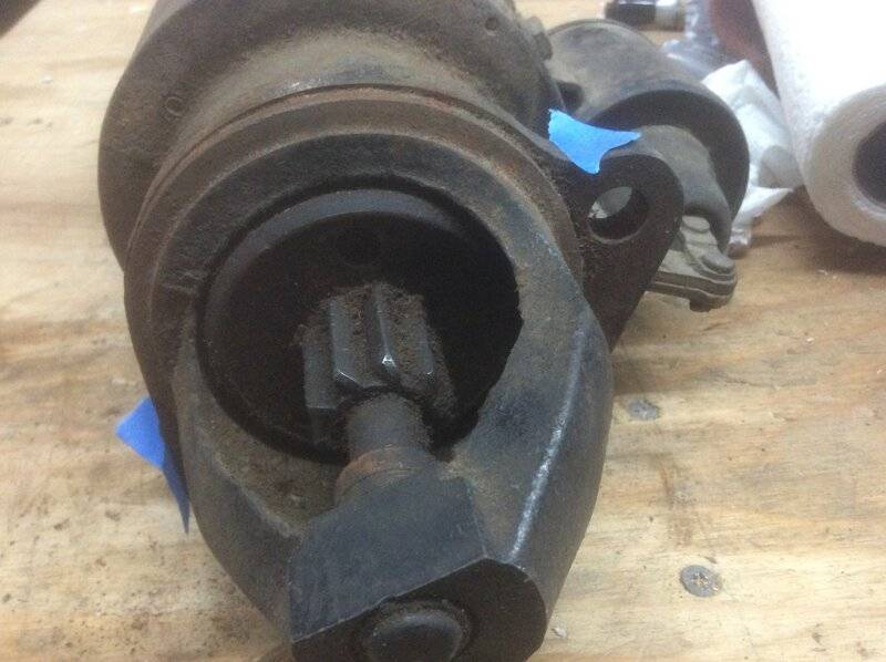

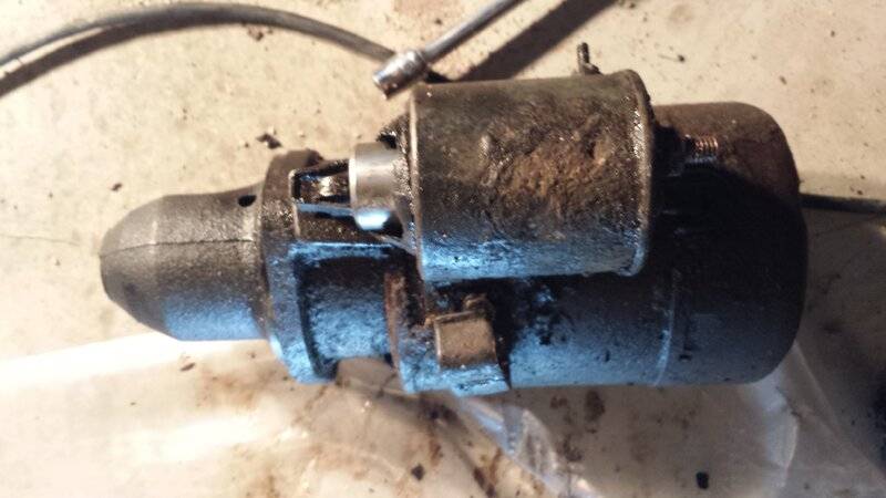

Here are some pics of mine if it helps. Apologies for the picture quality of some of them and the incomplete number - which looks like it begins with 2612. These pics are from before I had it rebuilt and after. One of the interesting aspects is the orange paint that sugests the starter was mounted to the engine before it was painted.
Thanks for posting. Visually that looks just like mine - straight slotted screws in case, same nose piece. Hard to be sure but from the position of the solenoid I would judge the case length to be the same as mine.
it does the job, so 6-cylinder origin or not, I guess there’s nothing wrong with it.
