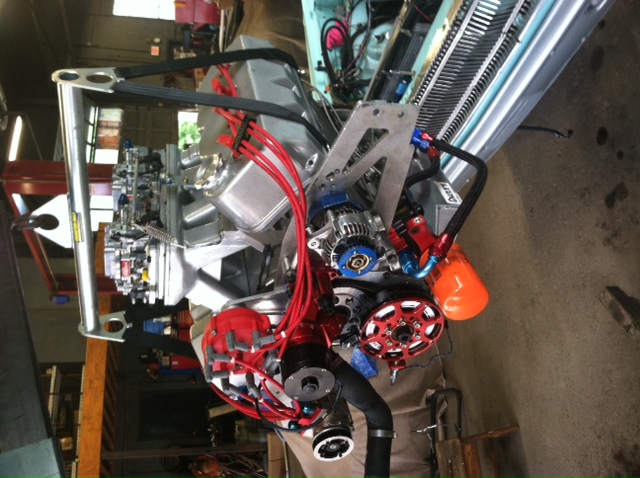

Well I got that covered and then some
Forged pistons, good fuel pump, Turbo, blow through E-85 carb.
