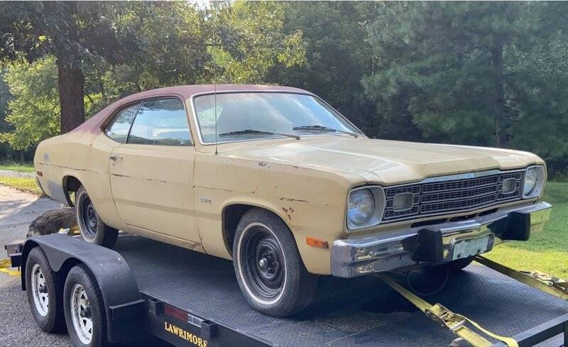

Just picked up this 73 A-body Duster /6 about as basic as you can get. Trying to decide what to do with it, probably keep it stock. Only 90K original miles.

Scuff it and paint it tu-tone...original brown/beige and then a white painted top, bit of pin stripping decal to separate the top and body color and you'd have a nice looking little car.:thumbsup:

I will take the ideas. I want to make it drivable while I work on the Roadrunner so I have to patch the floors and I will probably put a coat of paint on it before winter. Same color "Honey Gold" per the fender tag. Has Gold interior too, but in surprisingly good shape. It came with the hubcaps too, so I am probably keeping the poverty wheels for now, which means 4-wheel drums. (rotor kits switch the holes pattern and don't clear the steelies).

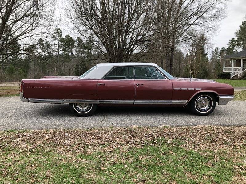

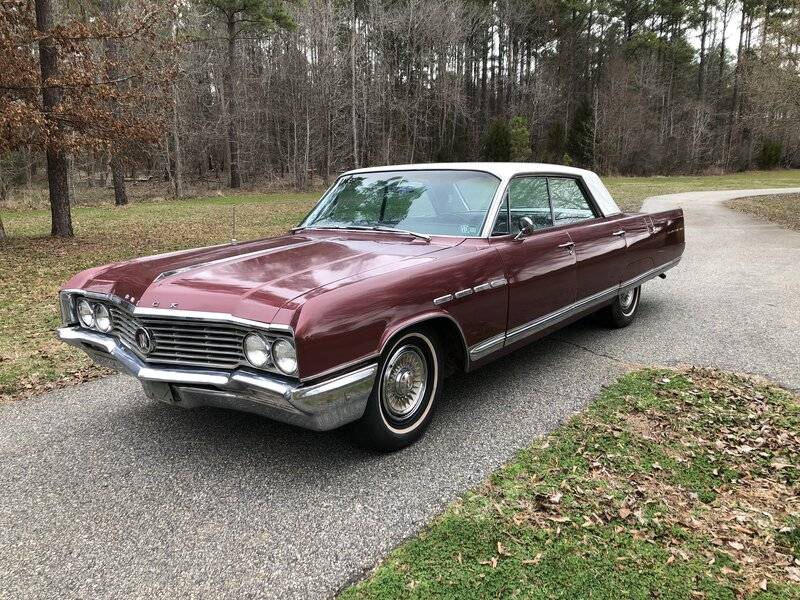

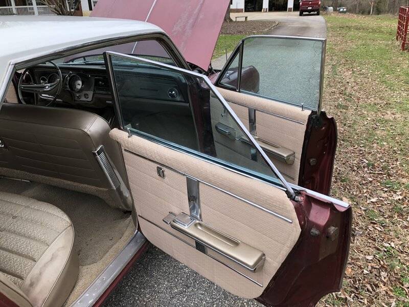

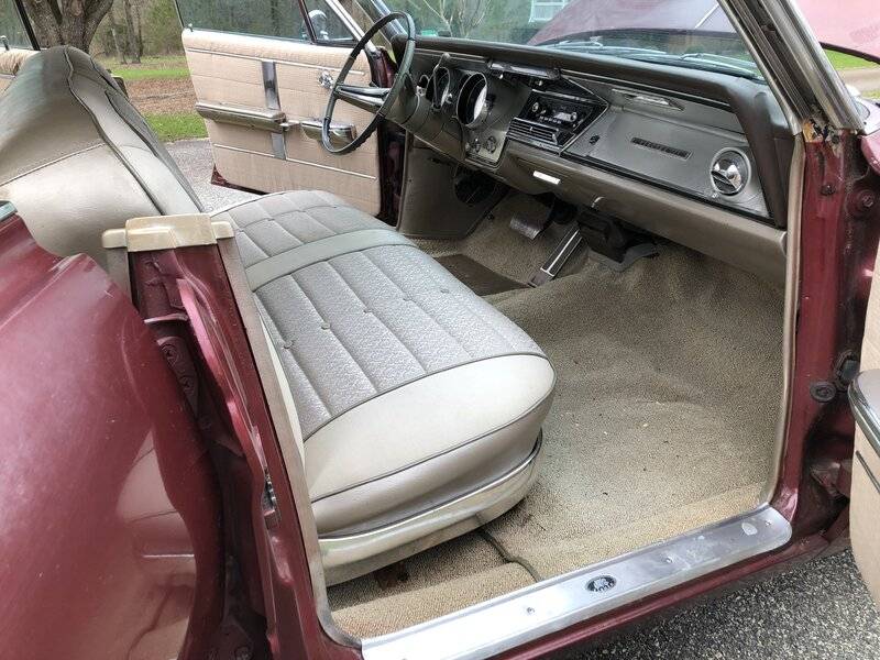

You shoulda bought mine, I sold it a year ago to a guy in Sweden. I just did some basic restoration and drove it for a while, but it was too much of a boat for me. I really like the missing B-pillar look. The frame is strong enough for suicide but weatherstripping may be a problem. Also, I had lots of internet arguments over if its a hardtop, a sedan, or a hardtop sedan. LOL Don't get me started.
This was taken as I was cleaning it up.

Very nice. I always like them from the front of the front doors to the rear bumper. The front end turned me off, poor design. The Pontiacs and Caddy's got it right. Would make a bitchin looking car grafted together. Plus square up the front edge of the roof line and get rid of the curve up there. Stacked headlights rather than side by side. The weatherstrip could come from a 64-65 Conti...
If you draw a line down through the car at the center it looks like two different cars. Rounded front end and squared off rear end. If you cover the front half of the car up, and look at the rear section it's all angles, no rounded parts. Do the same with the rear half and the front half is all rounded lines, no angles. Very strange design.

(back bumper is rounded per the above pic, front fenders are also rounded but look squared in the pic)
Yep, pretty well rounded.

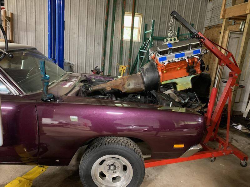

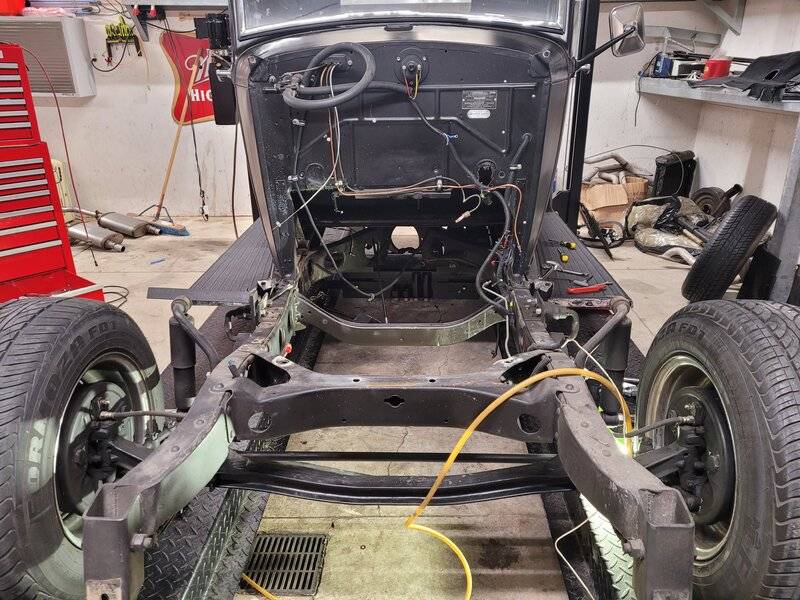

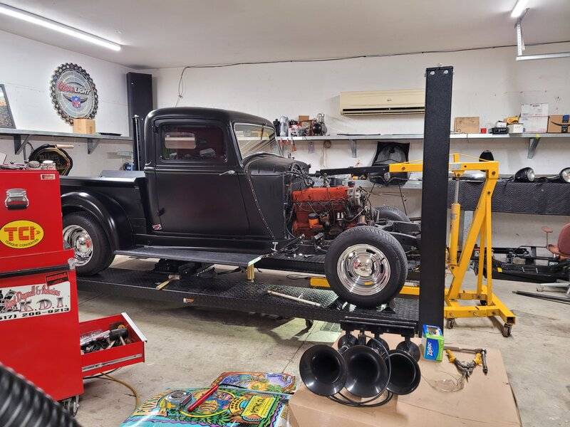

got the 34 tore apart blew up the flat six test fitting the tower of power

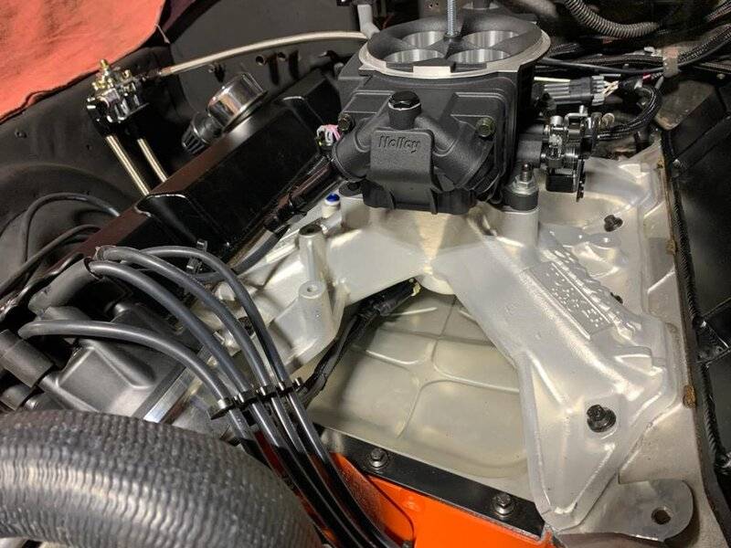

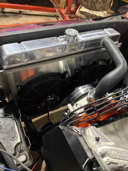

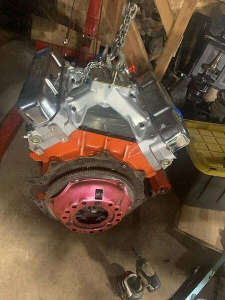

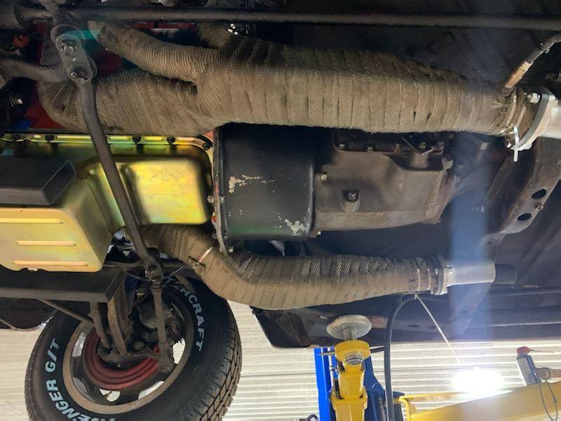

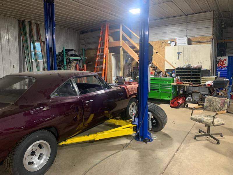

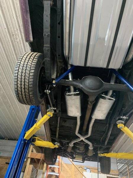

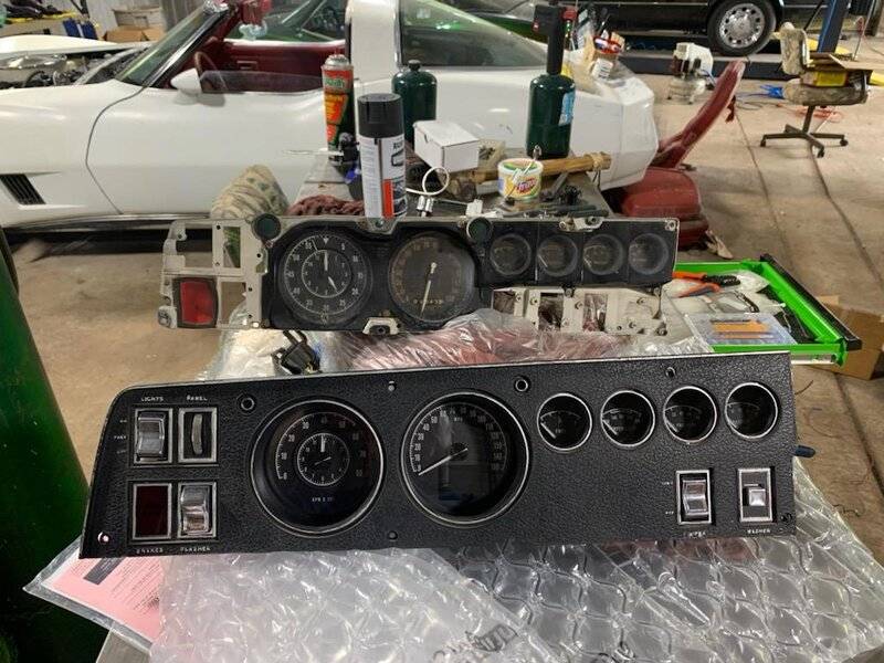

Bought this 1969 superbee clone last July had a cam lobe go in the first week so I went with the "well as long as I have the motor out, mentality" and one thing led to another. Started by stiffening the car/suspension with the hemi leaf springs and a set of CAL-TRAC's added subframe connectors and front and rear torque boxes and custom skid plate for a 7 quart oil pan, then went to the Painless wiring harness, new fuel tank (with in-tank pump) all new brakes/lines and master, Green bearings and new set of 3:55's in the rear-end, 440 turned into a 440 source kit - heads to crank - 512 with the Holley Sniper Stealth EFI system and the Holley hyper spark ignition system then added the TTI 1 7/8's headers (Wrapped) and TTI X pipe exhaust system with Dyna flows, up front switched to a cold case radiator w dual electric fans and only change inside was a Dakota Digital RTX Rallye dash. All the fun runs through a 18 spline 4 speed down to some old school alum slots. And YES its FUN!!!
