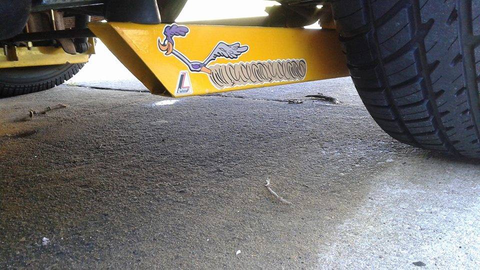

Do you run them tight all the time or loose and let them slap? Whence the term slapper bars.
The first car I had them on was a 73 Roadrunner that someone had put a set on before I bought it, and they were installed to be horizontal with the body, so they were more for show. This pair I mounted so they are 1" below the spring hanger, which is where they are supposed to be at.

Not to mention in your case, Bru, they just happen to match the color scheme of your car! LOL - by the way, you need to update your photo garage!
Well, you can paint them any color. :) The set that came with my 73 Roadrunner were chrome.
