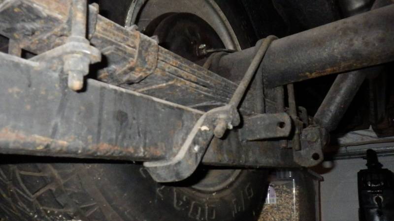

I think my traction bars are Lakewood's (they are chrome). I got the on sale from Jegs or Summit years ago. I'll attach a couple pictures but I am at work and only have a few on this machine. They are hard to see. They are directly under the leaf springs. I have used the spring clamps before myself, but not exactly for traction, because I had a broken leaf spring. They are 2 metal plates about 3/8" thick that are just wide enough for the ends to extend to both sides of the leafs; there is a predrilled hole at each end of the plates that you put bolts through that come with the kit. It was cheap, maybe $10 or something. Before you do anything else, try inflating your tires to maximum and see if the hop is better. I have seen results with this sometimes, depending on your tires.

Spring clamps can help but in street use, the bolts can sometimes break. Lots of stress on them. If you use traction bars, do not use the short ones. IE, you want the traction bar rubber snubber to land on the spring EYE and not the leaf itself. If you can't find the longer bars, modify the short bars to where that happens....unless you like bent main leafs. With enough power and traction, it can happen.
I have seen and read several times that traction bars don't help much. It has been found, however, that much depends on how they are mounted. To get the most out of them with leaf springs, it is imperative that the front rubber snubber be mounted directly below the front spring eye. Not sure with other applications such as coil springs.

Seems like over the years, short bars are all I've seen that was sold over the counter. The first time I drove a car set up with the longer bars, I never looked back and imo, they work better than the DC snubbers did.
