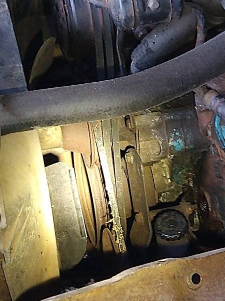

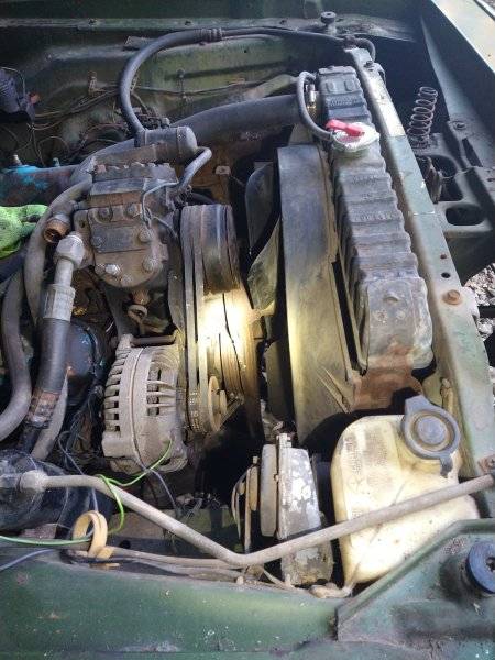

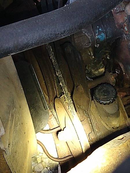

Where do I put the breaker bar to try and crank it? The engine is locked up. 1971 Plymouth satellite 318
1 1/4” socket on balancer bolt, hard to get to with AC
If it’s locked up remove the 4 shroud bolts, slide it over the fan. Drain and remove the radiator then shroud. Give yourself some room to work without damaging the radiator. Bolt is inside that lower pulley.
You can also try from underneath if you can get under there, I have found this sometimes works better as you can get a foot on a tire to help with leverage. I'd recommend removing the spark plugs to give yourself all the advantage you can. On that note, it may be possible to free it up by pouring ATF into the cylinders and let them soak. Some people use ATF and diesel, some use Marvel Mystery oil, etc. I am sure others will chime in with their concoctions.
