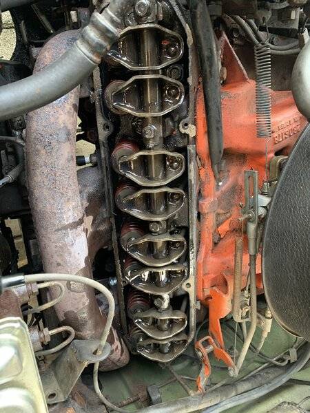

Since i picked up my car from the shop its making this "ticking" noise.
See attached video. Already pulled the valve cover but everything looks to be okay. (Now back on)
My guesses (im not a professional mechanic / sure though):
- It seems like it comes from the driver side.
- It also seems to get louder as you accelerate.
- For me it seems like its not coming out of the engine itself. The engine is also running just fine.
Exhaust leak maybe?
You think an exhaust leak could be responsible for the "ticking"?
I'm not sure but i will investigate a bit further tomorrow.

There is no oil in the pan if the car is pointing toward the sky as the picture shows.
The work they did I can’t see causing an issue. I listened again and if I’m listening to the right sound, it’s an exhaust leak I’m hearing.
