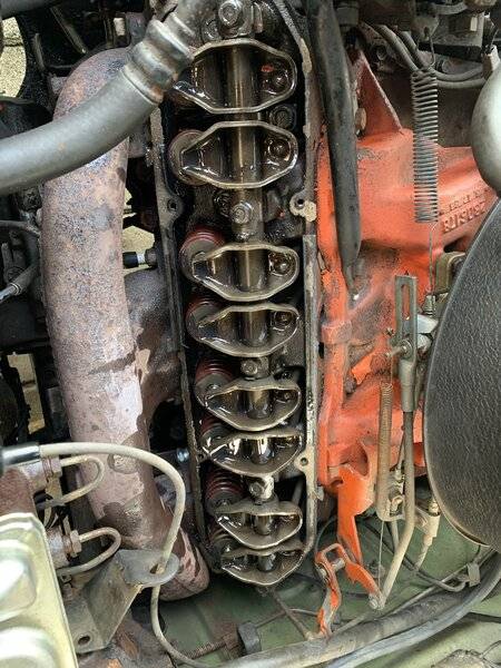

Since i picked up my car from the shop its making this "ticking" noise.
See attached video. Already pulled the valve cover but everything looks to be okay. (Now back on)
My guesses (im not a professional mechanic / sure though):
- It seems like it comes from the driver side.
- It also seems to get louder as you accelerate.
- For me it seems like its not coming out of the engine itself. The engine is also running just fine.
