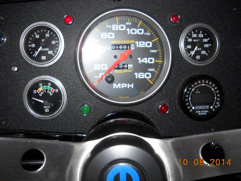

I bought the Innovate unit from Summit and installed a bung in each collector. The crossram has no common plenum so I have jetted each carburetor by moving the sensor from one side to the other. Works well and it's kind of neat to watch the A/F change under different RPM and load conditions.

I asked Innovative about doing that and they said due to the configuration of the cable that it can't be switched. Their solution? Switch manually or buy two gauges...I've only switched mine once after I got the carburetors dialed in, but mine's a street car.
