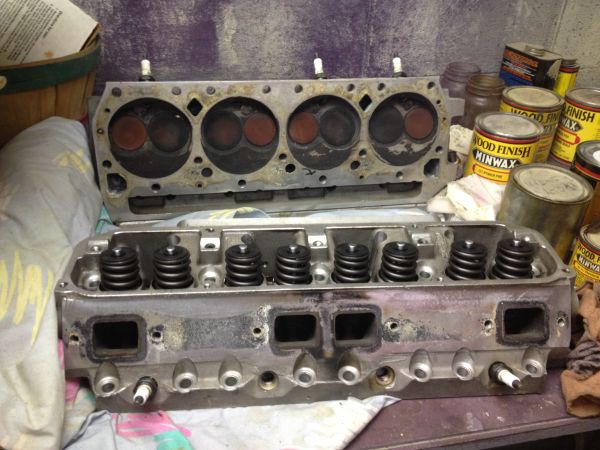

im building a 440 30 over and i gotta find some heads, i have some 452s iv rebuilt but im gonna go with something else..not sure what though..my cousin says go with aluminum heads and do it right the first time...but which aluminum heads should i get? iv looked at elderbrock, mopar stage 6 and stealth heads..out of those 3 which ones the most recommended..my cars mainly a cruiser and weekend warrior ..wont see any track time, so something mild is what im looking for...and something affordable if thats even possible, any help is appreciated..i found a set of mopar stage 6 heads pretty cheap but not sure if there good..there 78 cc..would i have to modify my block to use them or do a bunch of work to the heads after i buy them? would they be worth buying for 700 bucks..they have around 500 miles on them the guy said and there ready to put on engine the guy told me..heres a pic of them mopar heads.jpg

View attachment 130212 are these mopar stage 6 heads good? there pretty much untouched and the way they came new,. i can get them for around 700 bucks...or would it be worth getting some 906 heads and putting hardened seats in them? how much is it to put hardend seats in heads now..seems like the 452s are way better than a few ppl keep telling me..
Can't say much on the stage 6 as I've never used them. 906's aren't that much better then the 452's but the 452's have the advantage of already having hardened seats. With a cruiser, weekend warrior in mind the only thing you'll really gain is a lighter head, cooler looks and more resistance to detonation with the aluminum heads. The 452's will easily get you into the 500 hp range without much work, not trying to convince you but people have a habit of always thinking bigger is better when that's not the case. Why don't you tell us what your goals are. I can say that if your heads need much it very well may be worth buying a different set, I've got a significant amount of money in mine but they needed everything. Figure out what you want out of the car then figure out what it will take to get there, you'll probably be supprised.

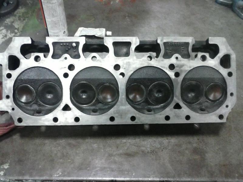

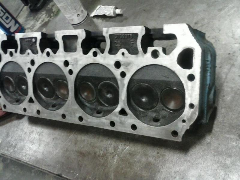

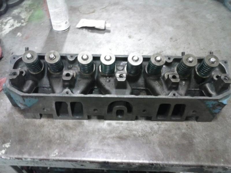

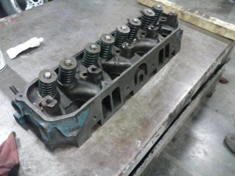

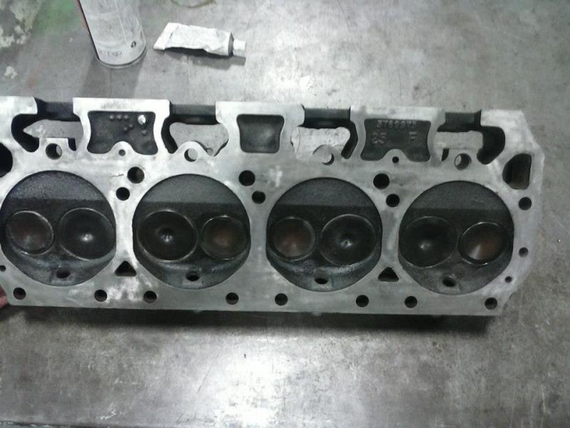

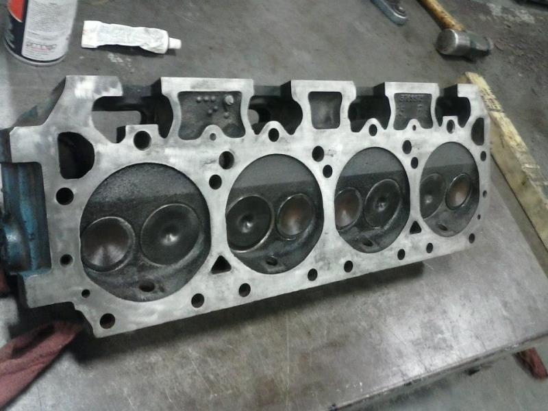

im just wanting a mild engine, id be happy with a stock 440 honestly ..my cousins pushing hard to get rid on my 452 heads, says there a waste of time..he has a indy hemi that cost alot and always goes big,,i wanna keep them and stay on buget...the blocks being bored 30 over, other than that its going to be pretty much stock..even putting manifolds and stock intake on it..i want it too look like it came in the car originally..i rebuilt the 452 heads my self..im almost done with college and im becoming a certified mechanic..i have accesses to all the stuff so i did a complete valve job and rebuilt them back to stock with all new valves..i used the original style valve seals, some ppl said i should change them to the umbrella style cause there better..thats all id have to do to them if i did anything at all, heres pics of my 452 heads

wait, wait, wait a cottonpickin' minute!! you mean to tell me you rebuilt your own heads and are considering buying a set??
damn it man! use what ya got, and run the crap outta them!! ya, your cuz may have mr. big-shot heads, but you re-manned your own and brought them back to life!!! that's worth ten times what them "other" heads are worth!!
If all you want is a stock engine then use the 452's. The springs on those heads will not be good for any kind of high perf cam but it sounds like you are going bone stock anyway so put it together.

For a mild street car the stage 6 heads will require too many changes because of the raised port design. I think they require an offset intake rocker arm, an intake manifold spacer, and maybe headers that are compatable with the cylinder head/car body. On the other hand $700 sounds like a decent price, maybe get them for a different project?
What work has been done to the 452 heads? The stock heads have potential, but professionally ported, and rebuilt 452 heads cost $1,500+.
