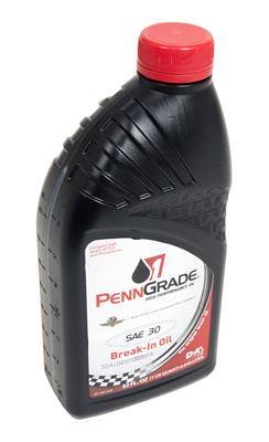

Been using brad penn and wix in all my stuff for quite a while.
Brad penn has gone up in price as they either sold or changed distribution somehow.
Bought out by Penn Grade. Same formula as before and same formula as when it was Kendall

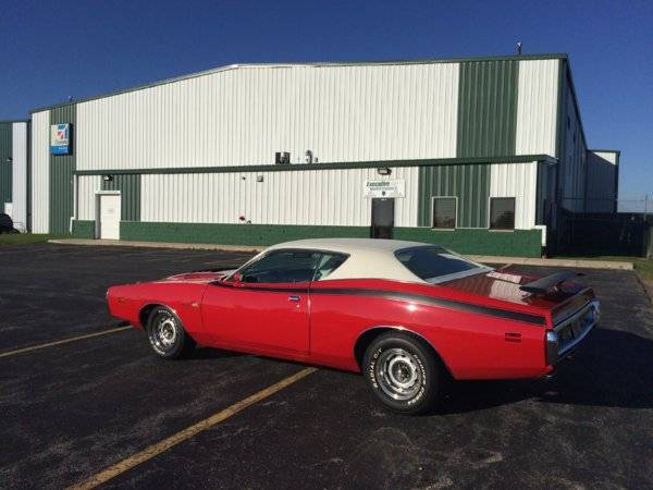

Nice ride it looks great

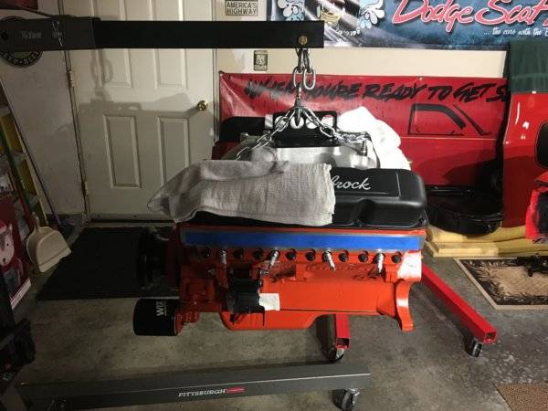

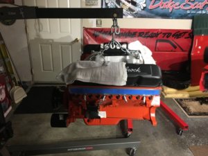

Just Broke In My 432 Stroker / 440 Source Kit - 30 Minutes Break In
Used Comp Cams 10w30W Break In Oil - Primed The Oil Pump First And Rotated The Crank For Oil At The Rocker Arms
Had One Of My A@P Mechanics At Work Cut Open The Wix Filter , Poured The Leftover Oil From The Filter Through A Coffee Filter , And Cut Out The Media And Stretched It Out - He Said It Looked Beyond Perfection
Very Happy
Now Just Need WI Warm Weather - Bee Running Valvoline VR1 Silver Bottle Oil Also
