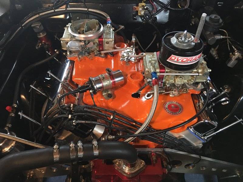

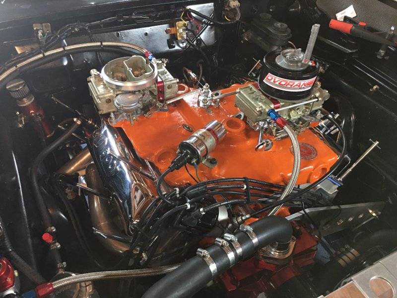

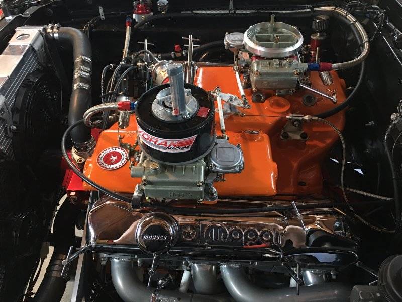

tuning on my max wedge today running modified holley race hemi 4235-36 carbs.
these things really woke this motor up ! no hesitation anywhere. it wants to wind!
found that adjusting both the primary and secondary idle screws u can move the AFR around, adjusting only the primarys the afr was 12ish, by tuning with both i raised it up to 17-18 and then brought it down to 13.5-14.8 by tuning with the secondary screws. no puddling on idle now and the idle air screws became sensitive..it also doesnt like higher float levels, drop them below the hole and cleaned it up. some more to go but its real close.

yes QFT blocks and plastic type rear floats thar r notched to clear the added jets, i did ad a allen head screw for access to the secondary idle screws so that they can be adjusted without taking the carbs off,,wrapped them with teflon tape to titen them up in the hole..it was fighting me on the tune until i started playing with both front and rear idle/throttle plate positions. but then it hit the sweet spot and suddenly they became very tuneable, idle air bleeds, no more loading at idle which is at around 14-1500 rpm, .675 roller. drop it in gear (which drops the rpm to around 900-1000) and no loading up and dying..i thought u mite find all this interesting because of your dart hemi..

On your carb pictures a guy sure can see where the fuel level plug on the secondary bowls is lower than on the primary bowl. About .100 lower I believe.

wasn't exactly thrilled on the notched float bowls of the secondary floats, they used epoxy smeared on them, may have to look into center hung brass float bowls. but am pre registered for a couple of car shows in the upcoming weeks so that could be for a later mod. will finish tuning later this week. which will be equalizing the afr between the carbs, only 1 point off with a simple twist of the secondary idle screws, be sure to look at the emulsion bleed sizes that i posted , they greatly reduced the fuel at idle..

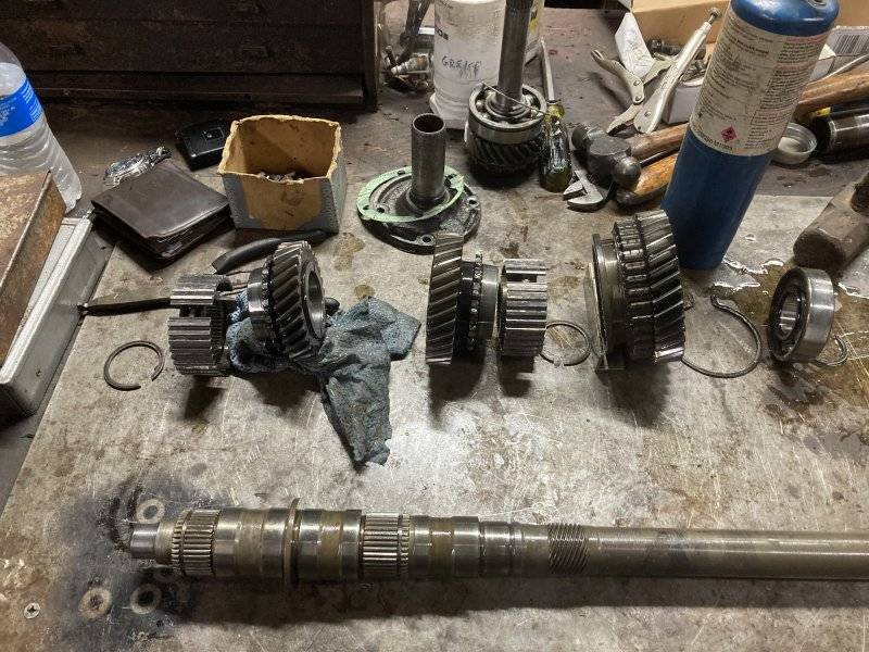

Going to send this mess to Liberty for faceplating.

Anybody know someone at Liberty’s Gears that can get my parts moving?

They had my gears for 5 months getting them face-plated then I called Paul in the shop and told him I was coming up there to pick them up done or not.
I left Rittman at 6 am on a Saturday morning and the gears were still warm when I got to Liberty's

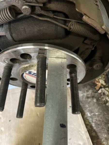

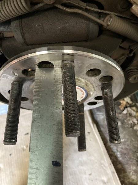

Some bent studs hey. Yep I’ve been through that too. I replaced mine with ARP studs and started torquing to 120’ lbs and no further issues.
Upgraded to 5/8” over the winter now, no longer an issue, ever
Yeah I had the same deal with my Savoy. I think it's the generic bolts that come in axles from Moser,Strange,etc...
I talked to Doctordiff about studs after the ones in my axles bent. He tested some of the so called "grade 8" studs installed in some axles and found they were sub standard. I put the ARP studs in my axles and never bent another one.
Gus
Yeah I’m thinking of going to 5/8. I had Weld wheels with the thick hubs. Towards the end of last season I switched to vintage slots with thinner hubs, but they do have unilug holes.
How does it work with studs? Are there sleeves that fits inside the wheel holes?
I also had an issue with my brake drums dragging so I had .090” spacer between the drum and axle.
Should I put a shim between the retainer and backing plate instead?
You can get steel shim gaskets for Mopar ends. There were some on the axles in the original rear of my Savoy.
I have a .125" spacer between the rotor and axle on my racecar. Doesn't hurt anything. What wheel are you running. Bending studs comes from A; lack of torque. B; lack of surface contact between the wheel and drum/rotor. I ran 1/2" studs for years on my racecar. Eventually broke the wheels themselves. Never bent a stud. Always torqued to 100lb/ft. My sons car bent studs with drag radials, steel wheels, and a trans brake in about 100 passes.
Doug
The whole rear was new last spring, s60 from strange.
I had Weld Rodlites for probably 100 passes, they have the thick centers.
Then switched to old aluminum slots. Around 30 passes. They have a 1” thick center, full contact on back face.
I don’t know at what point they got bent as I just noticed it the other day.
I’m running a 4 speed so I know that’s tough on things.
I’m going to an adjustable pressure plate this year, so hopefully I can soften the hit some.
