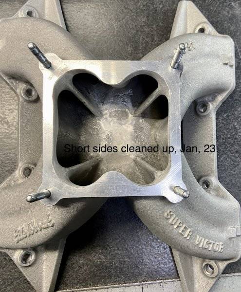

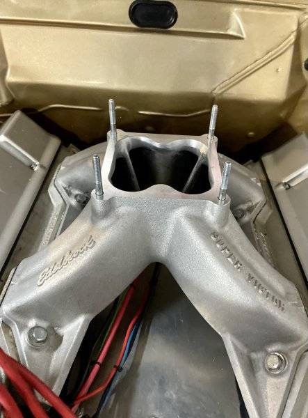

Pulled the MW Super Victor intake off the 505 a couple of days ago and spent some time doing a little blending on the plenum base. A couple pics of what I was up to.
Time spent rounding the short side under the plenum base at each runner. Pretty hard to tell on this picture, the clover leaf was left untouched, just rounded entering into each runner.
This picture shows a little better how the radius blends now. I would have loved to get into the clover leaf area but lots of guys who have, say “don’t do it”.
Right now I run a 1/2” 4-hole wood spacer. I’m limited to a 1/2” spacer due to height. Haven’t tried anything else. Perhaps some of you guys have had success with spacers under super victors so chime in.
I’ve read that some fellows who have opened things right up, clover leaf gone and all, ended up with no gain and even loosing power. I can’t put it back if I grind it out, so. Figured I would keep it simple and be happy with maybe a couple HP gain. So that is the deal over here at my camp.
I found the best way to do the leading edge of the intake runner is to use a long piece of Crocus cloth. Run it up the port around the edge and back down the port. It'll round the divider wall to a perfect radius.

Well damn. Have 2 rolls sitting in the drawer, never dawned on me to try it. Those dividers are tough to do from the top. You can bet on the next time off it will get the crocus cloth. Great tip, thanks!

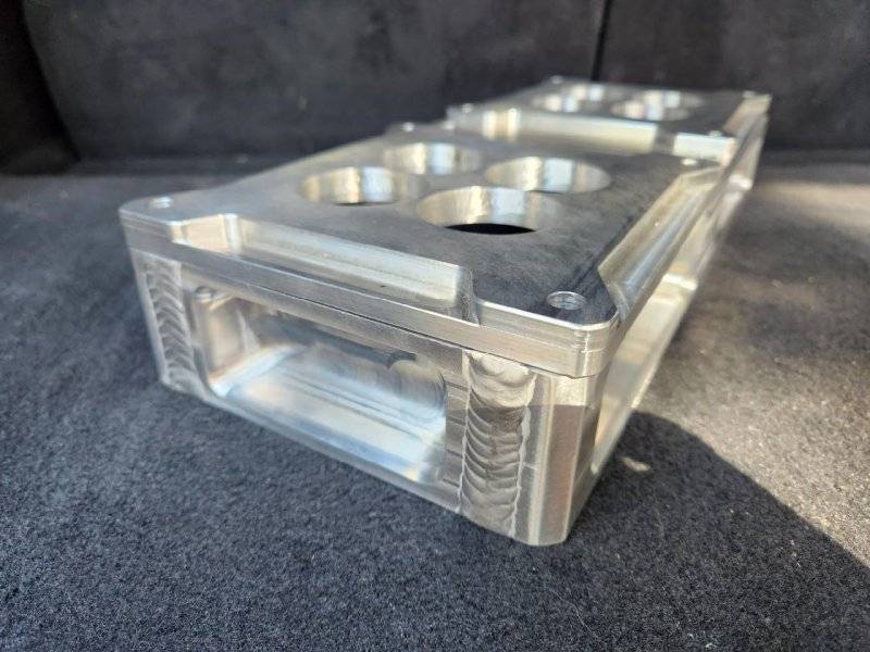

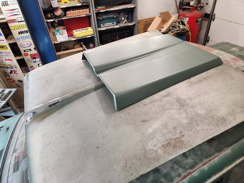

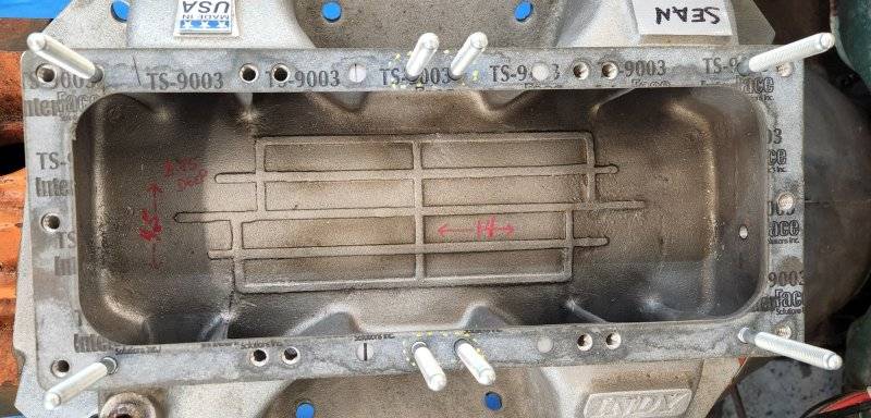

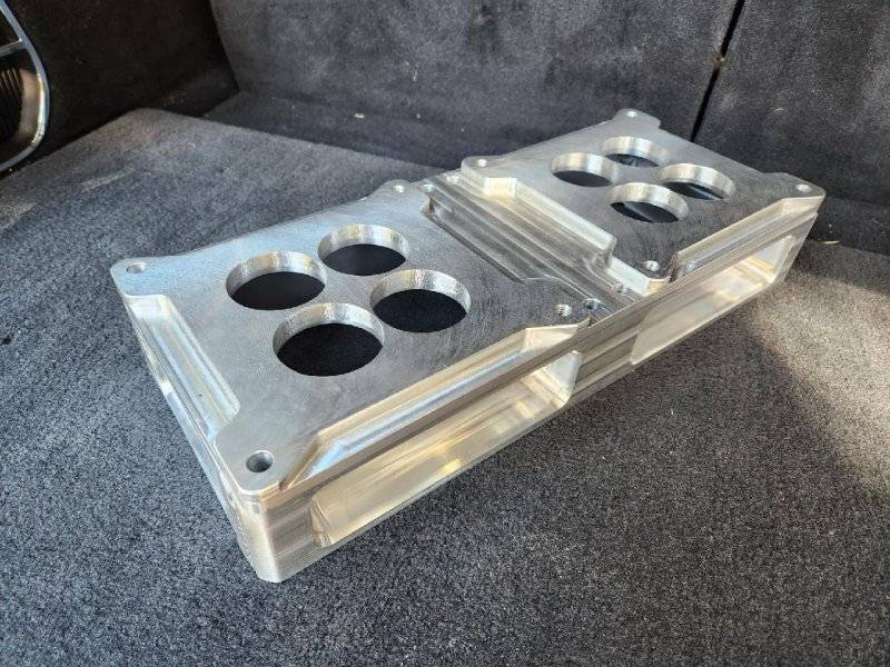

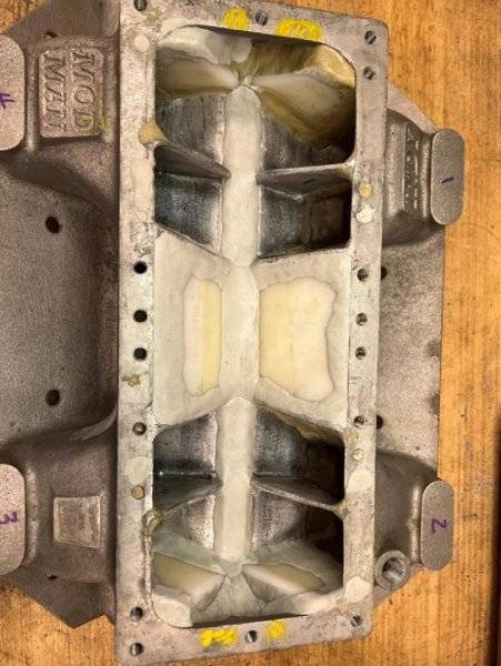

Pic #1 is a stock Mod Man. Pic #2 is the modified version. The center of the floor has even raised and radiused. The runners have been lengthened. The runner length and design was discussed with Larry Meaux. Pics #3/4 are the plenum spacer. It also has a different lid with the carbs spaced further apart. We'll see this Spring. 485", Crower light weight crank, GRP aluminum rods, 12.3-1, [email protected]", vacuum pump, ported Indy SRs, T&D rocker, 2 Carter Comp 750s.

My goodness…… That intake looks like a ton of ingenuity and work. Please keep us updated on the results.

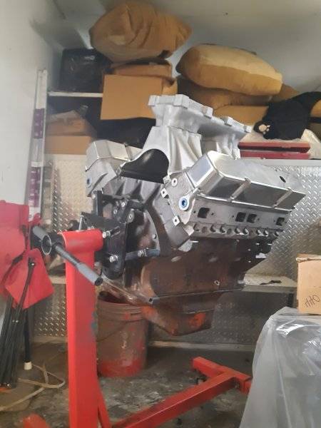

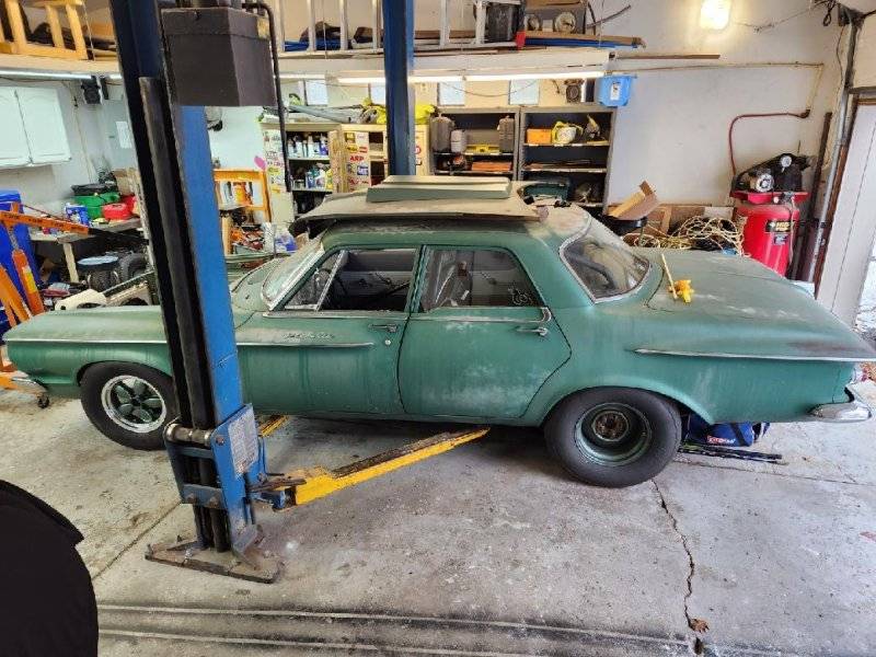

That pretty motor going into my sons not quite so pretty 62. It's getting 3 more bars to cert to 8.50. A a huge weight loss program. Lost close to 400 lbs from its turbo SB stock street days.

I ported for a living, This is some next level stuff..

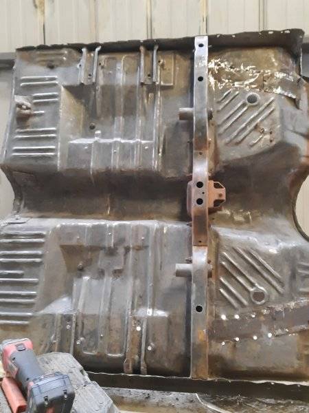

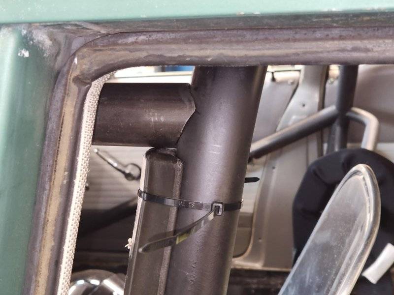

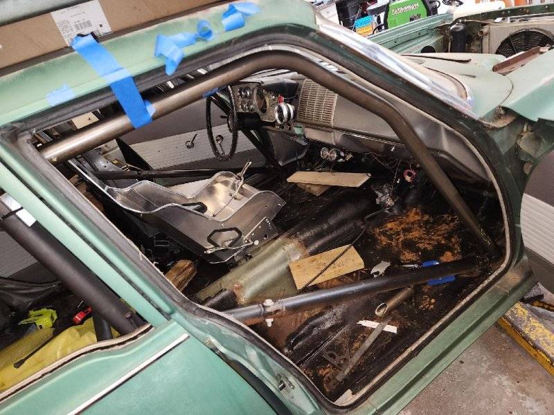

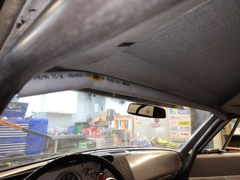

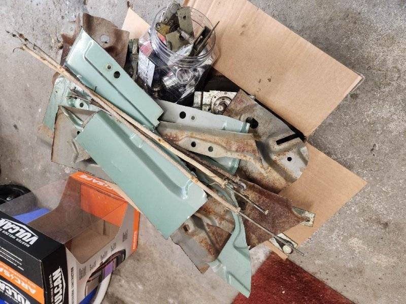

Off season my brother and I have been prepping our 69 superbee for race duty. Unfortunately, I managed break the camera on my phone...meaning photos are few.
Lots of work ahead...Minitubbing with split monoleafs and caltracs, 11" disc brakes, new front floorpan and quarters. Narrowing a dana 60 w 4.88s 35 spline. 440 short filled, eagle rods, ported stage VI heads, 13.8:1, weiand tunnel ram, 750 holley ultra's, 278/[email protected] roller .682/.700. 5500 stall and a brake. 2 1/8 hooker super comps. 16.5x31 et streets.
I cut a real nice Floorplan out of a wrecked 4 door...transplant is underway. It not likely to be pretty when it goes down the track this summer. Glad there is two of us and a friend helping on weekends!
