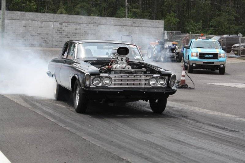

I'll agree with that as I like drag racing. Although I am not a competitor I just like to get my brick to go as fast as I can get it,,, legally at a track that has a prepped surface for max traction.

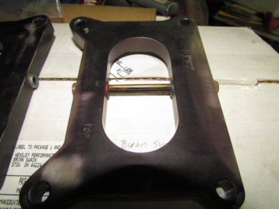

There is nothing wrong with nitrous. It's all about the tune. Been spraying at least one car since I was 16. Over 30 years and I have never blown an engine because of the nitrous. Even spray my 440 New Yorker with a 175 shot plate. My Challenger has multiple stages of foggers. We spray my buddies 275 drag radial 81' Cutlass from 10.70's to a best of 8.24 with a stock block 454 Suburban truck block.

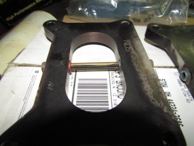

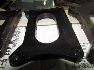

All cars and engines require a different tune/timing/plug. My Hemi's tuning is way different than my buddies BBC.
That is the one car I have not sprayed yet is my sixpack car. I do have the plates and power shot solenoids to piece together a kit one of these days

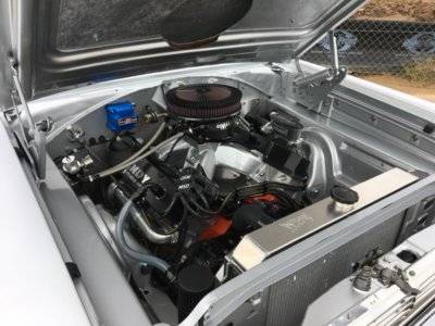

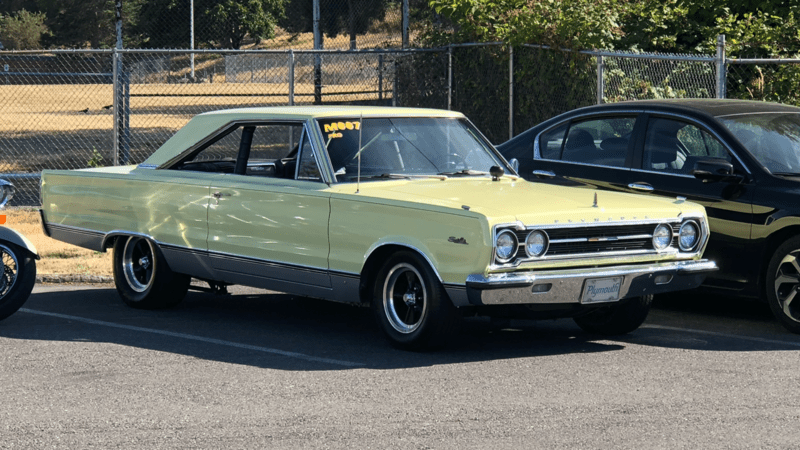

66 Satellite, All steel except hood, lots of sound deadener, Steel roll bar, Stock Seats and Center Console, Wipers, Heater Box, ETC.. 3750lbs without me, 4010 with. Pump gas, Stock Stroke 440, through the mufflers, 4:30's w/gear Venders, 4500 stall, I put nearly 2000 miles on it last year, Runs 167 degrees no matter what, Been 10.80's @ 124. Drive it whenever weather permits.
This is my version of a real street car and yes there may be an induction solution plate system in the near future....

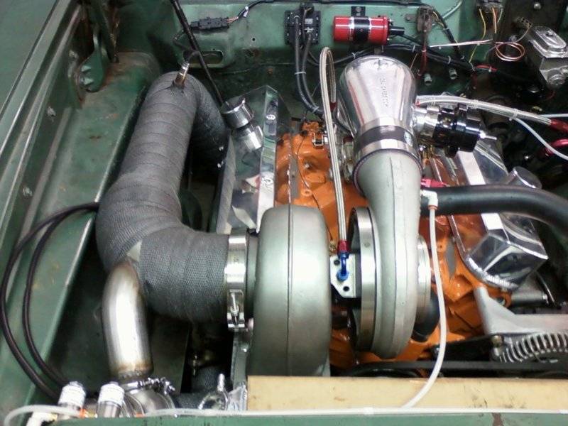

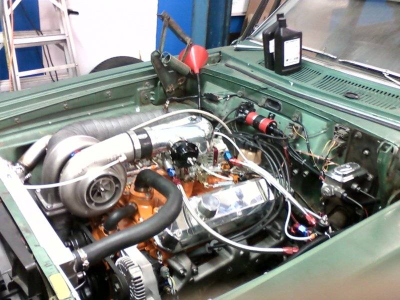

3775lb 4 door. 1991 factory roller LA. Eddy heads, 550 hyd roller with stock lifters, stock truck manifolds (1.75" outlets) good pistons, Eagle rods. Blow thru carb on E85. Pushbutton 727 with a brake. Narrowed junkyard Dana out of An F250 Ford 8 lug (yes stock 3.55 junkyard gears).
Doug
View attachment 900257 View attachment 900255
Truly impressive!
Truly impressive!

@6PKRTSE As always, thank you for the reply. You and I have discussed spray for the 6bbl. After I privately shook my fist at you, out of joyous envy of you scooping up the rare NOS system that has been out of production for years, and I just missed getting one off FleaBay, I found some happy solace with Nitrous Express! They have a Holley 2bbl 6 pack nitrous system, and I really like their perforated aluminum spray plates better than the spray bar. Anyway, their concept as delivered is to spray the center carb, and the kit has only spacers for the outboard carbs. Now all that I invested in so far is a single spray plate, and as you all well know, I could get another spray plate and use a spacer on the center carb while spraying via the outboard carbs. Or vice versa and just spray the center, OR spray all 3, and even that could be a 2 stage system using one solenoid for the center, and another for the outboard carbs.
