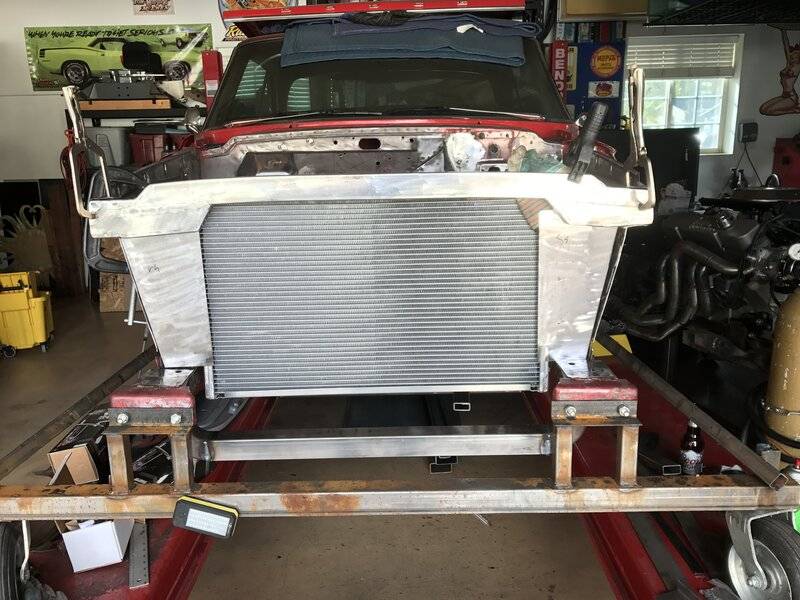

That is not a hard job. You will just have to replace the passenger side for your 26" conversion, AMD sells that piece. And then take good measurements before drilling the spot welds on your damaged parts. Maybe leave the hood on for reference gaps. Remember that the upper piece will have the important #'s stamped into it if you want to graft it to your new piece....
I made my own for my 65.
??? BOTH sides are different on my '69 !!!
Since the whole thing is damaged, carefully remove it as you're doing. The replacement unit comes with everything you're cutting off and it comes pre-welded except for the bottom crosspiece. Re-installing it is not a problem. Hopefully you took some measurements first !!
