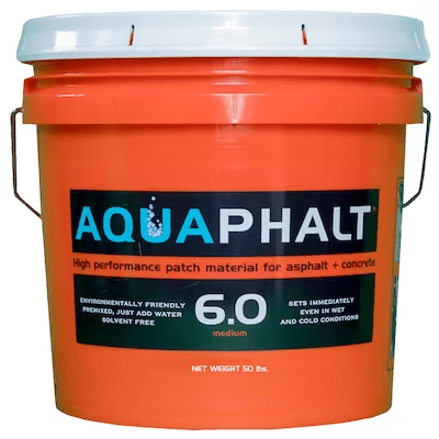

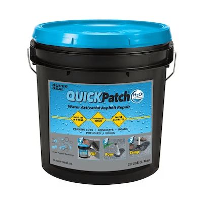

My driveway has some cracks and holes that need to be patched. I know that you can buy 5 gallon buckets of stuff to plug the holes so I'm leaning that way.

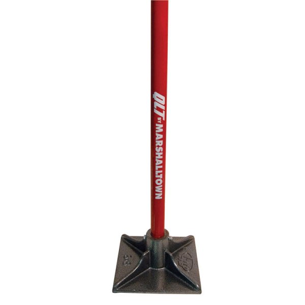

I've watched some videos. I figured that I'd buy a tamper. I have hand held propane and MAPP gas torches too.

Hopefully the propane torch you have is like the one I linked.. Cause if it's a little one like can be used for plumbing (though the Mapp torch is a much better choice) you'll grow old while waiting for the torch to do anything.... I use the bigger torch for burning weeds, lighting fires & I've used it on asphalt at my old house... Works pretty well... On the tamper, I have a friend with a gas powered tamper... It helps...

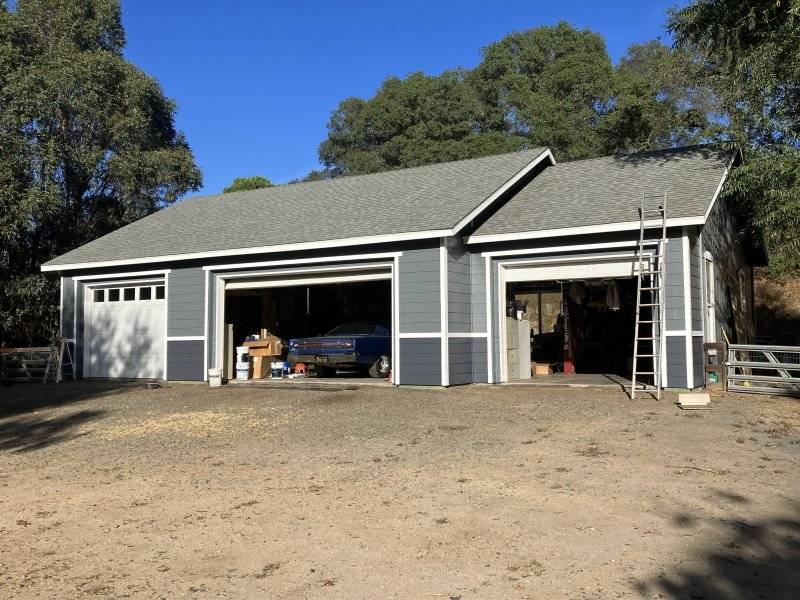

The realtor we talked with said the value here is the location and lot size...the house is almost inconsequential. He spoke of how some people buy properties and just level the old house and build some big mansion in it's place.
That is why I'm trying to at least make the place look decent and not neglected.
I'd be upset if the new owner tears down the shop...I built this thing in 2006!

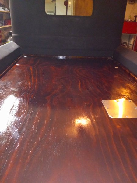

I love my Mapp torch!
I've even used it on my truck bed to
burn the wood grain.
I don't think I'd be tearing that down.
Might consider an asphalt driveway
at the same time by the new owner
as he's gonna be replacing your old
one. Nice work!
