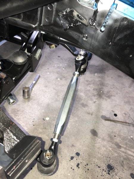

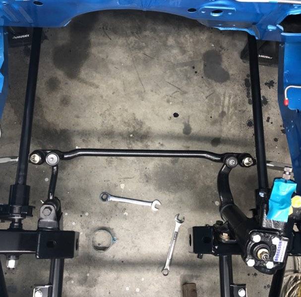

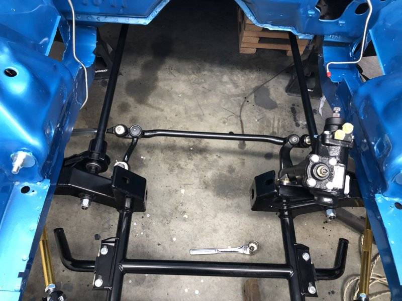

          Hi guys. I just wanted to chime in and at the same time see if you guys have any input. I just installed my borgeson box and have been having issues. If I “center” it by turning it all the way to the right and the back 1.75 turns per the instructions. My wheels are both going left. If I only go back 1.5 turns, my wheels point straight and both tie rod ends are the same length as well as the same length as my old tie rods. I’ve spoken with borgeson twice about this, today, they said run it and see how it is. I’m still out a year or two before I’m ready to drive it. Maybe it will be fine, maybe another box will come out by then. It’s just frustrating to spend almost $600 on a part and you can’t get it to work right per the instructions. They also said I changed a lot of parts since I have the qa1 suspension parts as well. I guess I can find a stock power steering box and see if that works to rule out if it’s my qa1 parts or the borgeson box. I don’t know if this is just to vent or inform people of the problems that I am having. I have sat in my engine bay and double checked everything I can and can’t seem to come up with a solution other that something is off with the box, the splines being off on the shaft or something off inside. I guess when I finally finish my car and take it out for a drive I will know. If it’s not right I will throw it in the trash and go another route.

          In the photos there's no steering column attached. Do you have a full QA1 front end? Lots of new aftermarket parts might make it act differently (as is often the case), and there's no real weight in the car with an empty engine bay.

          I agree that you should install a column and see how it lines up. Also, some have reported that the early Borgeson boxes needed to be shimmed between the K member mounting pad and the box to get the steering coupler to be straight. This will affect the amount of turns lock to lock.
          Also, in my case, my tires contact the frame rail before the steering column runs out of travel. I do run an 18 X 9" front wheel with a 275-40-18 though. Many people run a narrower tire so you may not touch the frame like I do.
