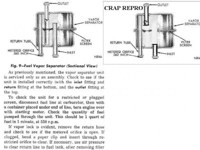

The problem with buying vapor separators is that some of the repros are junk and don't work right. I inherited one with my car and it didn't work as intended. After asking around, I found out it is a reproduction with a faulty design (just for OE look).
If you look in the FSM for 69-71 cars it shows the inside of the vapor separator. Its more than just a can with three holes. It has chambers that separate the vaporized fuel out and sends it back to the tank while liquid fuel goes to the carbs. Some repops just have a screen in them. You wont know unless you inspect it.
Buyer beware, basically. This is one item where going NOS or OE is worth it.
