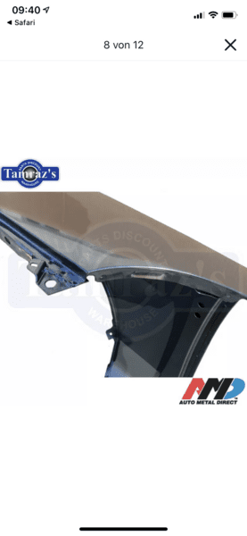

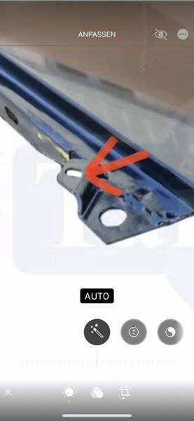

Anyone knows why AMD make this “ incorrect “ in his Fenders . In my experience original fenders have just a round hole in it where I can install the small rubber bumper

View attachment 1034754 View attachment 1034753 Anyone knows why AMD make this “ incorrect “ in his Fenders . In my experience original fenders have just a round hole in it where I can install the small rubber bumper
Weld up the hole and drill one to the correct size. If that's the only issue, it's not that much of a big deal. We were not involved in test fitting the second generation Charger sheetmetal, and there are some issues with the pieces. I can tell you for sure that the 70 Charger front valance pans are spot on,because I let them use my NOS front valance pan to template them from.
yes, this is exactly what I want to do ....
But I give my charger to a „ professionell Shop in Germany , they only work on Mopars and i was thinking when not here where then ..,,
But anyways , the shop don’t interesting in fix this small issue , they just let it long and put the rubber bumper in it and take it to the paint shop .
I just see it later when the car was painted and assembled again , because when I touch this small rubber bumper it was very „ lose“ and „ slide“ ( of course the long hole ) .
I take the rubber bumper out and see the unprofessional **** what the „ Professionell „ shop has done
