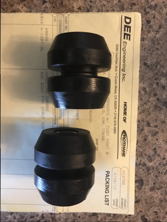

damn bushings drove me crazy, finally finished my front end up had a lot of issues with bushings not fitting properly. Somehow I got 2 sets of prothane strut rod bushing sent to me in the mail when I never ordered them, I ordered a front end kit from PST and had a set of moog strut rod bushings from oreillys then these show up on the mail a couple days ago? Matter a fact I'll create a thread and give them away, if anyone needs a set pm me.
