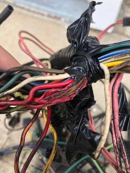

Over the last year I've had with the car, my ammeter would regularly dance like a pop star on angel dust and other electrical gremlins. I felt it was time to replace the wiring harnesses. I think I found one of the problems...

this is the pile after pulling it out. There were several spots like yours!

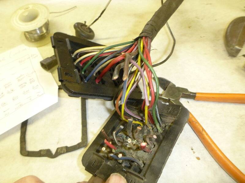

Inspected closely and put my dash harness back in to save $400.. replaced the over heated and timeX'd engine harness, but did take the time to replace the main bulkhead block and all it's connectors. I have more faith in the original OE copper and wire gauge than a reproduction unfortunately...

Inspected closely and put my dash harness back in to save $400.. replaced the over heated and timeX'd engine harness, but did take the time to replace the main bulkhead block and all it's connectors. I have more faith in the original OE copper and wire gauge than a reproduction unfortunately... View attachment 996332
I'm with you... to a point. I checked the gauge on my new M & H harness. It's legit. I also replaced the taillight/fuel gauge harness running under the driver's side sill plate yesterday. As I was coiling up the old one, "crack-crack" the brittle insulation just snapped. Sure, the wires could be 'fine' for another 10-15 years if you just leave it alone. Trouble is, in cars things shake, get hot, get cold, get humid, and get dry. I changed a burnt-out tail light bulb a few weeks ago and the jacket on one of the leads snapped. I had to wire-nut in a new bulb holder.
