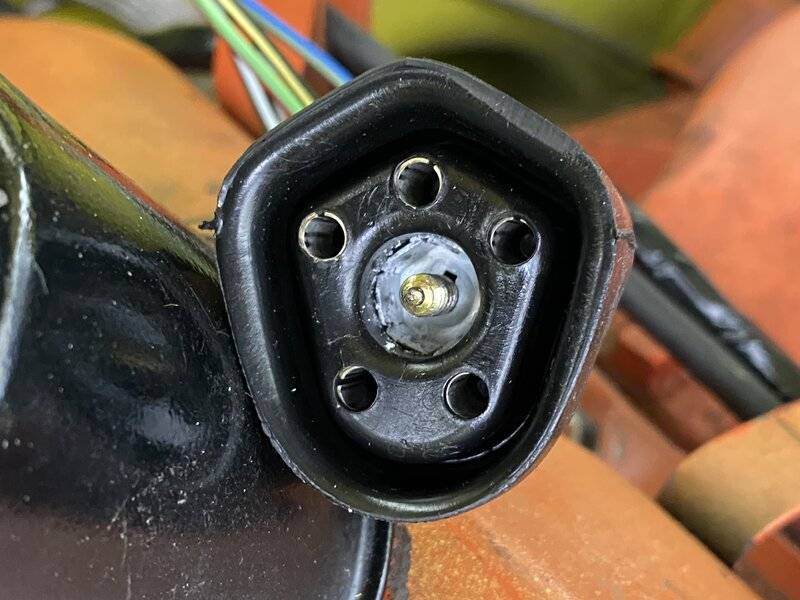

Next I am going to try removing the Ehrenberg ECU and installing the Made in China ECU that was previously on the car along with its ballast resistor. But first, I have to get that screw off the Ehrenberg ECU so I can unplug it from the harness.. That is going to be a bitch!!
The metal piece that is attached to the ECU box that the screw goes into separated from the ECU box and was just rotating around with the screw. The metal piece is STUCK inside my Evans wiring harness ECU connector! The connector on a $200+ wiring harness! So far I have not been able to get the screw out of it. Unbelievable.. He is definitely going to hear from me about this. I DID NOT over tighten that damn screw when I put it in there. I was never able to tighten the screw at all in his box.. I had ZERO problems with that screw in two other ECU boxes, before I screwed into his box..

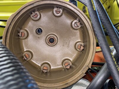

I have not checked the cap and rotor yet. I'll check those, but unfortunately will have to remove most of the plug wires from the cap. With the wires connected I cannot lift the cap high enough off the distributor to either look inside it or even see the rotor. Didn't have this problem with my 318 in the Challenger. Could raise it off and see everything with all wires in place.

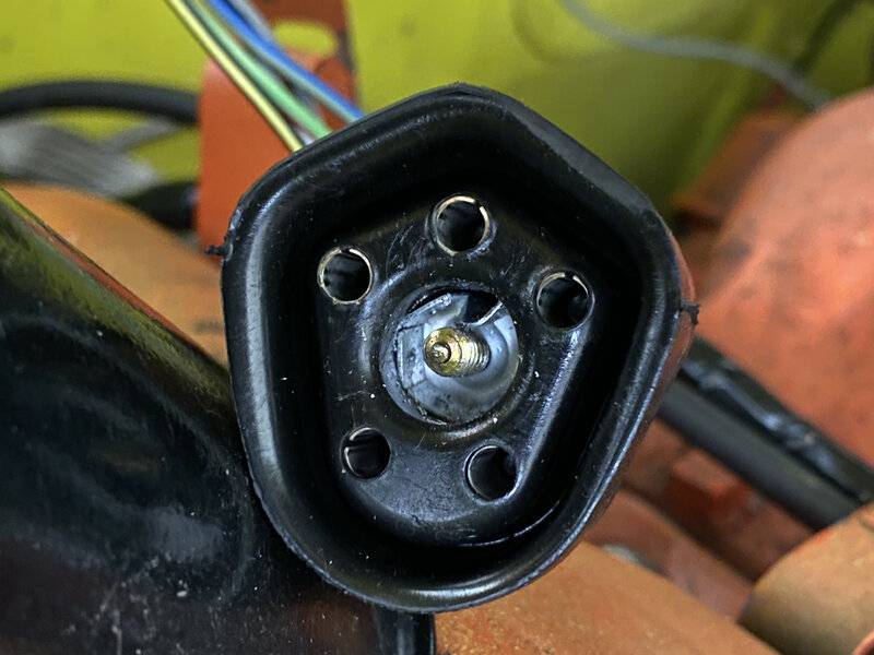

I finally managed to get needle nose on the acorn but as you can see turning the screw just bent up the acorn. The screw is locked onto the acorn. I’ll never put one of these screws into an ECU again after this nightmare.
I could cut the rubber off beneath the head of the screw to give enough room to get a hacksaw in there and cut the head off the screw with a hacksaw. So I can then drive the thing out with a punch. Unbeelievable!!
Trying to grab with the needle nose and rotate screw with a wrench. That just mangled the acorn even worse.. I have no other idea to get this piece of **** off other than to hacksaw it off and **** up my wiring harness in the process. I'm really pissed off with this Ehrenberg box!
Again I repeat this exact same screw had no problem screwing in and out of two other ECU boxes, neither one of which were from Ehrenberg.

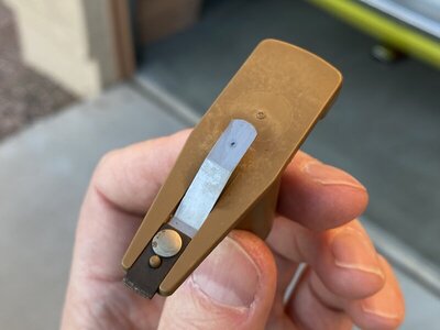

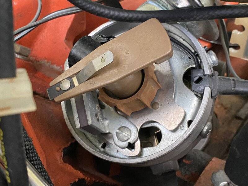

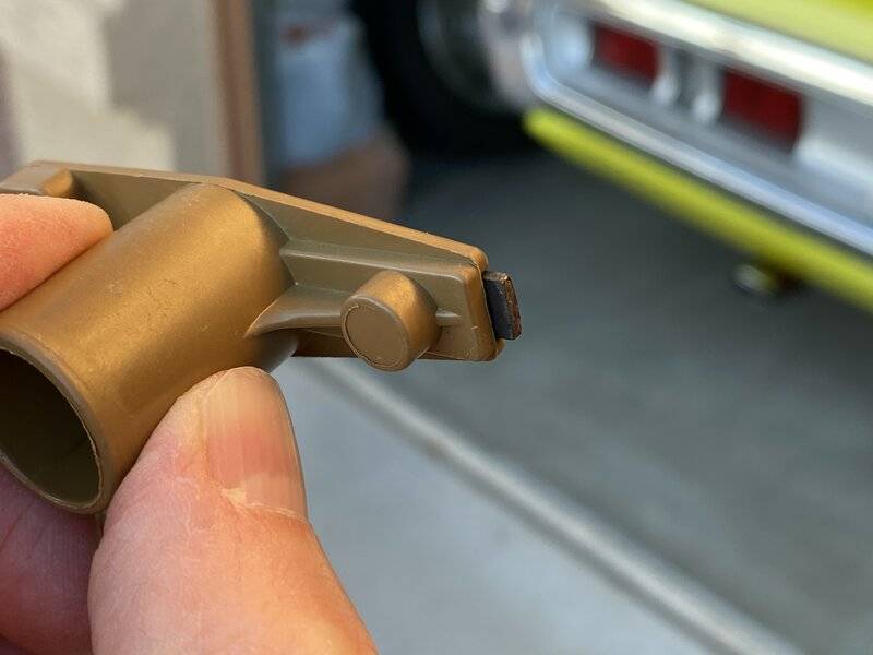

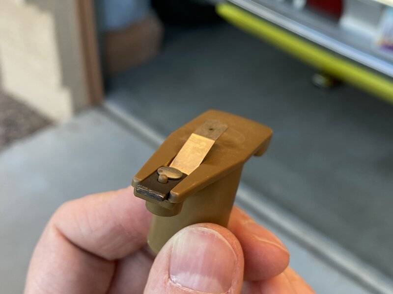

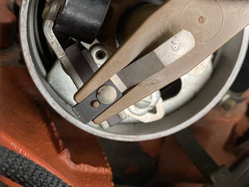

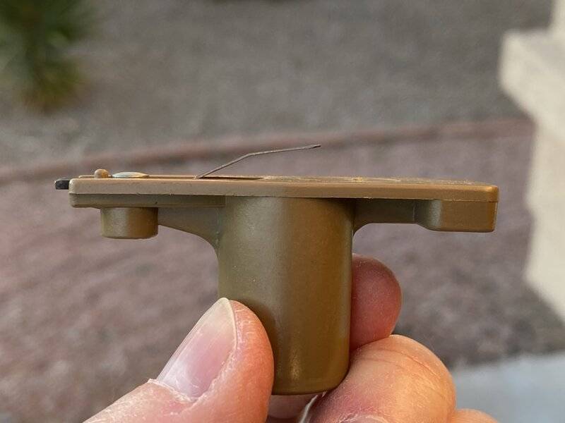

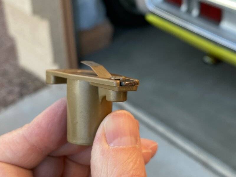

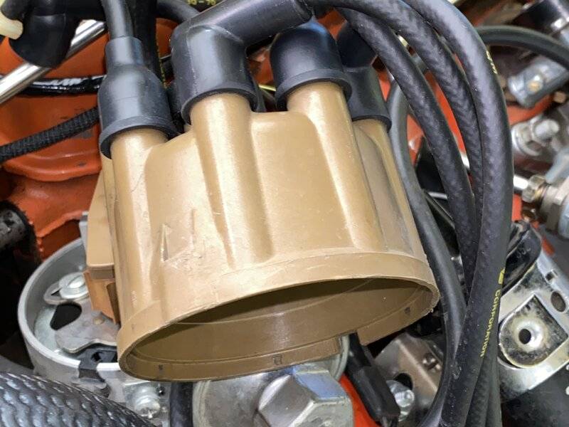

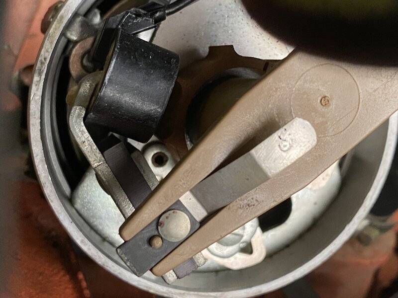

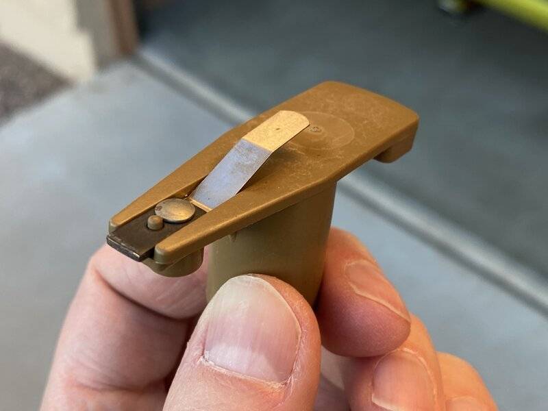

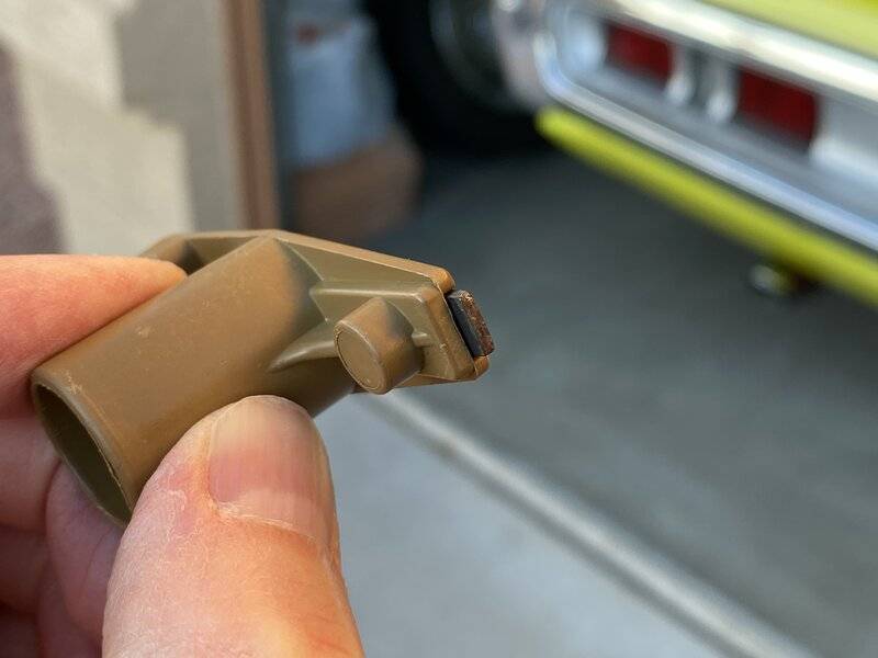

Cap and rotor look normal to me.. I was shocked to see that the cap was made in Canada, and not China.
I don’t see any cracks anywhere.
Does this cap and rotor not look normal to you guys?
6591D0B6-9087-4DBC-88A2-0324CE160EBC.jpeg 08F5B288-BDDF-4A53-850F-B04CFC454F32.jpeg DD6ADE6B-028E-4492-BD5F-805490BBDB50.jpeg 07264677-7B19-4470-8BAC-D7FEB31C5282.jpeg DC551580-675A-485B-B8CD-11C0DD25E201.jpeg

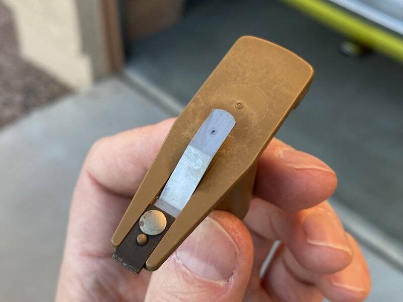

More photos of my rotor. I cleaned the center contact and the rotating tip with a cloth. They looked just slightly dirty. The photos are after the minor cleaning.
0B0DAEE1-3330-4CC6-9545-B9D7BEC0768D.jpeg 2123A893-4A9F-4FE4-8512-BF9769CF4658.jpeg 7E6B03DF-1A9B-4EB1-AC56-0D856DEDEE85.jpeg DFADCA5C-E557-4EBD-8D28-B169C2DBA971.jpeg A8069446-1FC1-4FC0-BD4F-F293BD413D40.jpeg 4559CF76-6483-45AE-8376-6E8DA9C5850E.jpeg 5B63DD26-D1E0-4E9C-91FD-228E9F2EFF53.jpeg
I don’t see anything abnormal with your cap and rotor
Your getting spark at your coil high tension wire correct
But nothing off your spark plug wire ? You sure it was grounded properly to provide a path

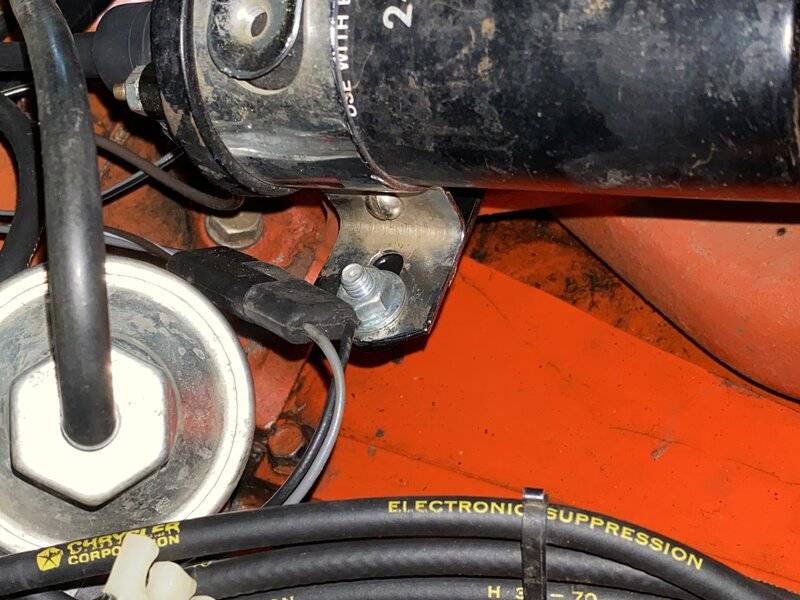

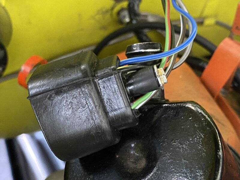

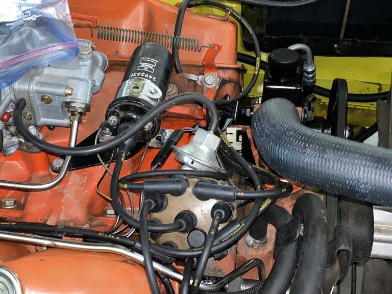

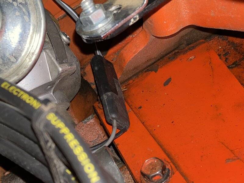

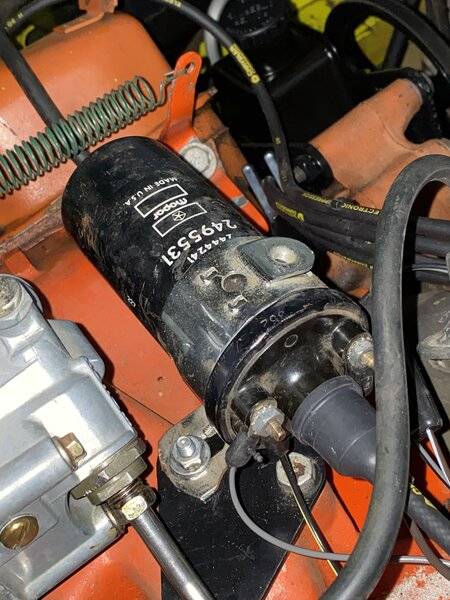

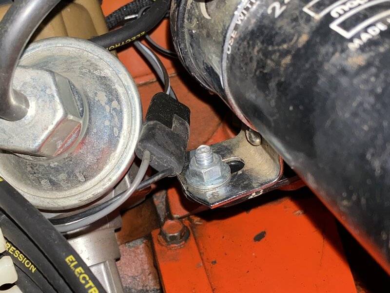

Photos of the distributor and coil. The two wire connector the goes from the engine harness to the distributor was laying on the intake manifold and orange plate beneath it when I got the car (I included a photo of where it used to be). I moved it so it is resting on the coil mount bracket. I thought this would be a better place to put it hoping it would be exposed to less heat while resting on the coil bracket. Where is this connector normally supposed to be placed?

I don’t know to laugh or cry
Don’t cut anything , I don’t want you ruining your harness
A needle nose vice grips will now solve your issue , hopefully breaking the nut/splitting up to the screw as your turning it out

Well that explains that , glad I mentioned that earlier after looking at your cap and rotor
Chances are you will now have spark at your plugs
