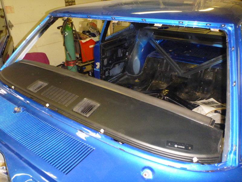

FYI, Chrysler only did the bottom and up the sides a few inches as shown in my first picture with the 8509 in place.

Nope.. I just noted that as to what was OE back in the day. You'll see I went all the way around on mine.

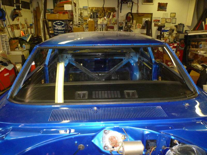

I put my new gasket in place dry, weighted / taped where necessary for about 3 days to let it get it's correct shape. Then as you can see in my pictures on page 2 only pulled back just enough to put the bedding compound down a section at a time and then installed the windshield right away. Hasn't leaked a drop.. but of course the car hasn't left the shop!! :canada:
