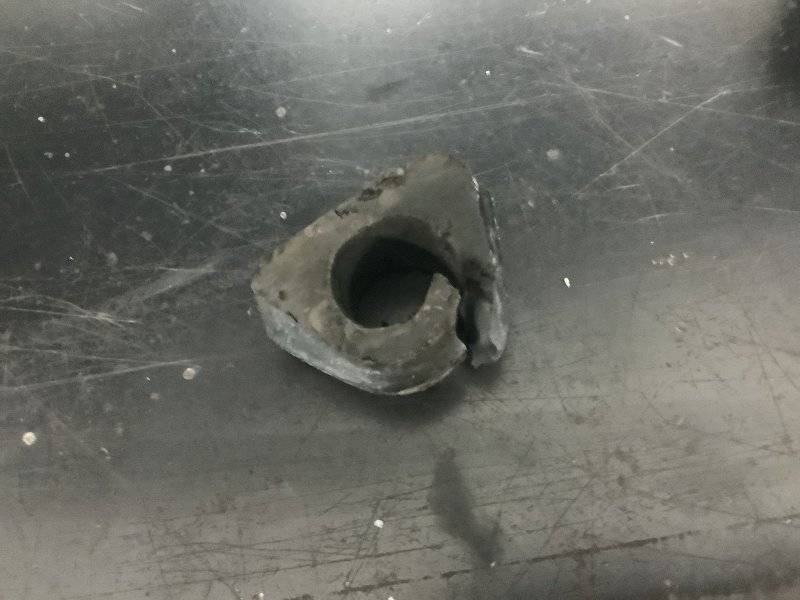

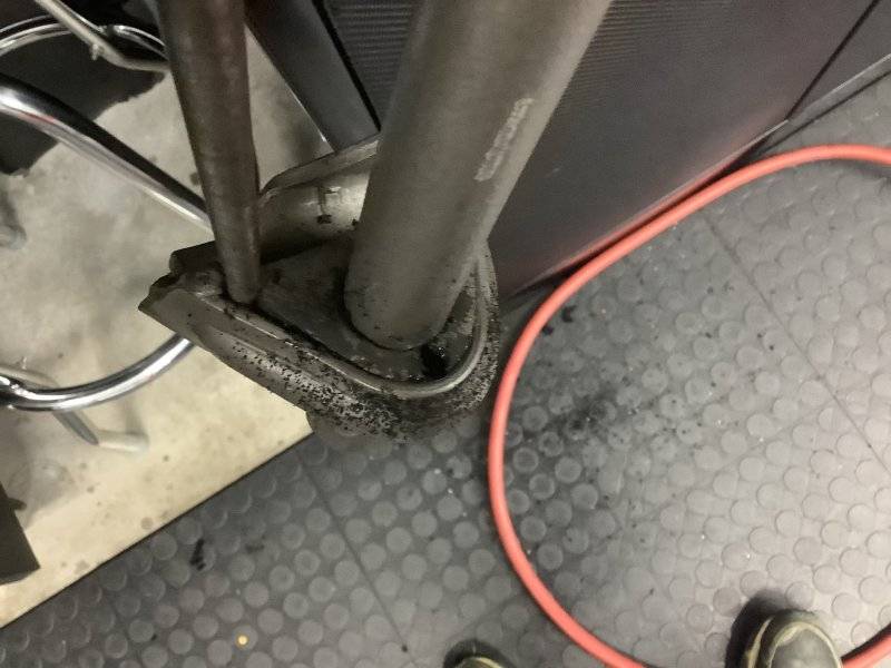

I had to work until 3 today, but I’ll still get a few hours in before dinner. I got the strut rods and sway bar off the K frame, the only front suspension pieces left on the car are the upper control arms. They can stay in place until the engine comes out. I just finished replacing the factory sway bar bushings with Energy Suspension poly bushings. After struggling for a while, I drilled through the bushing and pried it out using the resulting hole. Sliding it to the end where the sway bar tapers down gave plenty of room for it to slide out. I reversed the process to install the new ones and squeezed them with channel locks. It was way easier than I anticipated. After a little cleanup, the sway bar will be painted gloss black…

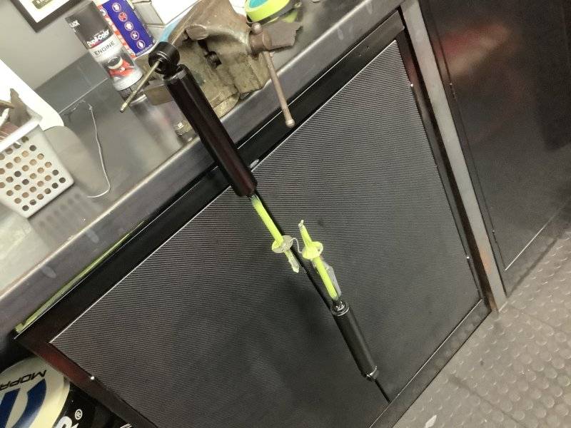

Got the sway bar, shocks and t-bars painted. I also cleaned and painted the lower ball joints, but the matte nickel dried a lot lighter than the color on the cap. I’ll have to find some cast blast and give them another coat.
