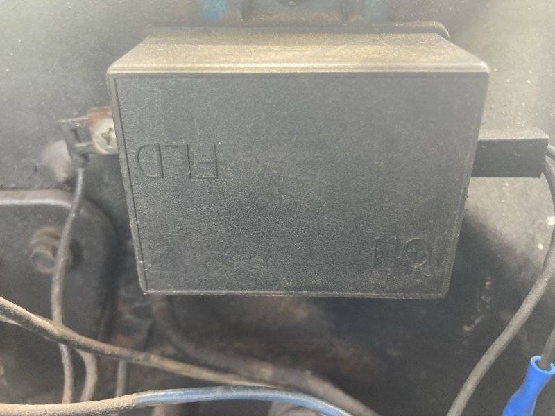

I have this MSD distributor on my 440, as I am told by other people it is wrong and a Chevy style.
It was put on by a shade tree shop that was paid by the previous owner. The car seems to run fine, but in comparison to other peoples car my wiring seems wrong.
I’m also incredibly dumb about wiring and ignition systems and something I'm still trying to learn.
The distributor had a single red hot wiring coming from the 12v regulator on the firewall in the 2nd photo on the Ignition side. I believe its wiseco brand? It receives power from wiring harness on FLD side? I dont know what FLD means.
Every other MSD setup ive seen was a regulator to a coil to the distributor. Is this wired wrong, wrong system, or is this something I don’t understand?

It is wired correctly. An HEI ignition has the coil built in to the top of the cap and the only wiring required is 12 volt feed.

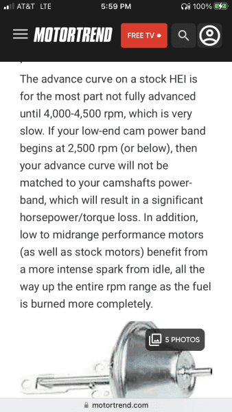

Also just read this bit of info. Guess this could also be what causes my car to be a turd off idle take off?

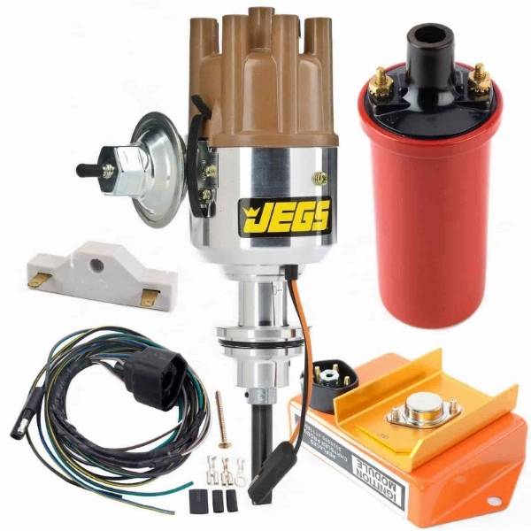

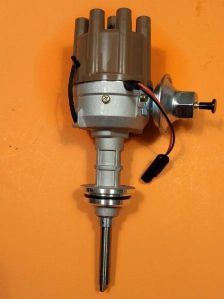

This is an electronic ignition distributor for a 440
This is a Factory style ECU kit. This is more modern than what your car would have came with. But, Its closer to stock looking. Coil would have been black or blue.. Not really sure as it was before my time. The Distributor above looks more like the original style, the one below is some fancy billet style.
The distributor you show is for an LA engine, as it turns in the opposite rotation from an B/RB engine. It looks like a Chinese ECU and maybe the coil as well......the ballast resistor is of unknown resistance and is of the closed back design, subject to early failure particularly if not matched to the coil and ECU. Call Ray @HALLIFAXHOPS to get you the correct components......fancy appearing gizmos do not necessarily work any better.......

I was just giving him examples of what the stock stuff looked like. I know its not exactly but its closer to stock look than a Chevy HEI... I agree on the China made ECU too they are junk.
You have an excellent ign system with THAT dist. It is the GM HEI design. No need to change it.....ignorance abounds!
Consider these FACTS:
- the Chrys elec ign system limits plug gaps to 0.035". GM specified 0.060" plug gaps for the HEI, & 0.080" for some engines. That is because the HEI produces more spark energy.
- GM HEI dists are now made for all popular non-GM engines. You will not find Chrys ign systems being made for non-Chrys engines. Why is that?
- the HEI is a one wire hook up [ two wires if you have a tach ]. Much simpler, less external connections that come loose/corrode than the Ch system.
- the centri adv mech is in the top of the HEI, very easy access to adjust/modify.
Your dist has an adj vac adv unit. A very desirable feature.
