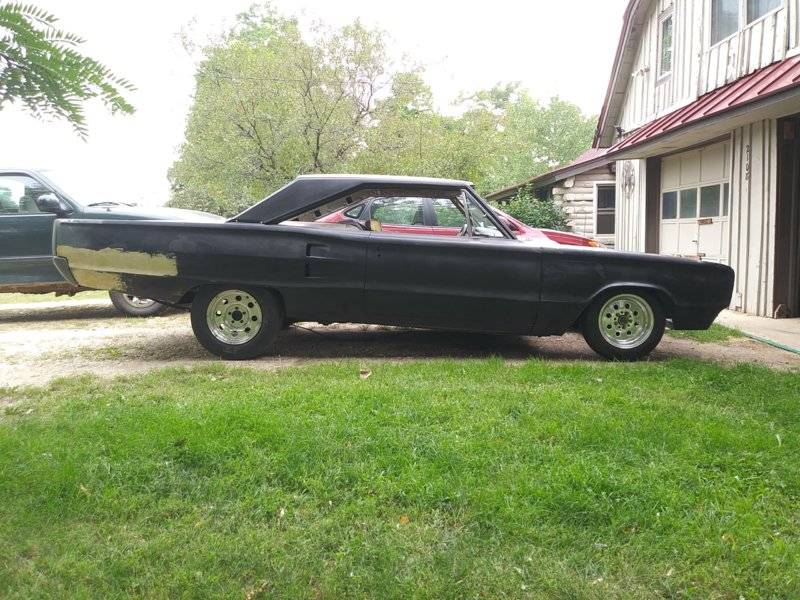

I dont know what kind of filler youre using but Im using the Evercoat Premium...sands extremely easy....maybe too easy...started on my second gallon and have only done the rear qrts...
In this heat thr biggest pain has been the work time... Ive been weighing my mixture which is 2% and even cutting back to 1.5 you have about 3 minutes of work time before it sets. Definitley would like a little more time as im not a proficient mud slinger....

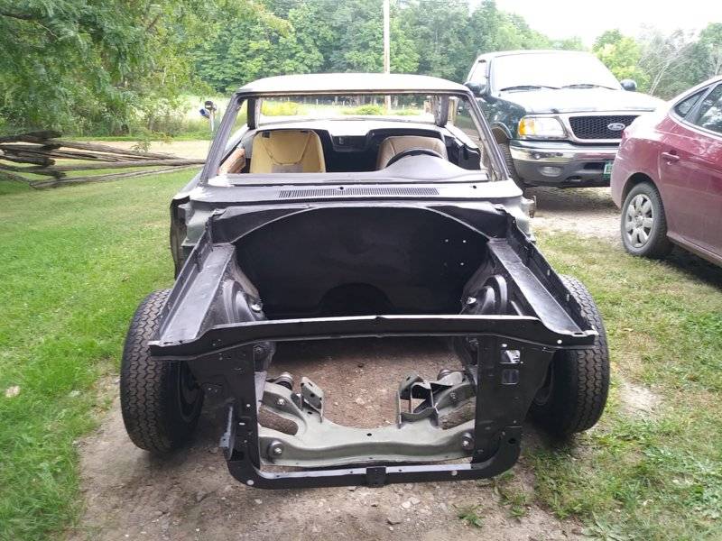

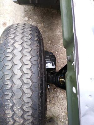

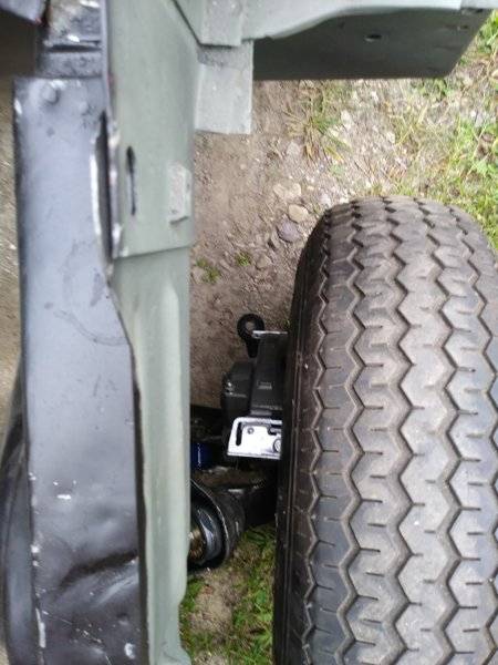

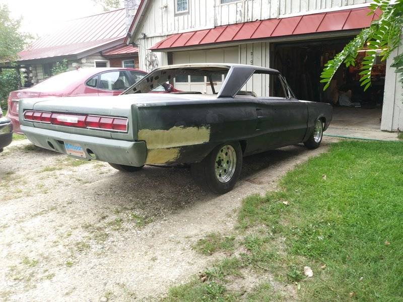

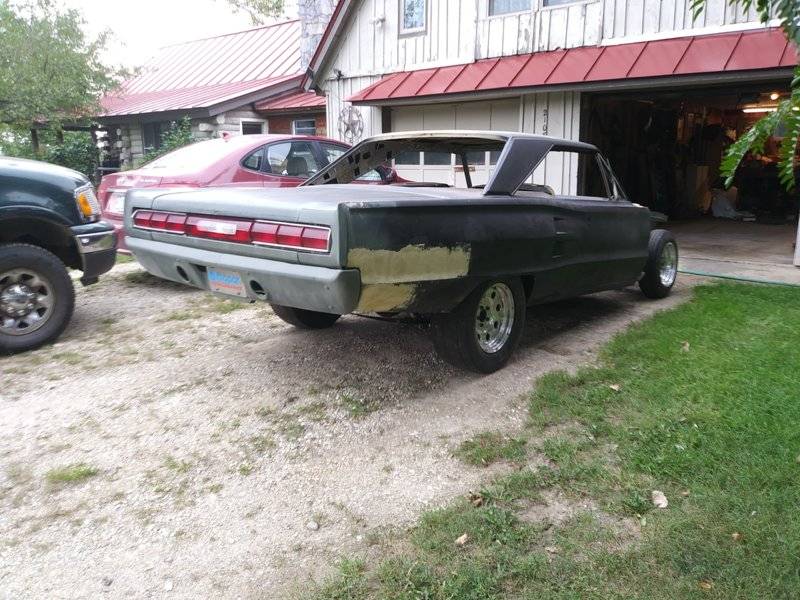

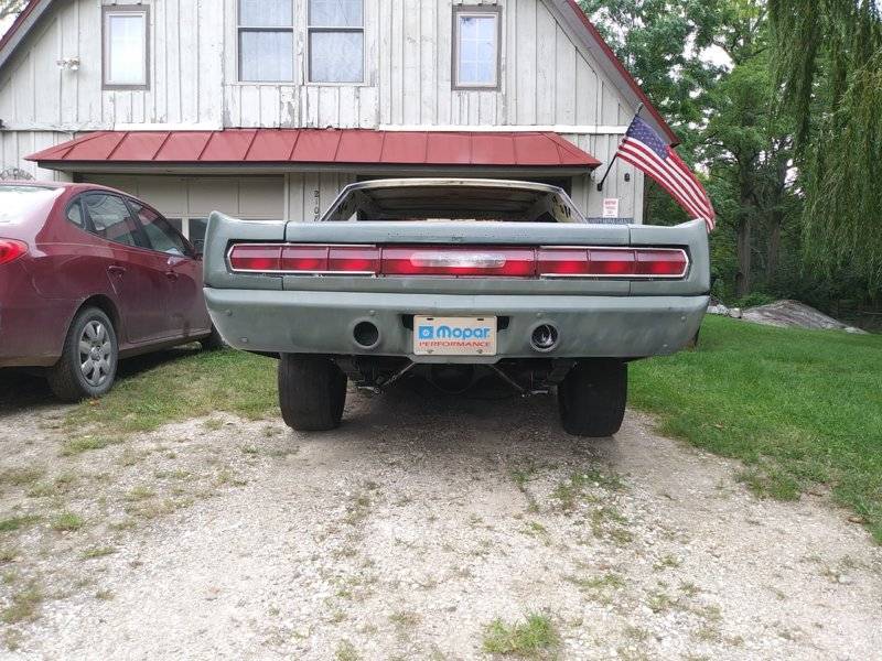

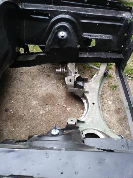

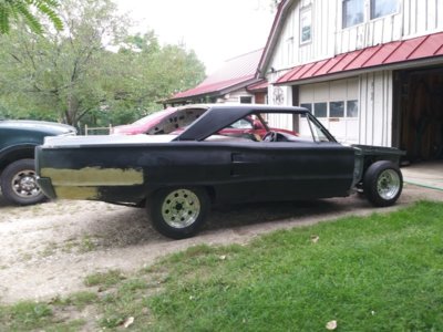

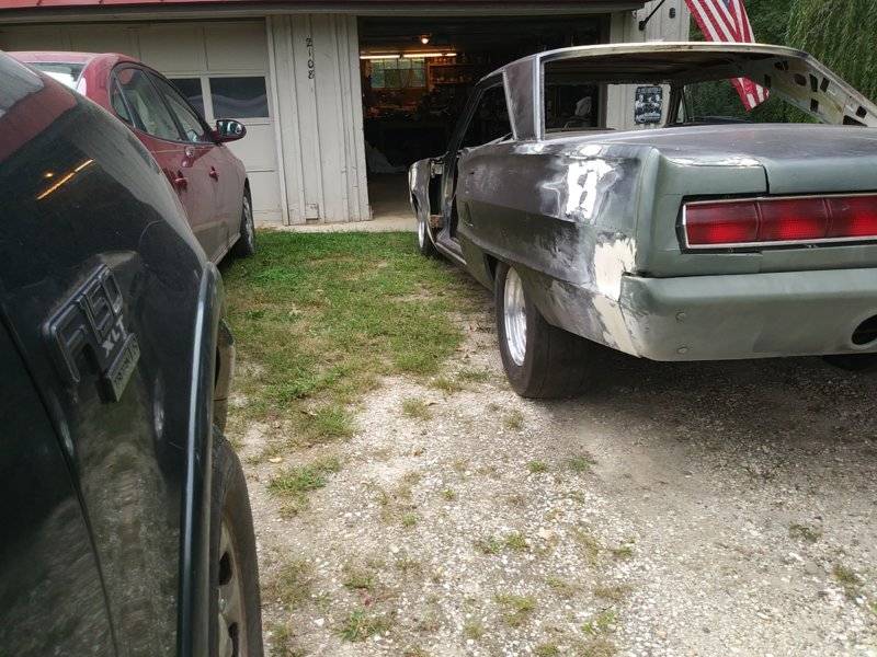

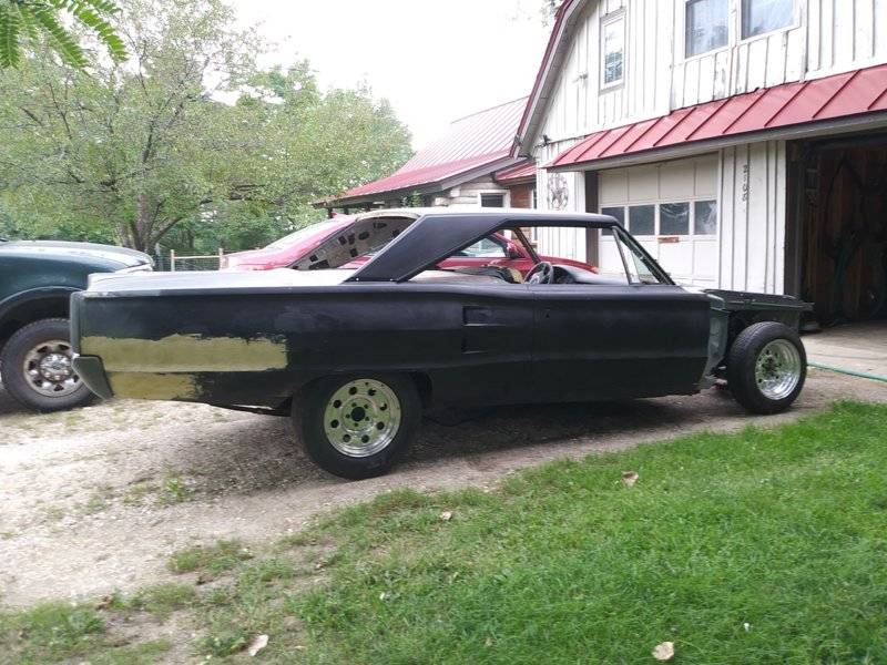

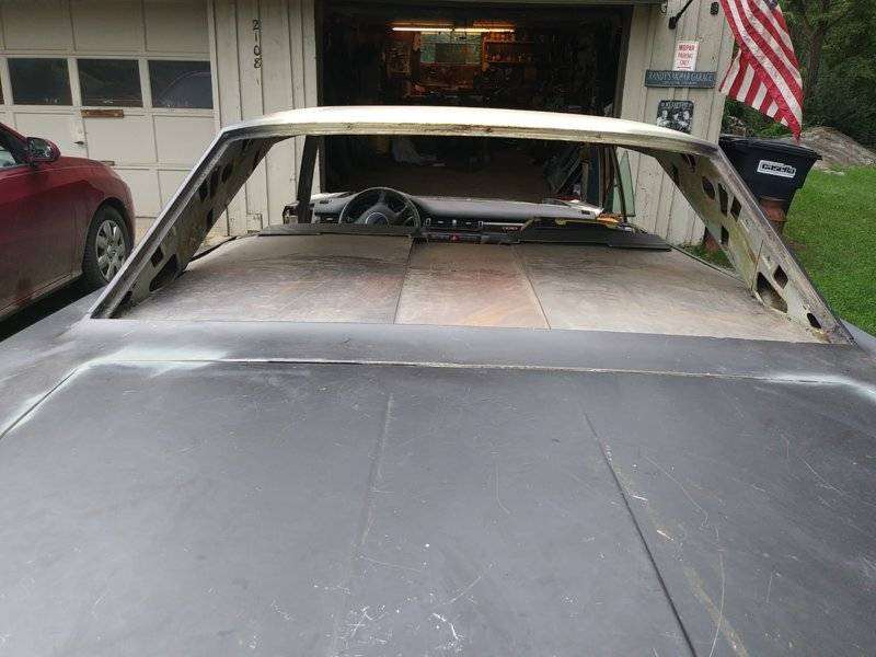

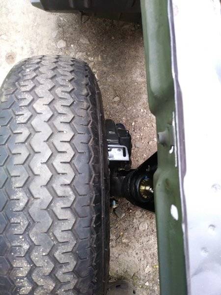

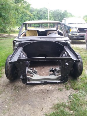

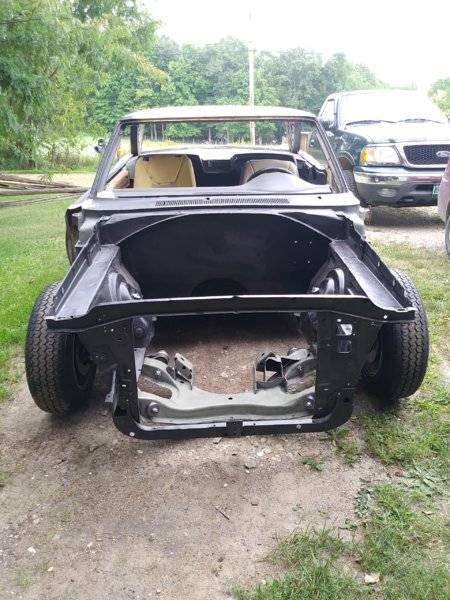

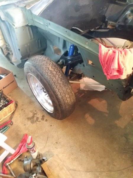

Express update.
Milestone reached today. Backed the car out onto the driveway for the first time since October of 2014. Will hook up the steering linkage tomorrow. And put the torsion bars in so the front will rise up to ride height.
