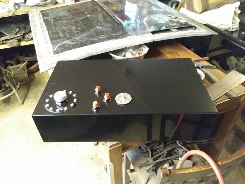

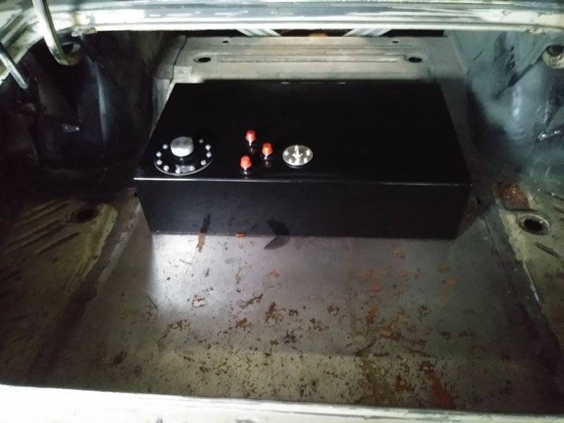

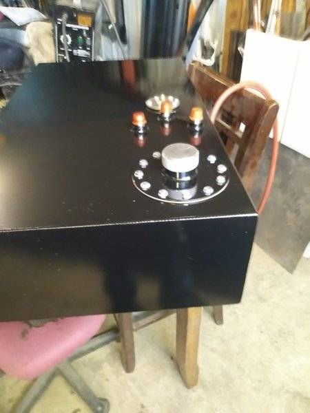

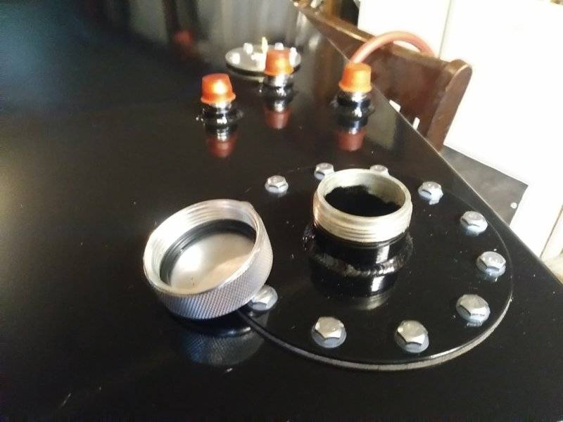

or see post #597...Pic of fuel tank, I don’t see it.

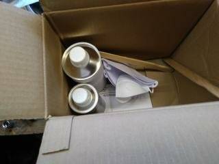

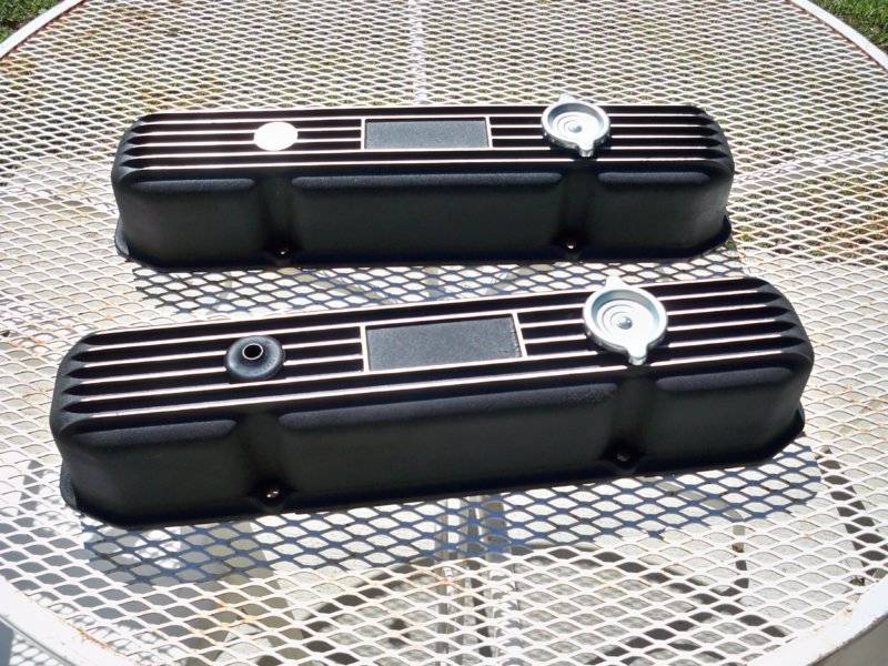

I like that color Ghost,Bought steering joint, paint, window felts and hinges, valve covers.

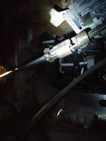

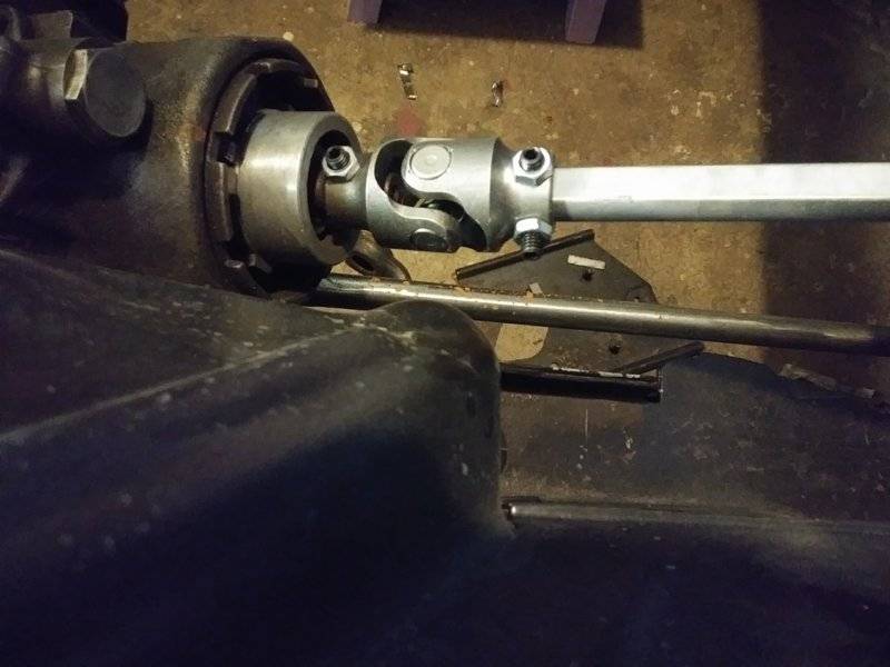

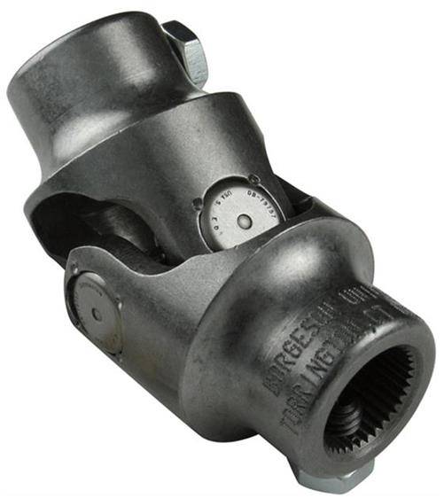

Borgeson 5/8 x 36 spline Chrysler x 3/4 DD

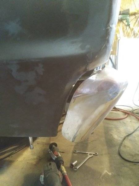

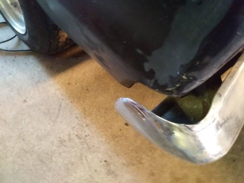

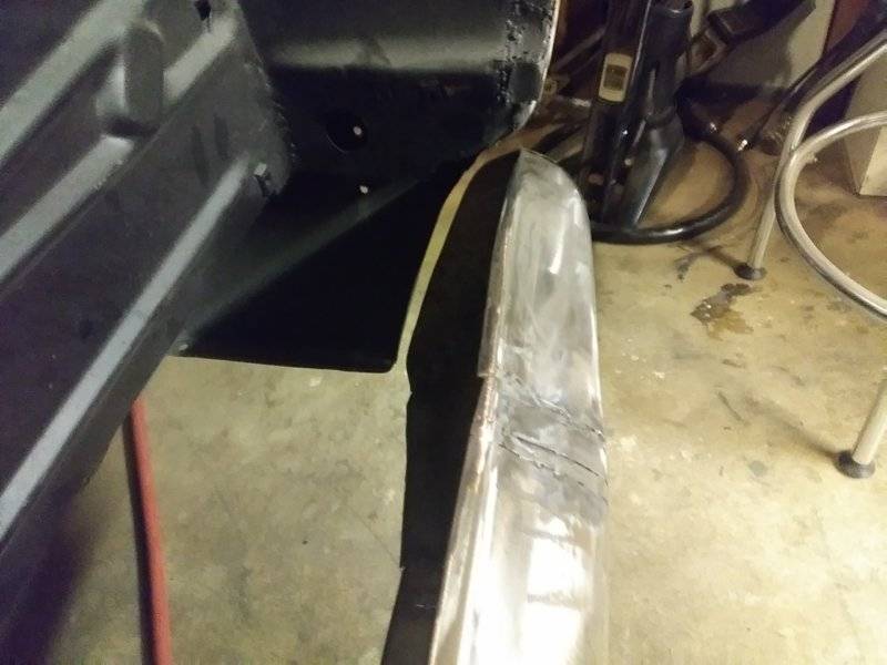

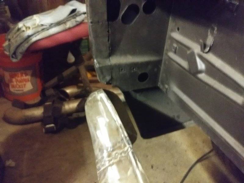

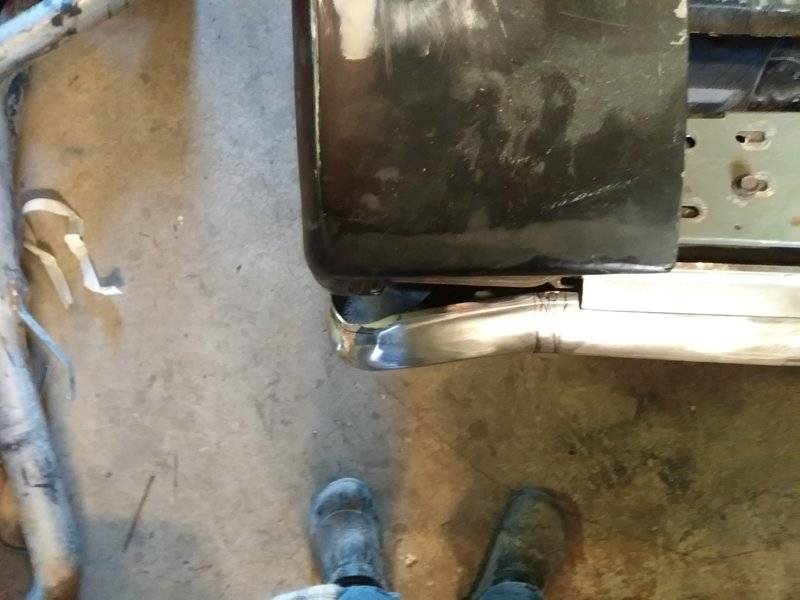

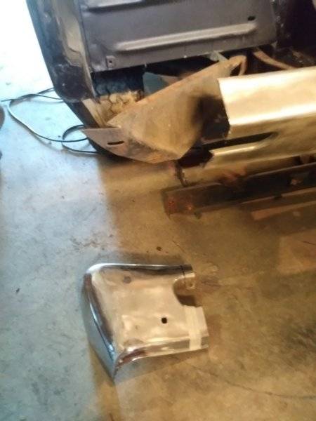

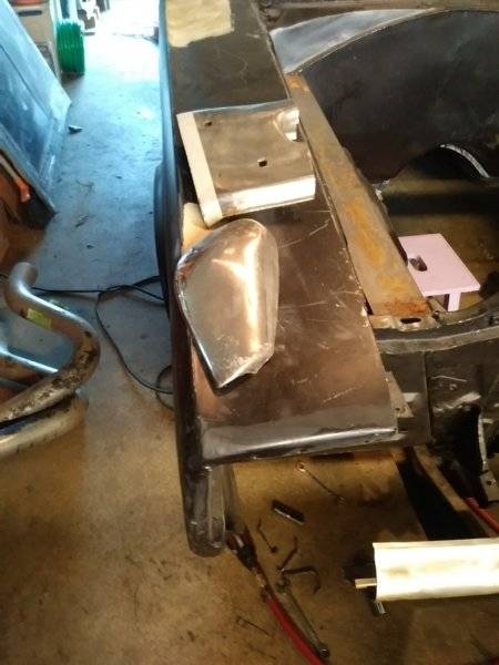

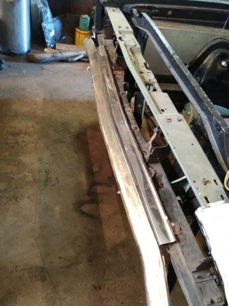

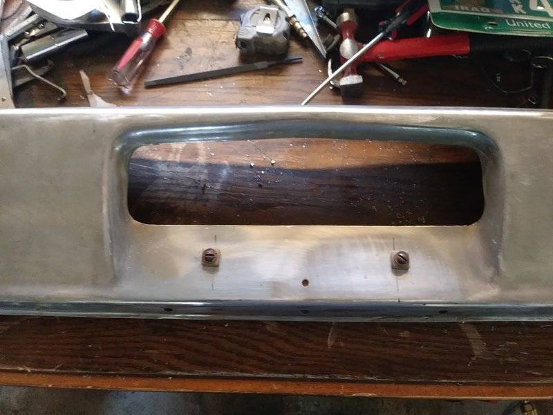

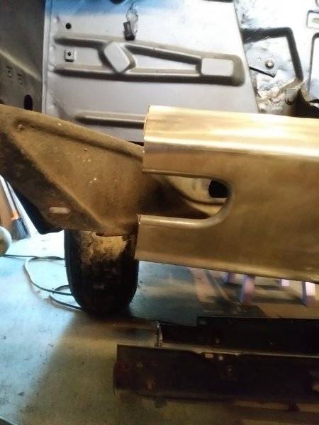

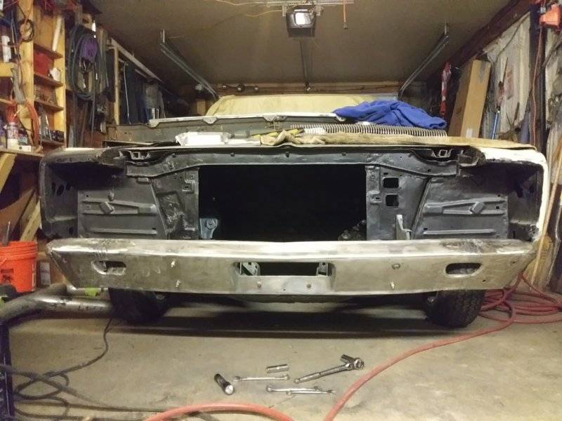

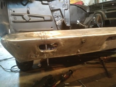

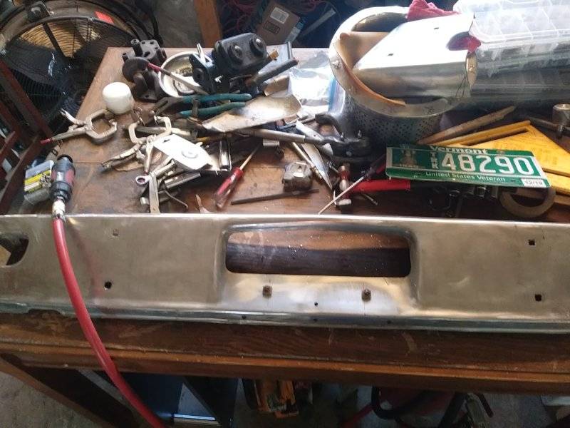

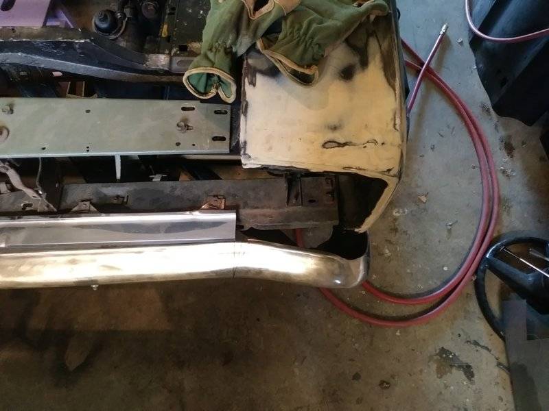

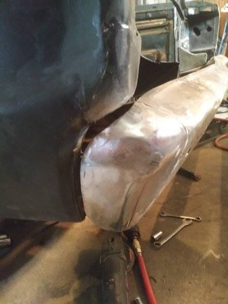

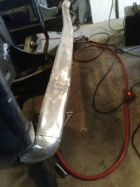

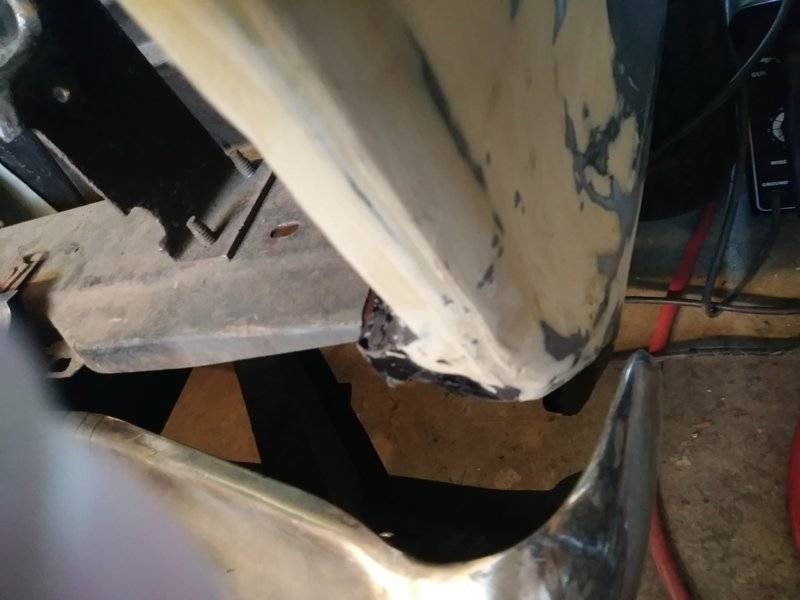

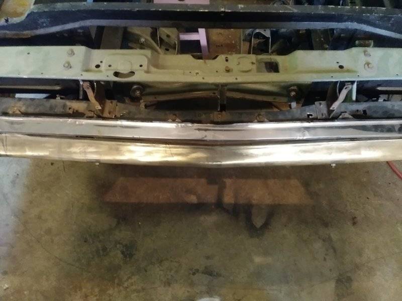

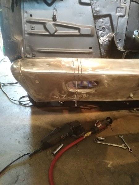

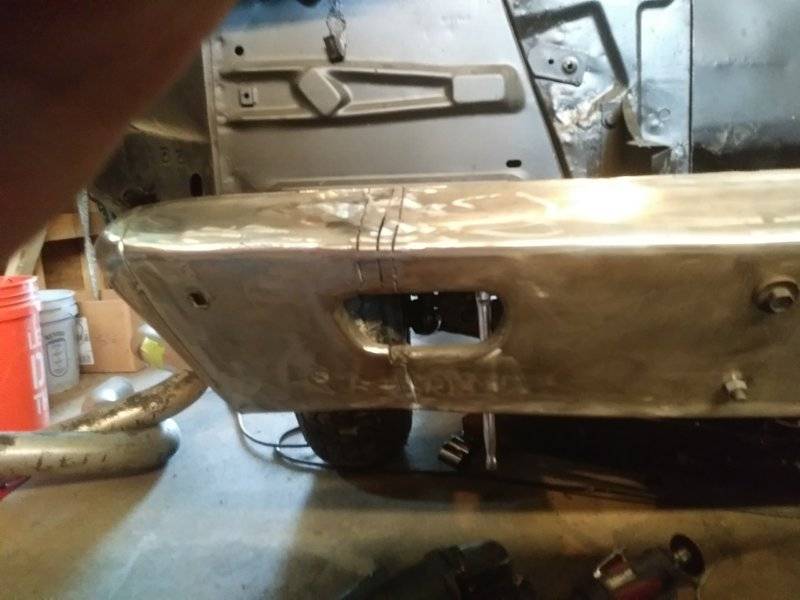

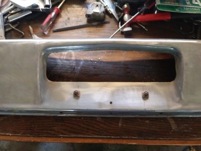

must have been one heck of a lunch!!!!Forgot to post after lunch because I fell asleep. lol. So, here they are. I cut out about an inch on either end and worked the edges to tilt to the rear the end piece. If you look closely you will see the turn signal light holes are shorter. The bumper ends now set just inside of the fender face and the end profiles will be finessed to match exactly the fender curves when completed. I Need to hunt down the fender support rods for each side and put them on before I go any further with that. I also need to weld in the plates to delete the turn signals.View attachment 685142 View attachment 685143 View attachment 685144
