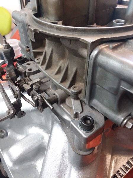

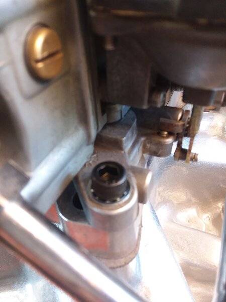

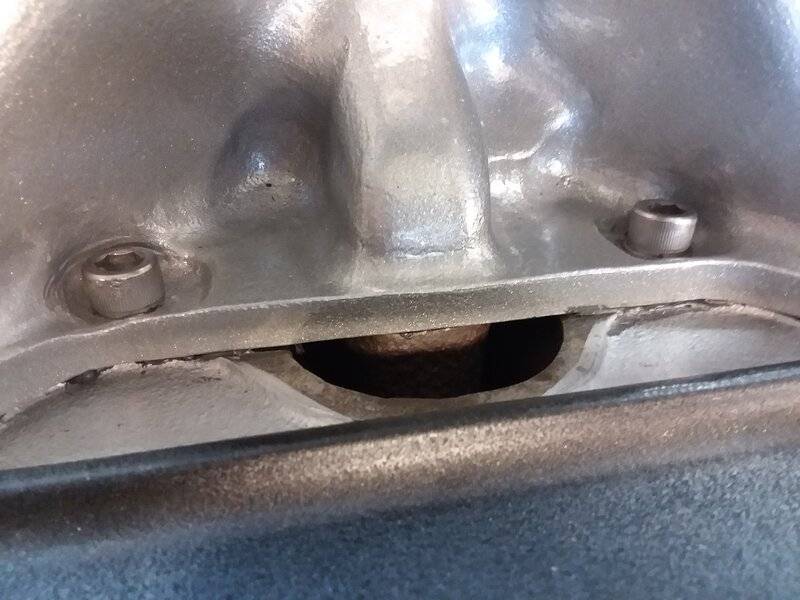

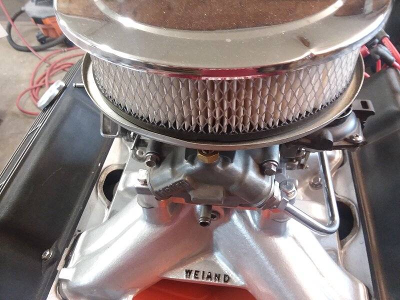

I wouldn't worry about it. But, if the center of the gasket is not doing anything, cut it out with a box cutter. If you didn't and it is installed, I wouldn't worry about it. I think there is essentially ZERO chance it gets sucked in to the intake.Worried about the carb base gasket that has the four big holes, one for each barrel, being above the 1" spacer plate wont the engine suck that gasket into the intake? Nothing supporting the center of that gasket. Hmmm....advice please....
Well, it's a single plane intake so no supporting structure in the middle under the carb.I wouldn't worry about it. But, if the center of the gasket is not doing anything, cut it out with a box cutter. If you didn't and it is installed, I wouldn't worry about it. I think there is essentially ZERO chance it gets sucked in to the intake.
I get it. But I don't think it can get sucked into the manifold.Well, it's a single plane intake so no supporting structure in the middle under the carb.
I think i will do that before i hook everything up. Might pop by the hardware store too and pick up four fancy bolts to hold the carb down'I get it. But I don't think it can get sucked into the manifold.
If you prefer, unbolt the carb and cut it out, since the center part of the carb gasket is doing nothing...
