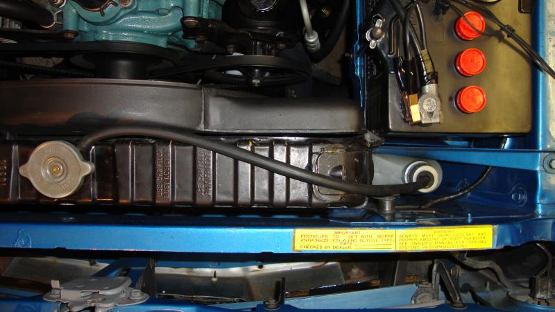

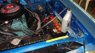

I changed out the rad to a freshly re-cored 3-core rad, a 7-blade fan, regular green coolant-50/50, and a bit of water-wetter. she runs at 195 in the worst traffic and at 175 cruisin at 65. I abide by the K.I.S.S. theory...Keep It Simple Stupid. :yes:
edit:
i almost forgot...i added this home-made overflow bottle too :toothy12:
