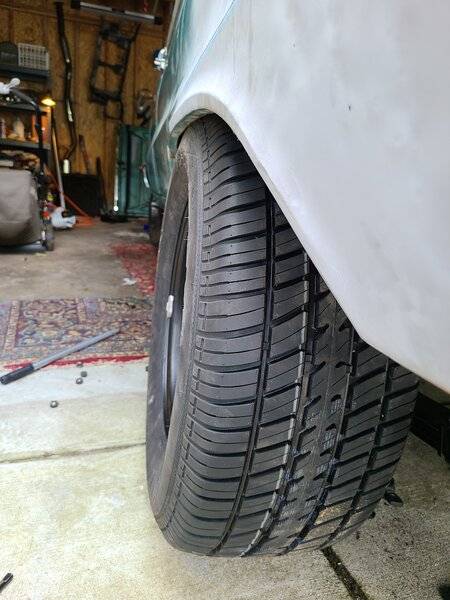

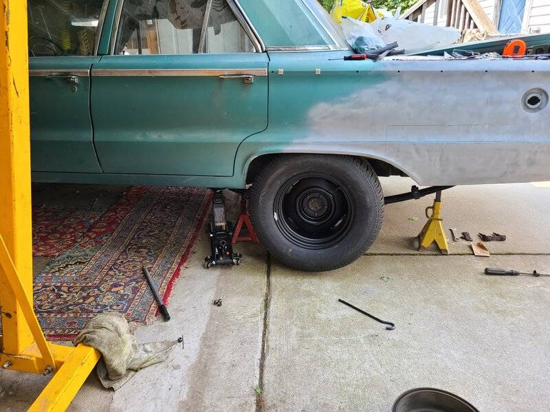

Well, I pretty well screwed myself again. Measured, (or thought I did) rear wheel openings on the Belvedere II with the intent of putting 270/60-15's under there. Bought 15x8, 5x4.5, 4.5" bs steel wheels and thought I was rolling.
NOPE. I was a little off with my measurement. 1/4" off? NOPE. Off by a full inch, maybe more.

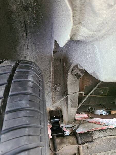

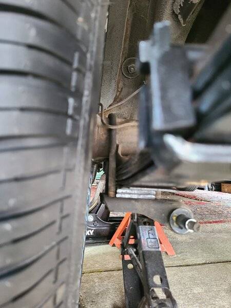

I guess I should have figured it out when I had to unbolt the leaf springs at the rear and drop the axle to even get it close to getting the wheel in there. Then once I got the wheel on, I had a full 1.5" from the inside of the tire to the leaf spring.
Damn. Rubbing HARD on the inner lip of the wheel well too. You can easily see it in the pics.
One more inch of BS will put me 1/2" off the leaf spring, and looks like it will get me inside the wheelwell.
Question is, has anyone had to go 5-1/2" on the BS? Is 1/2" enough clearance from the spring? Everyone I talked to, and everything I read says 4-1/2" was the magic number...but apparently not for this car. Well, look for a couple brand new steel wheels to show up in the "for sale" section....

Looking at your pictures it sure seems like no matter the backspacing your going to have trouble, looks like it's going to be rubbing on both sides or damn near even with perfect backspacing. What's the overall width of the tire vs wheel opening including the sidewall pucker? Backspacing is one of the easiest things to measure so don't ask people just get under there and measure.

I'm guessing someone changed to a later model 8 3/4 (took out a 7 1/4 maybe?). Do some research and measurements. The wheel you have should work. Im betting your rear is wider by a couple inches.

1/2" away from the spring is fine. You can go to a 1/4" but I prefer a little more room than that. It looks to me that you might end up with inner fender clearance problems getting that close though. Sorry, I have never owned a 67 B, so I cannot help with specific examples.

This is exactly why i think he's got a non-stock rearend in it. Yours is a quarter inch different than his, yet his wheel is two inches from the spring!
