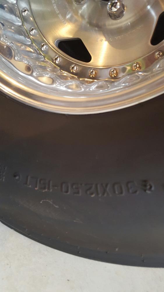

I think I have 9" Centrelines on my 77. I'm not a fan of the big fat MT's on the back and will be swapping them out for shorter and a bit narrower tire in the spring. But they do fit.

Thanks guys. How much do they bulge out the quarters on that 77. Man if those were just a touch shorter I would make an offer on them...I like the stance, but the rear appears a tad tall. 30? 29?

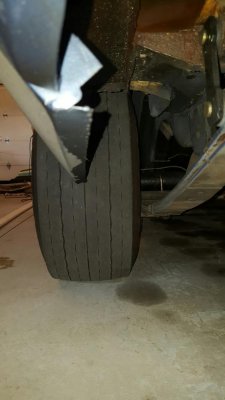

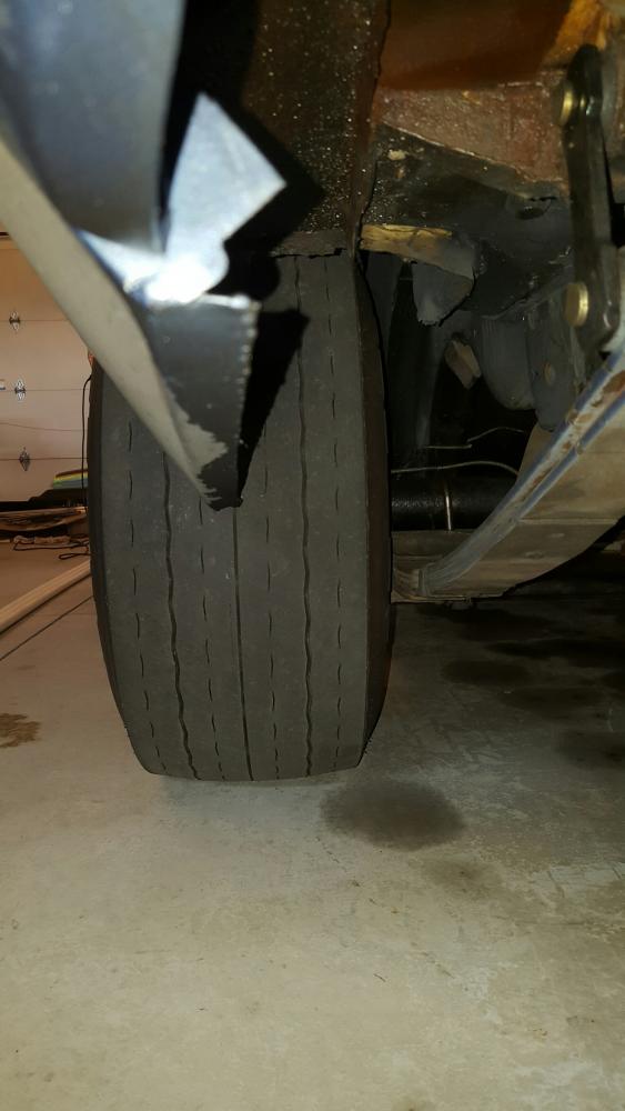

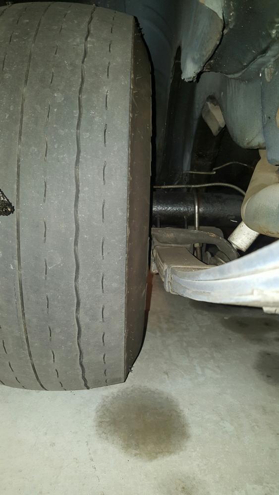

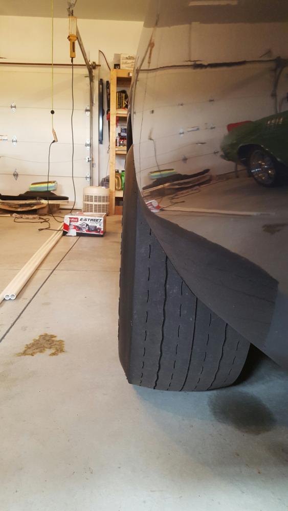

As you see by the photos below, the tire bulges just a bit. The tread width is ok but the section width is not. I have to do some more homework on what size to change them to. I don't want to buy another set of tires I'm not happy with!

Thank you. It honestly looks like it would be perfect if u just put a 28 or 29 on it...30 is tall. Am I reading that right? A 12.5 in a stock wheel well? Wow

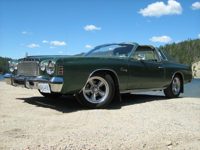

17X8 running 235/60/17 this size kept the overall diameter the same as the original 15" setup. No buggering up my speedo that way and also the front tires clear perfectly when turning as the torsion bars were turned down a bit so keeping the same overall diameter made for a decent look with no problems just get in and drive. That said for my tastes I would like a slightly smaller sidewall so as I work on this car over the next couple years I am stepping up to 18" for this car and these 17" will get a shorter tire and migrate over to my M-body LeBaron.

I'd love to see more pics of your side exhaust. Under car layout and a couple side view shots that show how low it hangs. What size exhaust? Thats a great idea. I need to redo my exhaust from the mufflers back.
i will probably go with a set of weld pro start knockoffs. The name of the build is low budget on this one! hard to beat a wheel that looks like a $200 weld that you can snag for $90...
You mates with your cordobas look nice! but my monaco (soon to get a 75 RR header panel) doesn't look quite as classy. I think it will look a little better with a simple "race star" style wheel, than some 17 inch American racing or cragars. they do look good on the cordobas though! thank you all for the info.
Running 3" exhaust with X-pipe with mini turbo mufflers (7") length Its loud but sounds great Plan on changing to a longer 3 inch walker muffler. When I have time I will send photos
