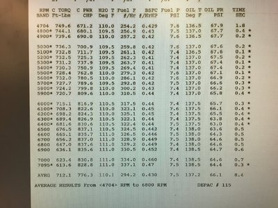

Well I'm all smiles. Should make Barney move!
Here are the details I'll share. The rest are my secret
400 block 4.25 stroke. 13.5-1 CR. Indy EZ-1 heads that flow just under 370 @.700. Solid roller cam with #'s I'll keep to myself. Indy single plane with an AED 1050 Dominator. TTI 2 1/8 step headers. Also have a vac pump setup. It should be fun!!
Couldn't quite hit the Demon advertised HP. 3 HP shy. :D

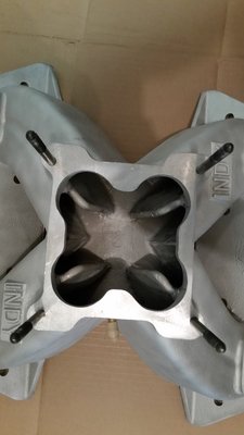

Believe it or not that cloverleaf Indy Manifold worked better without the spacer than with. Tried 2" then 1" then none. Kept making more power which is opposite logic.
But last year I found that at the track too. With spacer I lost a tenth and a half and 3 MPH. Took it out and jumped right back up.

Believe it or not but because of the Indy Manifold cloverleaf design it made more power with the carb right on the Manifold vs a 2" or 1" spacer.
