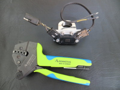

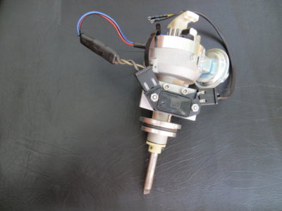

Tired of my ignition problems on my 1971 Charger, I decided to make my own using a GM module (I already hear the screams) and an E-core type coil and some bracket fabrication.
To install: mount the collar to the distributor, connect the distributor plug, one wire each to the + and – coil terminals and turn the key! When I turn the key, no more few turn overs of the engine… it fires up immediately! The performance on the road far surpassed my expectations. For a professional install, I used OEM Delphi terminals and my Rennsteig PEW12 hand crimper. I'll never be stranded again, as I can pick up one of these modules anywhere. My collar distributor mount isn't completely necessary and was just to hide it, as I still have my orange box there to look correct. Not bad for $75 in parts for the module, coil and aluminum pieces!
Difficult starting and sluggish performance no matter my timing and with a new coil and carb. I never determined the real issue: ballast, ignition box, wiring..unknown. This HEI test took all of 15 minutes to try out (unmounted), and it was incredible. I guess I could have bought an MSD box, but I'm a sucker for doing it myself. My 271 open gears tires never broke before, but it sure does now. The 8 3/4 is next.
