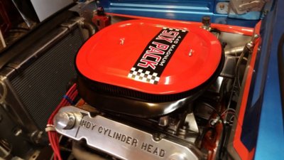

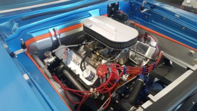

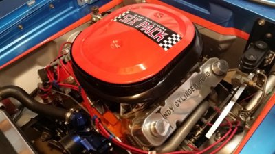

Just buy a regular Edelbrock 3x2 manifold and cover it with a 6 PACK AIR CLEANER like it did.
If you don't like the Original 6 pack air cleaner like shown in this picture on my car, then I have a billet aluminum 6 pack air cleaner like shown in the other picture in this post for sale.

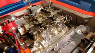

Some pix of my clearcoated, Edelbrock/Chrysler aluminum 6bbl intake. I've gotten good at taking the Holley carbs off, apart, and back together. The reusable gaskets from Promax ROCK!
