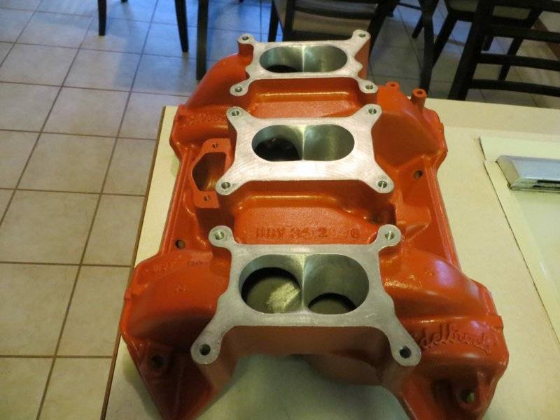

Yes. My 1st call would be Wilson Manifolds. I would get the most out of the trip to Wilson. Any port match to my future TrickFlow 240s would be included in the requested work to be done. Budnicks suggested an open rectangular spacer plate. If I knew I wasn't going to use the Nitrous Express 3x2 nitrous oxide plate system, that would be OK. If I do or may use NOS, I would not have space for a spacer plate and the spray plates and still be able to use my N96 setup. The N96 is a must with the current Edelbrock/Chrysler intake or the more likely Indy ModMan intake (single plane, more plenum for a stroker motor).
Modern cylinder head did that work. Should be pretty easy to duplicate for anyone with any porting experience.

So that is your 6bbl intake 68 HEMI GTS?
Please, PLEASE elaborate on your experiences with it: engine size, specs, cam profile, CR, carb mods, anything!
It is very important to me!

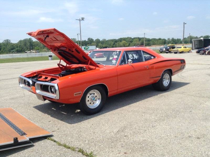

It is not mine although I plan to duplicate the intake on mine. It was on an all steel v code 70 Bee that was running 10.40’s through full exhaust and tail pipes and the air grabber. 4.250 stroke 440, TF240’s, medium size solid roller and 12:1 compression. Vacuum carbs. Think it had a 4.10 gear. Stick car but he had a TF in it. That’s about all I know.
Pick of said car when it was slower
10s in a B-Body 6bbl stroker, 4.10 R&P...I would be happy to accomplish the same with my 70 Roadrunner.
