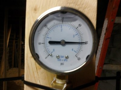

Be sure to pressurize your loops with air the night before and then check it periodically to make sure it maintains pressure....I set mine at 50#'s...
The pex is tough and if you have at least 30psi on it good
