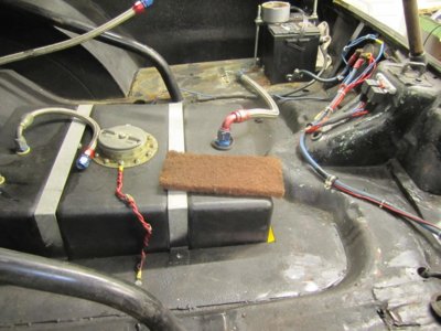

Rear down bars ready to weld in. Tough trying to make them the same.View attachment 863722 View attachment 863723
Where will the rear bar touch down?
