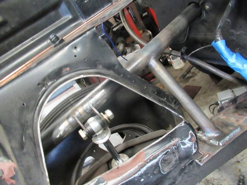

    hemi is the rear bars on plates or welded to the frame

      His are welded to plates directly over the frame

        Having the bar touch down further back helps rigidity.:thumbsup:

          Mine set way back in the trunk. They will be welded to the frame. Ronnie thanks for all your help and support.

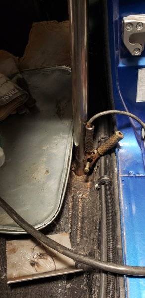

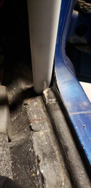

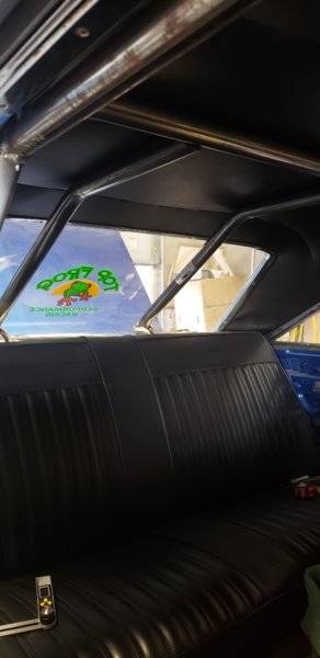

            More roll cage pics. Was able to weld all the way around the rear bars by cutting holes in the floor. 20191207_185707.jpg

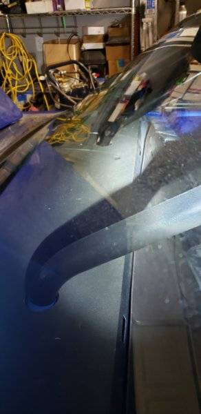

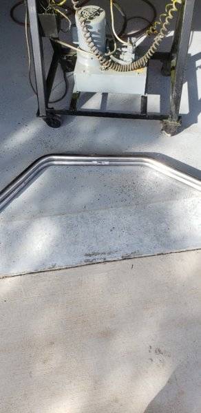

                Passenger front a pillar, the hardest part was drilling holes in the package tray, if you mess up its trash. Pic to follow 20191207_185712.jpg

                  Silver on the outside to blend in, will go with black by the kick panel and rear door panel 20191208_091432.jpg

                    bearman FBBO Gold Member FBBO Gold Member
                    Messages:
                    3,329
                    Likes Received:
                    2892
                    Joined:
                    Jan 9, 2018
                    Location:
                    Phoenix
                    Local Time:
                    10:42 AM
                    Great job on that package tray. But then again great job overall.

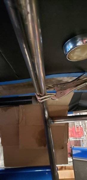

                          Damn! Forgot about the windshield bar. Snap
                          Now I have to put it all back up through the floor like its going in permanent and mock up windshield bar, then lower it back through the floor and weld it up. ..

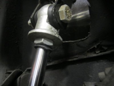

                            440 Ronnie, how does your top shock tower line up. What rear shocks are you working with.

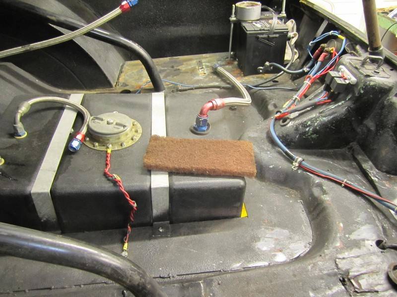

                              Shock towers are over rated:lol:

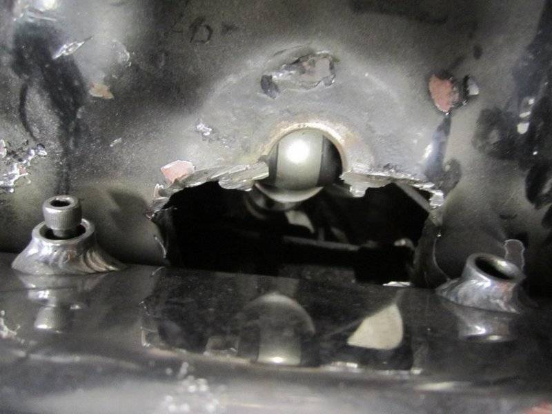

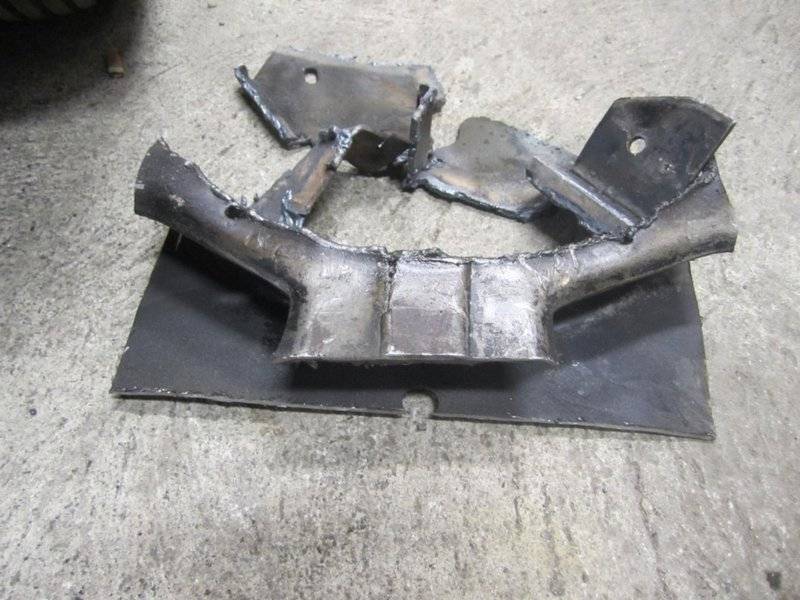

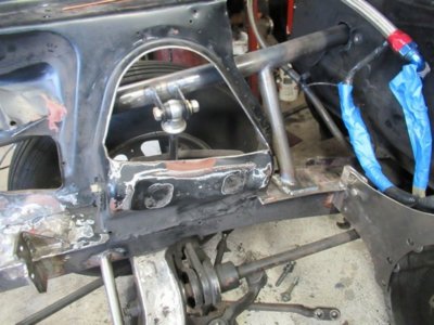

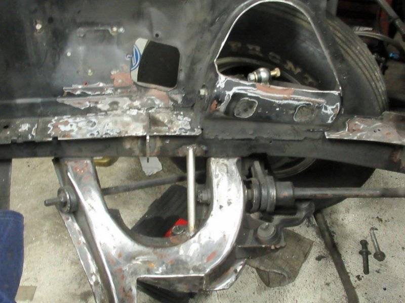

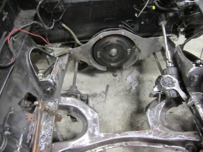

                              2.25.17 005.jpg 2.25.17 006.jpg 3.18.17 014.jpg 5.9.17 036.jpg 5.20.17 016.jpg 6.6.17 005.jpg 6.6.17 012.jpg
                                Messages:
                                3,329
                                Likes Received:
                                2892
                                Joined:
                                Jan 9, 2018
                                Location:
                                Phoenix
                                Local Time:
                                10:42 AM
                                Nice work get lots of pics might do mine thank you

                                Rear shock tower mount are original, my shocks are calvert
