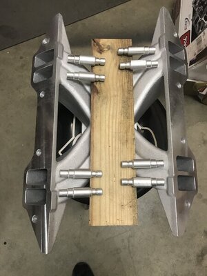

Pretty slick but I would look at putting the injector bungs on the bottom of the intake so all of that is hidden for a cleaner install. A custom valley pan would keep the oil off of it.This is what started my borderline madness, and this isn't the only setup like this "out there". I think this is setup to flow 2,400 cfm. Funny thing is that the short throttle bodies may actually fit under my current N96 hood...
View attachment 958337 View attachment 958338
Like this? (See X marks)I would look at putting the injector bungs on the bottom of the intake
No. Closer to center to use a single fuel rail and take advantage of atomization and heat absorption while traveling down the runner.Like this? (See X marks)
glad to have you backIt is! Been a while. You holding up OK?
I thought it was better to have the injectors close to the valve? I don't really know. I'm sure Bruce at F&B is well versed in the "DPI ARTS"No. Closer to center to use a single fuel rail and take advantage of atomization and heat absorption while traveling down the runner.
Similar location but a lower angle where the injectors point to the center and one rail runs up the center.I thought it was better to have the injectors close to the valve? I don't really know. I'm sure Bruce at F&B is well versed in the "DPI ARTS"
Can you draw what you're talking about or do you have a picture of something like that? Sorry, but I'm not seeing it.
So you're suggesting the injectors enter the intake runners at a higher position, where you drew the fuel rail? That's something I would have to ask Bruce at F&B about. Thanks, I do like the stealth appearance of that, especially if I go through the expense of polishing or otherwise "dressing up" the intake.Similar location but a lower angle where the injectors point to the center and one rail runs up the center.
Yes, the injectors would all spray up and one rail could be used for all. If he wants them closer to the valve, at the port opening, the picture is another variation.So you're suggesting the injectors enter the intake runners at a higher position, where you drew the fuel rail? That's something I would have to ask Bruce at F&B about. Thanks, I do like the stealth appearance of that, especially if I go through the expense of polishing or otherwise "dressing up" the intake.
I am going to look at whether or not the short height of the throttle bodies (vs the Holley 2bbl carbs) will allow me to use my current N96 hood. The cost savings of not having to buy a new hood and the visual appeal of my current N96 hood would defer the substantial cost of the F&B direct port injection system. Once I had the F&B setup up and running, I may sell my Edelbrock/Chrysler aluminum 6bbl intake and Promax modded Holley carbs to further offset the cost of the F&B 3x2 EFI system.
Hmmmm....
How do the injectors install? Generally they push into their respective holes and the rail pushes onto the injectors. So one side would go in fine. How does the other side fit in one common rail? Is there a different type injector I do not know about?Yes, the injectors would all spray up and one rail could be used for all. If he wants them closer to the valve, at the port opening, the picture is another variation.
The common rail has to be inline and they are all pointing up vertically. The bungs would be in a line as pictured in red. The second option as pictured has to be a two rail system and the injectors angle slightly to make room. You can also use threaded injectors that screw into the bung and just get hard line (or AN lines) screwed to the tops.How do the injectors install? Generally they push into their respective holes and the rail pushes onto the injectors. So one side would go in fine. How does the other side fit in one common rail? Is there a different type injector I do not know about?
