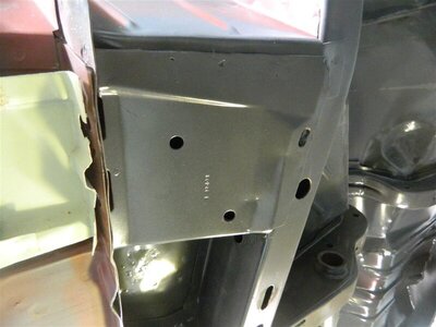

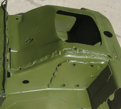

I never recall seeing torque boxes up close before I decided to add them to my red car. I saw what they looked like in parts ads in magazines so I went to a local metal supplier and bought some sheets of 14 gauge steel and formed my own.
I did this with the car on jackstands! Welding with a flux core MIG welder on my back, spatter burning holes in my clothes and grit in my ears!
The frame connectors are 3x3 .120 wall steel. Surely thicker than needed but they didn't have 3x3 in .090 wall. I welded extensions above the top edges to make the connectors appear to go full depth.
They sort of resemble the XV Motorsports or US Cartool style at a fraction of the price.
The rear torque boxes went in after the frame connectors.
Yeah, those are water drops. I washed the underside today to snap these shots for BioMed !

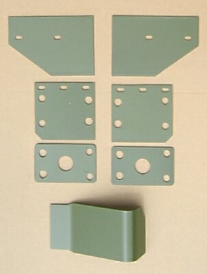

I'm going to take a shot at what is in the picture from top to bottom, but I'd like to confirm that only the 3rd from the top, which I'm guessing are spring plates that go where the nuts for the front of the leaf spring are, is what is important for support?
@4406bbl Would you PLEASE describe the parts in the pic from top to bottom and where they go?
You know your car is right now, that is all that matters, now you can mod it and make it better.
Rear rail reinforcement
Rear spring box
Front spring box
Snubber reinforcement
There are 2 plates for springs front and rear, ECS makes a nice snubber part, cheap too. It will take your guy about an hour to weld those in, prep grinding will take the longest. Just remember, the factory knew where these cars were weak, I fully welded my cowl seams after seeing one on a 2 post lift. I did not want to see the witness marks thru the lead later after beating on the car.
BIG help 4406bbl, thanks again.
