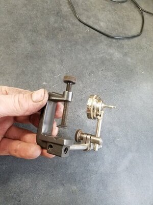

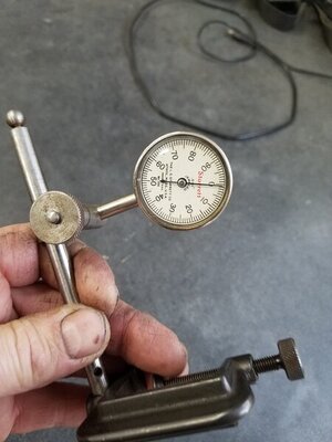

Regarding the dial indicator and magnetic base:
There are certainly better ways to go. Experience teaches you what worked in the past and what did not. It seems to me that if I was able to start at zero, make a full revolution and have the dial return to zero that the setup is accurate.
