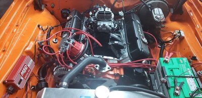

Looking for a little help here:
I built a 440 RB and had a good time time doing it, however I'm struggling with starting it up. I built this engine, dropped it in, and it started up fairly easily on initial startup. That being said, the rear main did not seal up and slung quite a bit of oil. I ripped the engine back out, replaced the rear main and dropped back in. Since then, I have struggled to get it started. I have trouble shot multiple angles and am somewhat stuck.
Ignition - Verified spark at distributor and at all plugs, replaced both coil and distributor
Fuel - Fuel is good, also delivered starting fluid directly into carburetor
Compression - Good
The engine will turn over mechanically, but there is not even a cough. I have verified TDC and manipulated the distributor accordingly to no avail.
Any help/suggestions appreciated.....

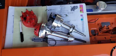

Seems to be the consensus. I haven't played around with the new MSD distributor that I dropped in, so I'll do some more troubleshooting there, verify TDC again and play with the timing some more. With fuel and compression verified, there shouldn't be too much left to check, not too many bells and whistles on this thing, pretty basic setup....
do you have the old distributor ? I would use that and see what happens. what did you use when you first got it started?
The original distributor was a mech advance that I bought from 440 source. It came with little to no literature so not much to go on there. I read about some challenges on the forum regarding the advance curves hence my rationale to go ahead and opt for the much pricier MSD equivalent.... old distributor is a no go, I will play some more with the newer MSD version.
What I'm reading is the 1st start up and run was with the 440 source distributor.
After pulling the engine to redo the rear main you have also decided to replace that 440 source distributor with a MSD set up and the engine has not started since the switch .
Mabey I have missed something but that's how it reads to me.
Try swapping back to the 440 source distributor. I understand you do not care for their advance set up , but at least it would run.
I'm sure MSD builds a great product but they do seem to generate many threads on here ?
Heck , mabey try a mopar distributor and box ?
Good luck , hope she fires up for you.

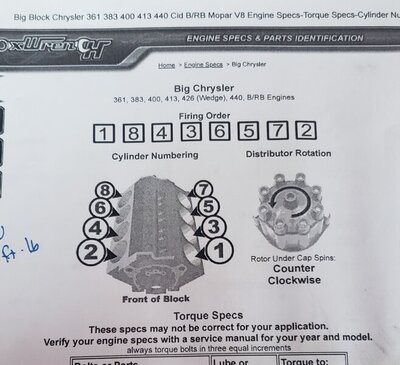

Yes, i have spark to each cylinder, i have removed the plugs and turned over while plug arcs to ground. The firing order is based on the Chrysler BB. your statement rings true about it running before, i just can't seem to find the gremlin.
Go back to square one. Back to basics. Meaning, making sure your cam/crank are in synch (as stated, #1 on compression stroke to fire #1 in distributor). Proceed from there. I followed the MEF method : mechanical, electrical,fuel. Systems in that order.

If it starts with one distributor and not the other I bet the 2 pick-up wires are reversed. Try swapping them.

It's been mentioned before, but I'll reiterate it. I tried for a week to get my fresh build to start. Yes, I knew that the distributor on BB rotates counter clockwise. Yes, I had checked my laminated wiring diagram at least 20 times. Valve cover off n checked TDC. I had been a helicopter turbine engine mechanic for 23 yrs, built many other engines, what was I doing wrong. Well, I had been "looking" at the diagram and not thinking. The diagram showed distributor cap wiring for small block, which is clockwise. Not thinking, I wired them in reverse. Once I realized what I did, a week later, I fixed it n it fired right up.
