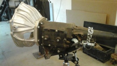

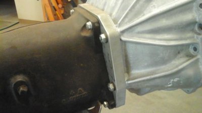

After playing with Chevys for years and switching to Mopar I ended up with a spare 427 Chevy engine and an 18 spline Mopar 4 speed transmission. I thought I would do one more project and put them together. I bought a 73 Camaro Rally Sport (very rough) re-skinned the whole car, put the 427 in it. I read an article where in the late 60s drag racers learned that Chrysler 4 speeds where stronger than Muncies and figured out how to put them together. So in looking for the adapter I eventually found that Passon Performance makes them still. Bought one and sure enough it is a cake walk. Now I have a Chevy that burns rubber like a Mopar!
Did it require cutting the input shaft on the Hemi transmission?
It was already cut off. It looks like it would not need to be since the adapter is 1 inch thick and holds the trans back far enough. There is still sufficient reach to engage the pilot bushing.

Since Chevy used the Mopar A833 transmission in half ton pickups and vans from 1980 to about 1987, finding one of those might save on looking for adapters and custom bellhousings.
You want to use the Camaro/Chevy throw out bearing and Chevy throw out fork. To fit the throw out bearing over the input bearing retainer you need to have a machine shop take 40 thousandths off. For a pilot bushing I had to shop around and find one that fit the trans and work down the outer side to fit the crank.

I do not have the pilot bushing part number, sorry.
