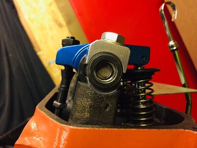

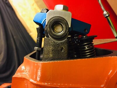

So this is my first time building a non-stockish engine. It’s a 400 to 470 stroker. Harland sharp roller rockers with a custom grind solid flat tappet cam. I’m trying to measure pushrod length to order a set and have never done this before. Read a bunch of articles and they mention push rod to adjuster screw geometry. From what I gather you want about 1.5 threads showing through the bottom of the rocker but the geometry is important. From the pics below can someone tell me if that angle is fine? No shims have been added here and I hope to not add any. Also, do I measure length while the feeler gauge is holding the correct lash? Final question, is cold lash cam specific or is there standard intake/exhaust lash that I should be using?
thanks for the help. I’m sure to most of you this is common knowledge but it’s intimidating for a first timer.

Picture looks good,how is the witness mark on the valve stem??
Haven’t turned the engine over yet to check. Wanted to verify that the geometry was good first. If you say that angle is ok I can move on and turn it over to see the witness mark. I have to also figure out the cold lash spec as well to set it up properly prior to checking the witness mark.

i did not know this. I always thought pushrod length is what changed the contact patch on the valve tip. As for the angle of the pushrod to the ball tip on the adjustment screw, is there anyway to know if the angle I have is ok?

I’m stuck with these HS rockers now so have to use them even if the geometry isn’t ideal. The springs are very light so that shouldn’t be a problem when trying things out. That’s for the advice on the oiling. I heard usually about 1.5 threads showing us the right amount for the rocker adjustment screw but I’ll double check to make sure it’s slightly lower than the oil hole. So that angle I pointed out in the pictures seems to be fine?
Imo,, yes.
The only way to change the p/r to rocker angle is a different rocker....or move the lifter holes in the block.
So it "is what it is".
I guess the B3 relocation could change it slightly too.
You would need to check the geometry first before deciding if you think it is good enough then decide the pushrod length to suit were the rockers/adjusters end up.
As others have said the only way to change the rocker geometry is the raise or lower the fulcrum point of the shafts. Dave Hughes rockers are far better than HS.
I lowered mine around 80 thousands and shifted the shafts towards the pushrod about 10 thousands. I machined the heads.
The angle of the adjuster is set by the manufacturer so you cannot adjust. You will find the valve will start to lift and the the pushrod top will start to sweep towards the intake.
You need to try and minimise this sweep - and pushrod length will help here.
Check your sweep pattern first on the valve stem, if this is too wide or too far off to the side you will require to relocate the rocker shaft. (most of the time with roller rockers you need to raise and move away from the valves)
I used the B3 kit to set mine to center and minimal sweep, see pictures.
By doing so you alter the length of the push rod.
Pushrod length does not change any geometry, the length is determined after the geometry is set.
Go for an as long as possible push rod, depending on the way of oiling (through lifter or from rocker arm) you will need to ensure the oiling hole in the rocker arm can reach the cup, if the cup sits too high it might not get oil from the oiling hole. But in that case it would be a design flaw of the rocker arm as it will force you to have multiple adjuster threads below the rocker arm.
If your push rod would be "short" you need to increase the length of the adjuster below the rocker arm, by doing so you will increase the "side way" motion of the push rod which will make you loose valve lift and puts a bigger angle between the adjuster and push rod which increases the side load on the ball/cup.
