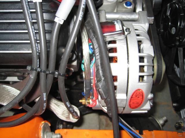

What is that box mounted on the alternator?
Its part of the 1 wire alternator. All the factory hookups are connected is there something i need to disconnect or is the way i have it ok.
Also a word of caution,
Is that some of that high strand clear coated stereo 4 gauge cable on the back of that alternator going to the starter? If it is, be careful. I have seen some of that high tech stuff melt in engine compartments. Also, in the back right corner of the engine compartment behind the head, is that a NOS line that looks close to that cable? Steel braid can work through wiring insulation faster than a hacksaw, so make sure there is no contact. Nothing makes a day more exciting than your engine compartment go thfffftttt. (Been there, done that)

No sterio . And yes on the wire. Ive checked it and its ok ill put something between the two to keep it from doing that. thanks
