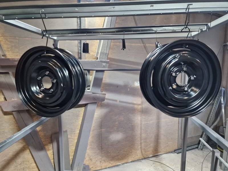

I bought a Set of 60s Volvo Steelies 15x4! Same Bolt Pattern! Want the Skinny Look for my 63 MaxWedge :). What is the biggest Tyre for that ? 205/75 or maybe a 205/80… want to drive a Radial Tyre!
For the Rear i have OE Steelies in 15x7 with a 275/60

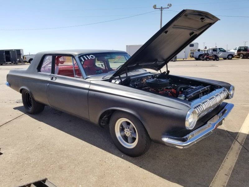

While I hate the flame tread design, the M/T Sportsman S/R is available in 26, 28 and 29" tall tires and work really well. I struggled for a long time to find a radial that filled out the HUGE '63 Dodge front wheel openings on my car. They drive great on the street AND track.
2nd on the M/T sportsman S/R.
