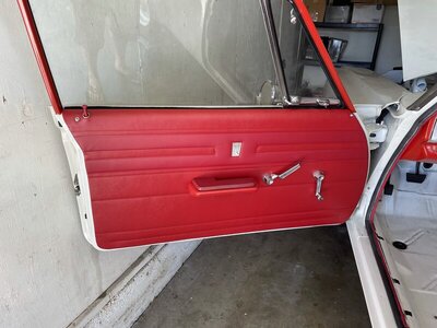

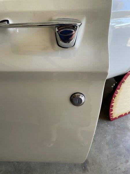

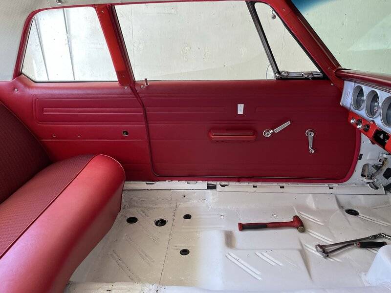

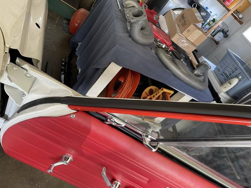

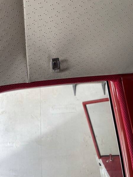

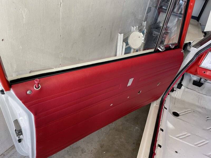

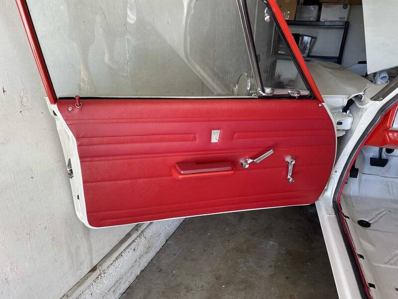

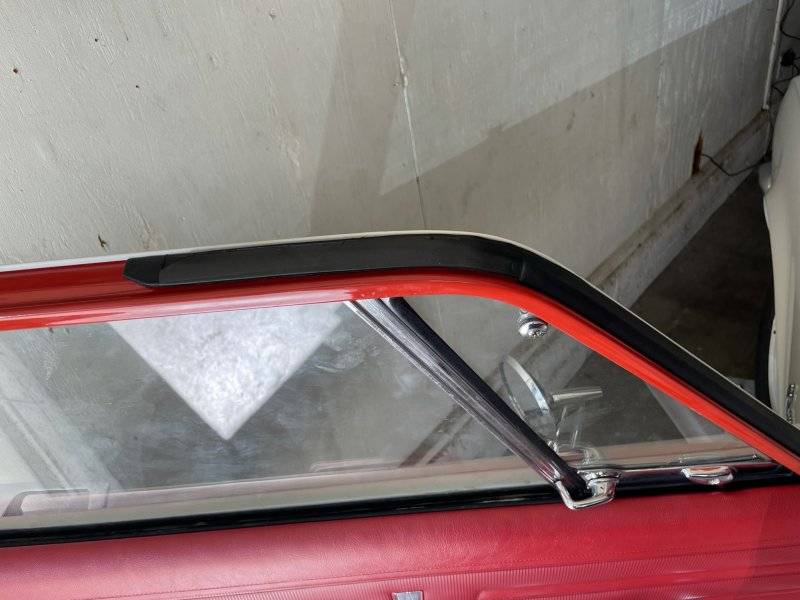

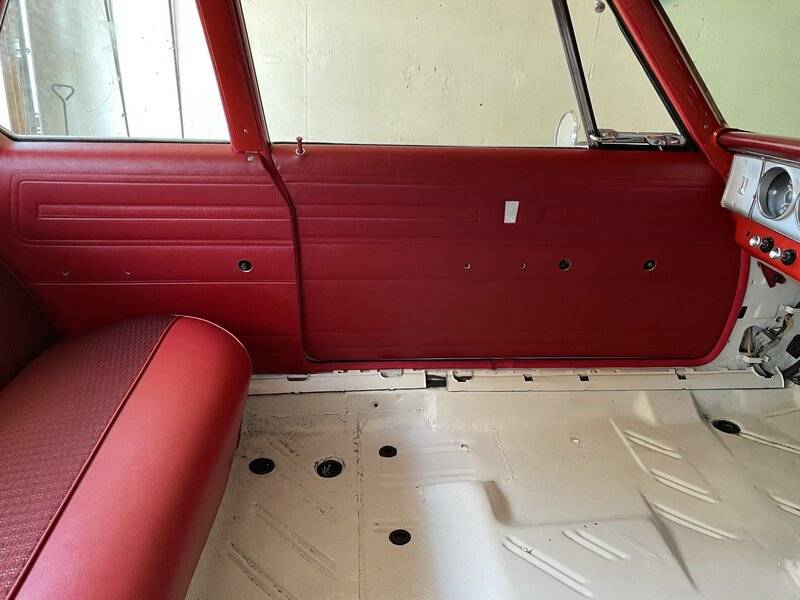

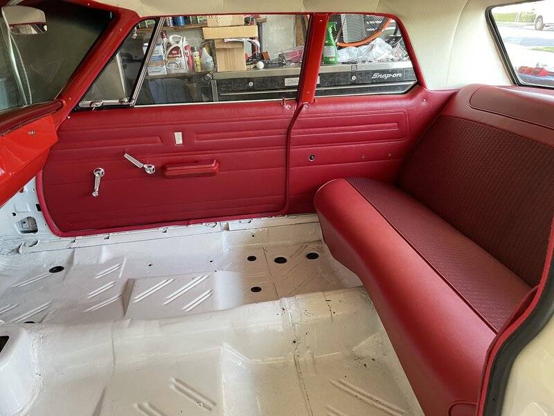

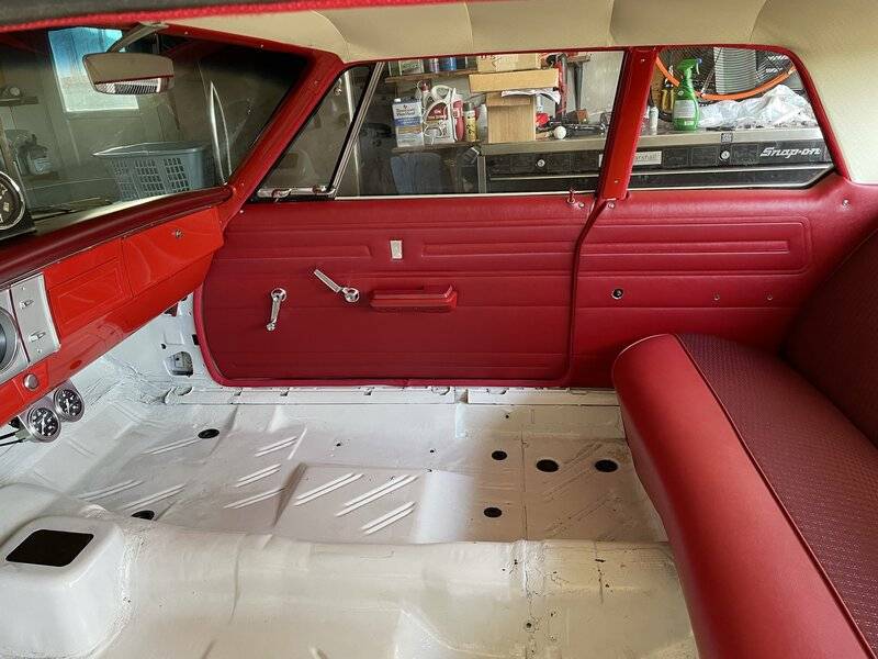

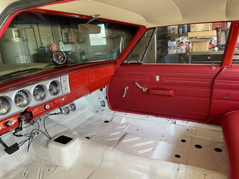

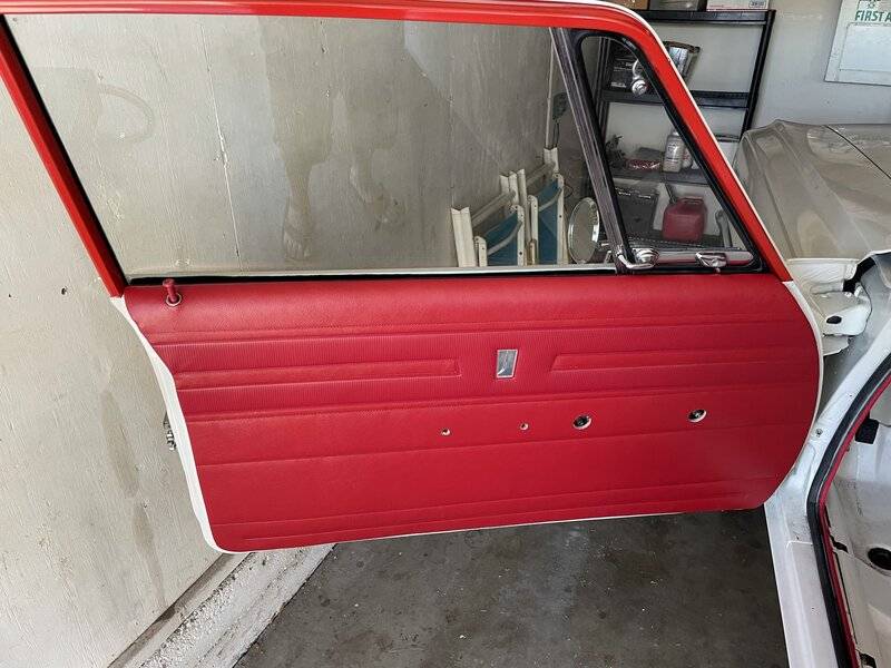

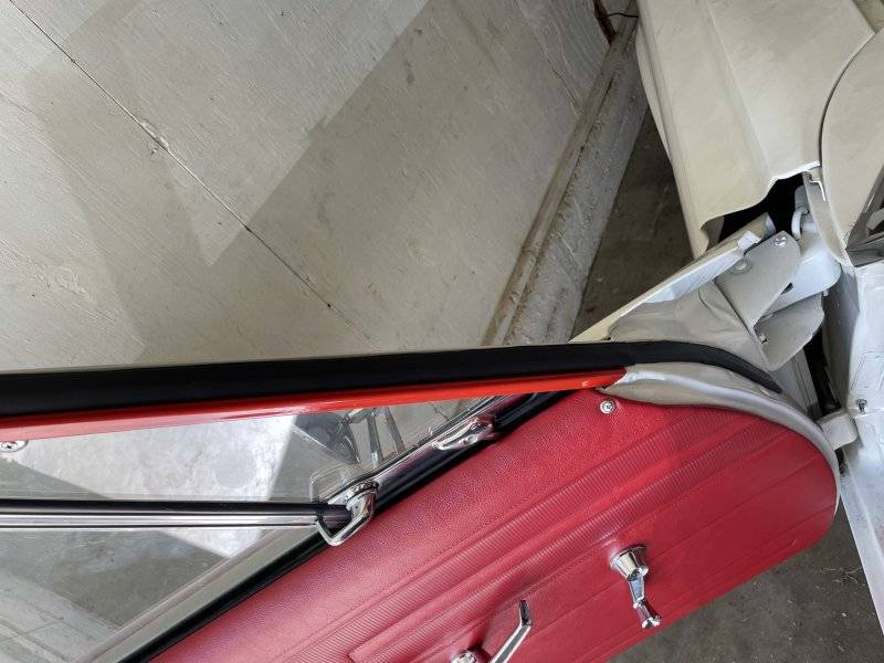

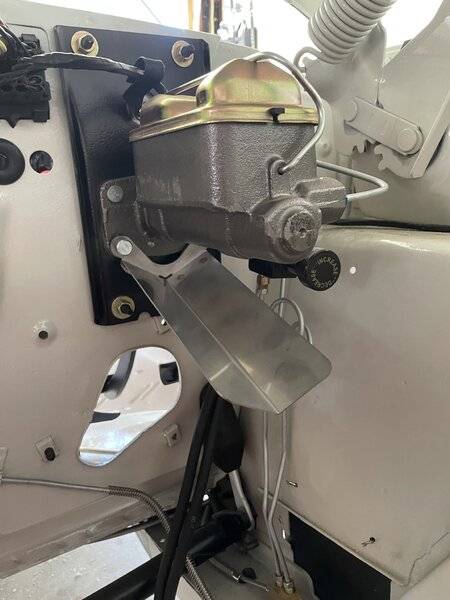

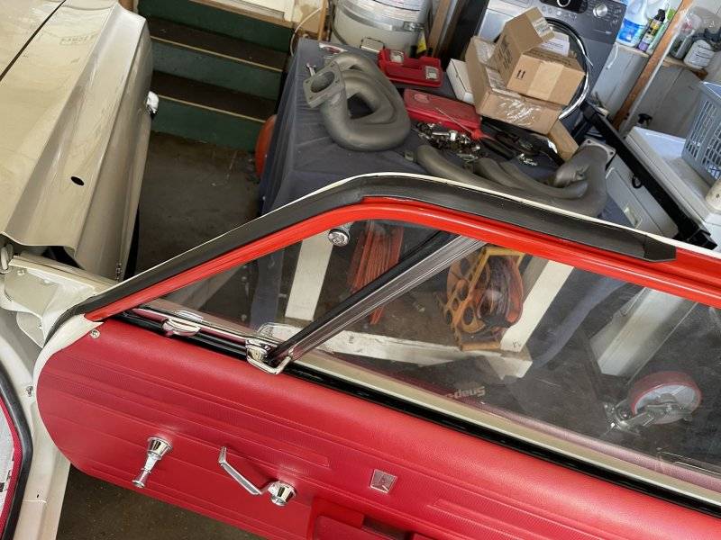

Now got the drivers door lock cylinder and gasket mounted. Mounted drivers door panel.looks like I might be going with the black carpet I think.

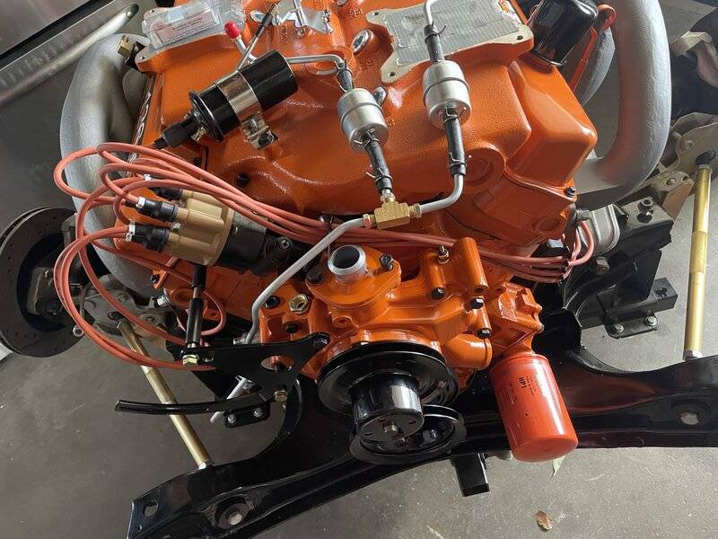

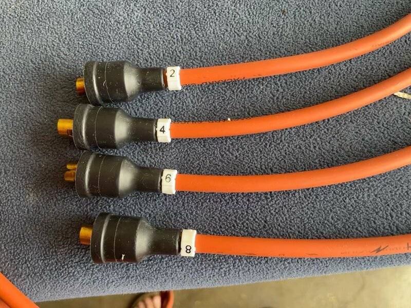

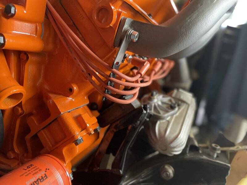

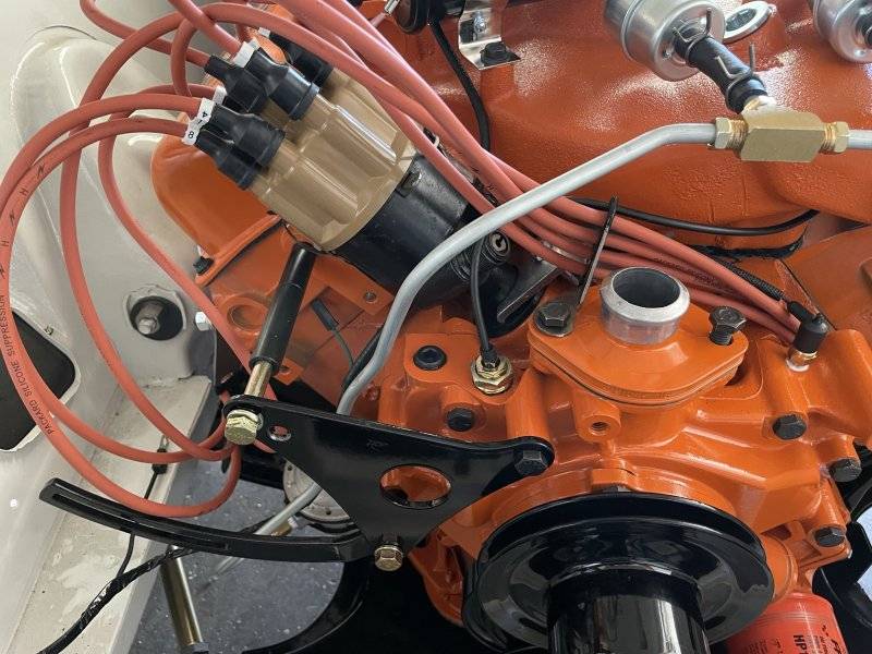

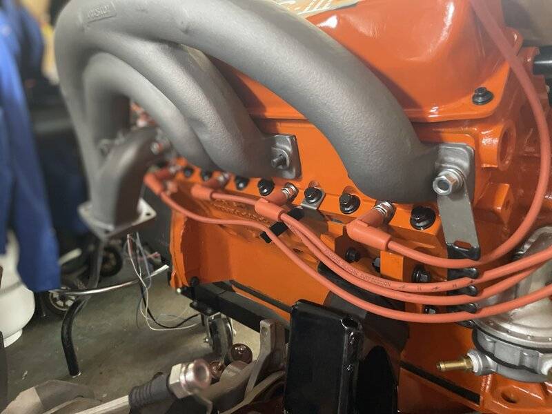

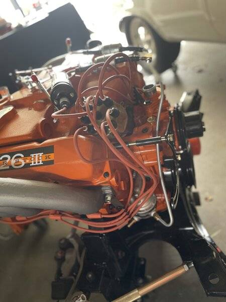

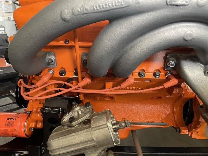

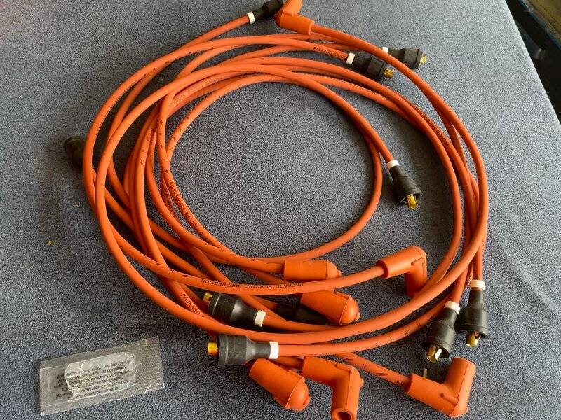

Got the set of Max Wedge Power Core 7mm ignition wire set from Kramers, according to them it's the last set. They are spiral cord wiring so should work well with MSD6AL2. They are pretty nice, numbered and precut to length and they are orange.

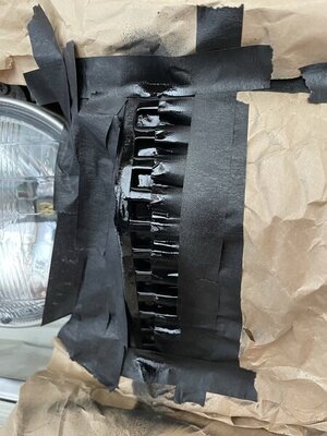

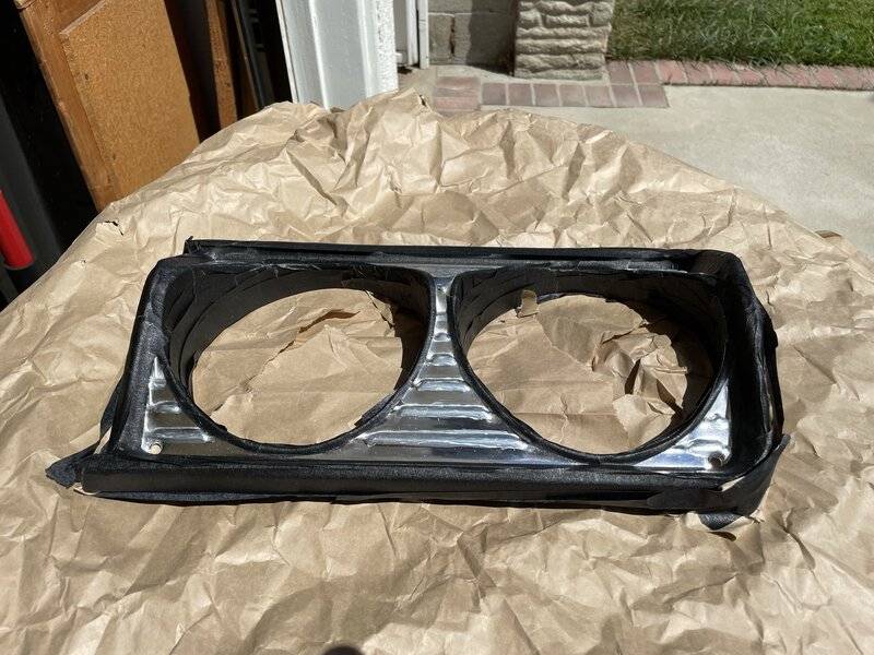

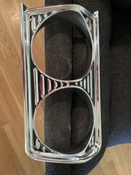

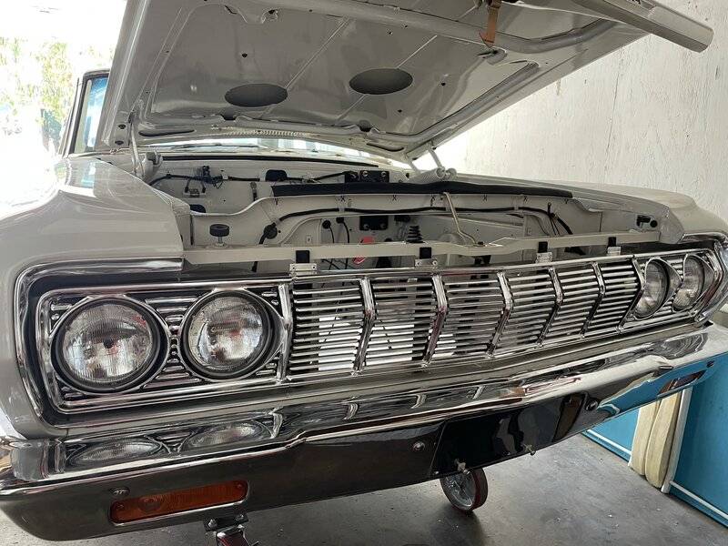

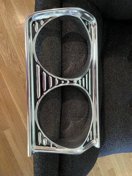

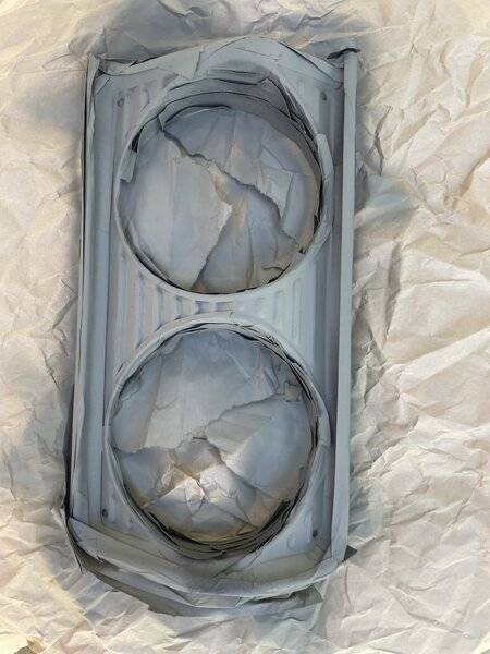

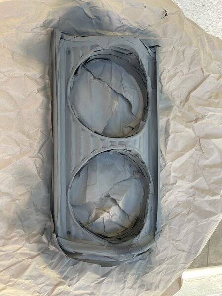

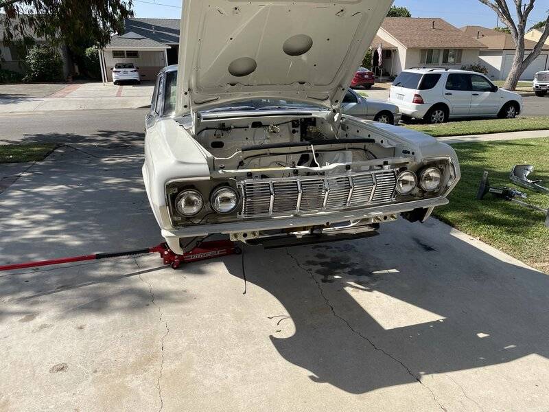

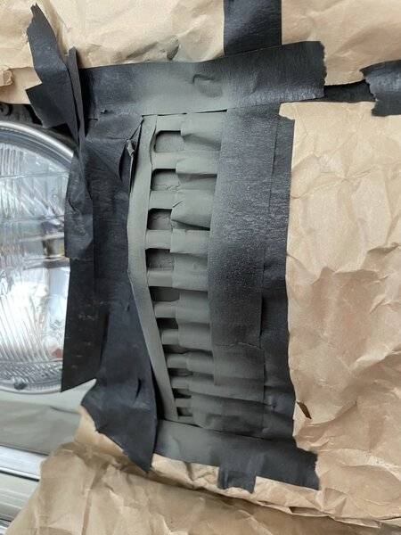

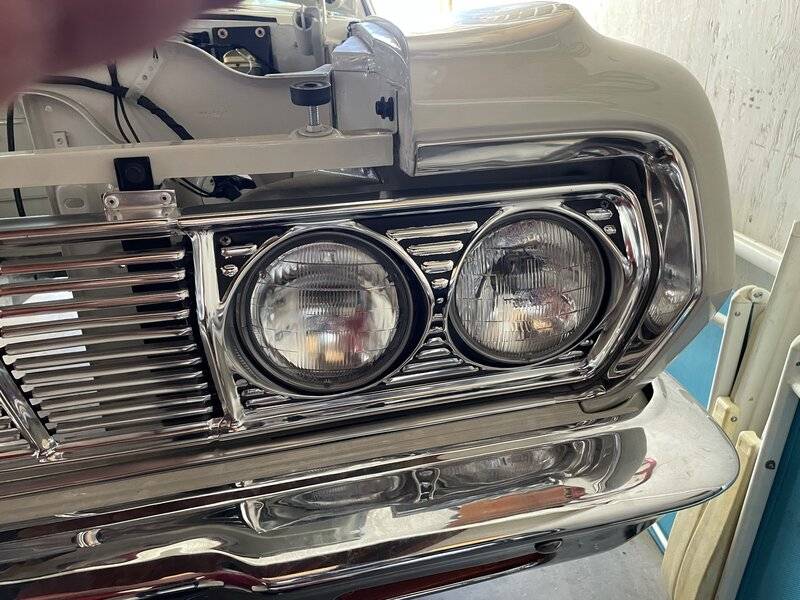

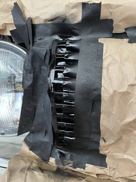

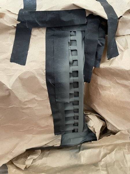

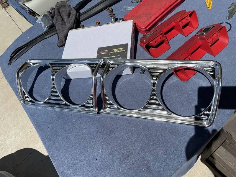

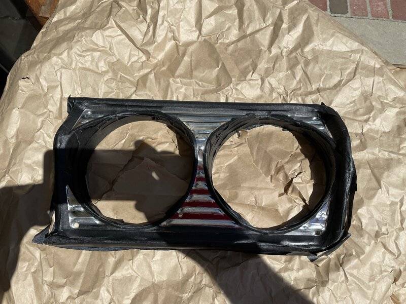

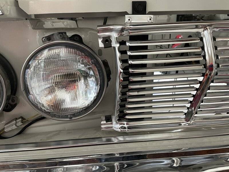

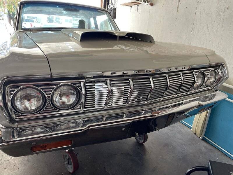

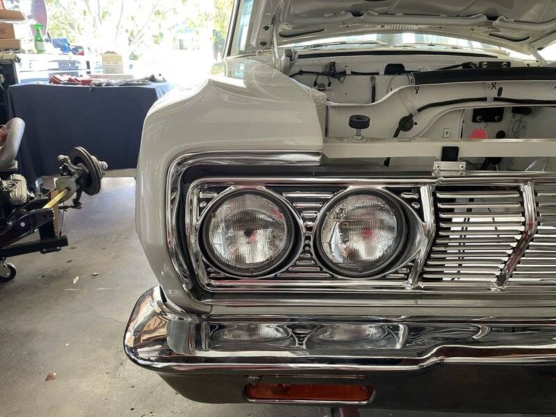

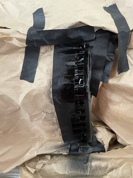

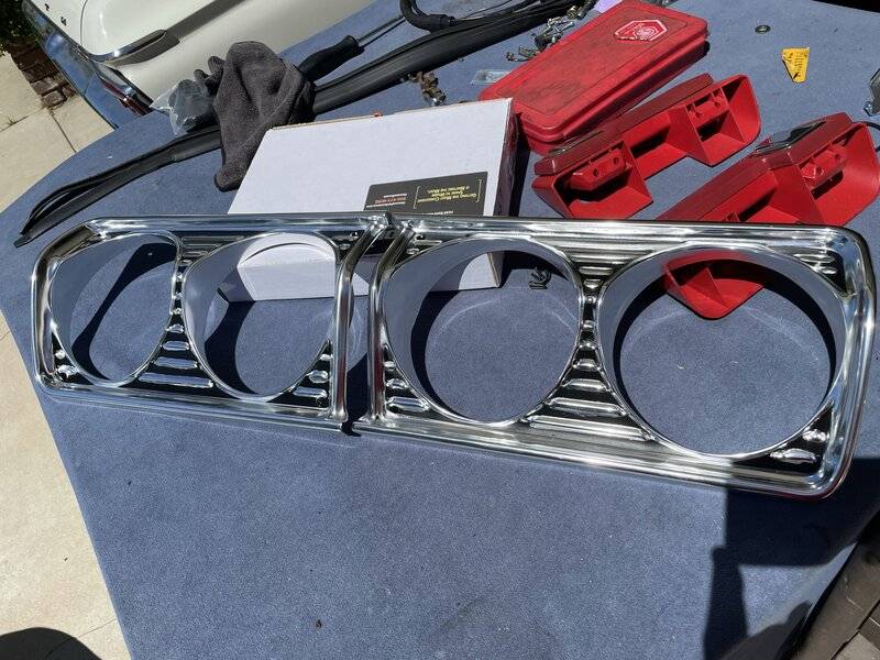

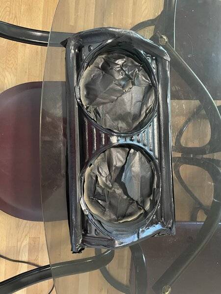

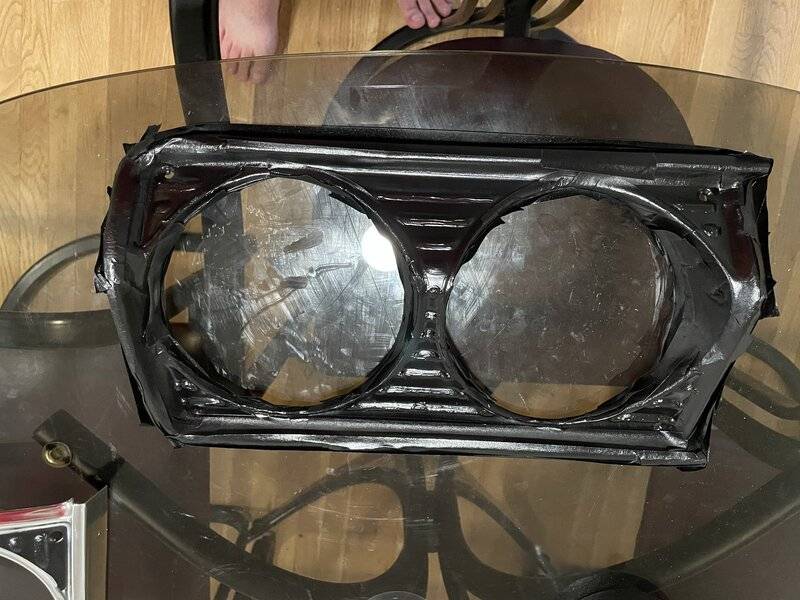

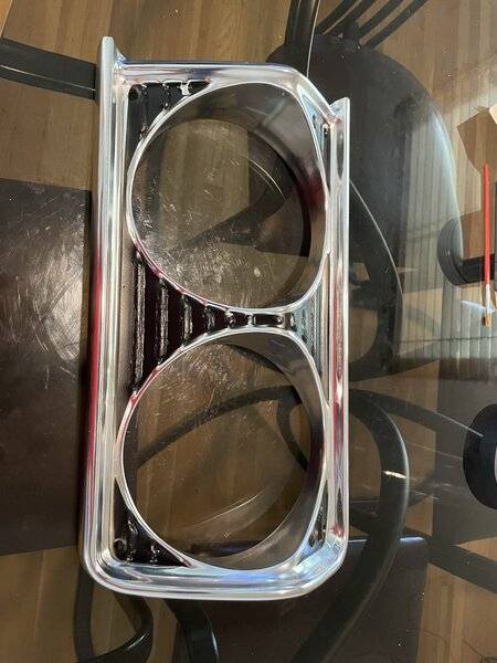

Finally got around to finishing the black around the headlight covers for the grill. I masked off around with masking tape and then used liquid latex to brush over the ribs.Then used primer and paint.after the paint was dry to touch I removed masking and then waited over night to remove the latex.
IMG_2151.jpg IMG_2152.jpg IMG_2153.jpg IMG_2154.jpg IMG_2155.jpg IMG_2157.jpg IMG_2158.jpg IMG_2159.jpg IMG_2160.jpg

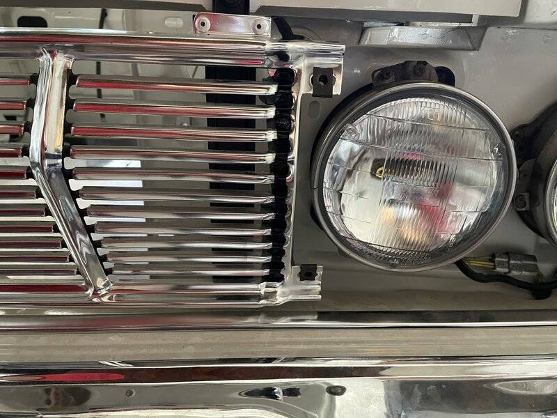

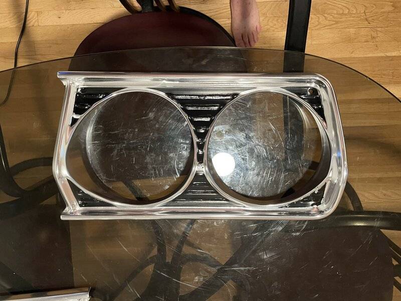

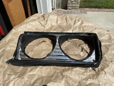

Here they are with the latex removed. I'm happy with it but it's not perfect. I did want to paint it with spray on rather then brush because I didn't want brush marks in the paint. I wanted it smooth like original. Also realized I did not do the ends of the grill so I did that as well. This was probably for me the most painstaking thing I've done to the car lol.

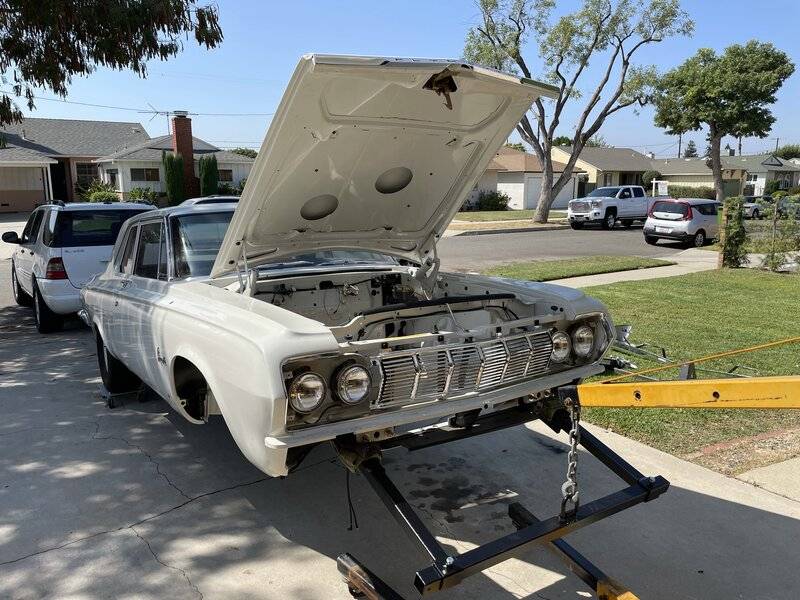

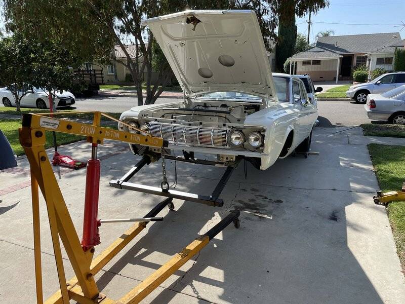

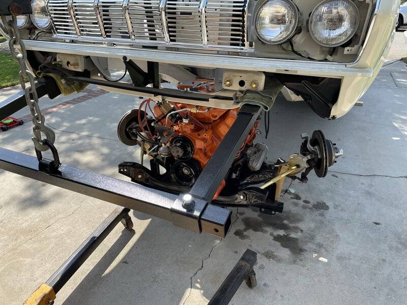

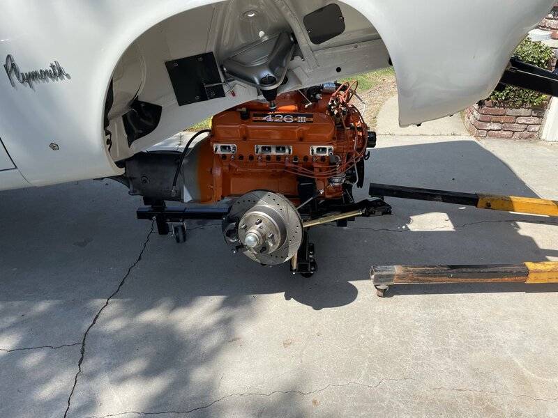

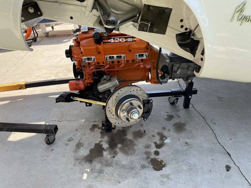

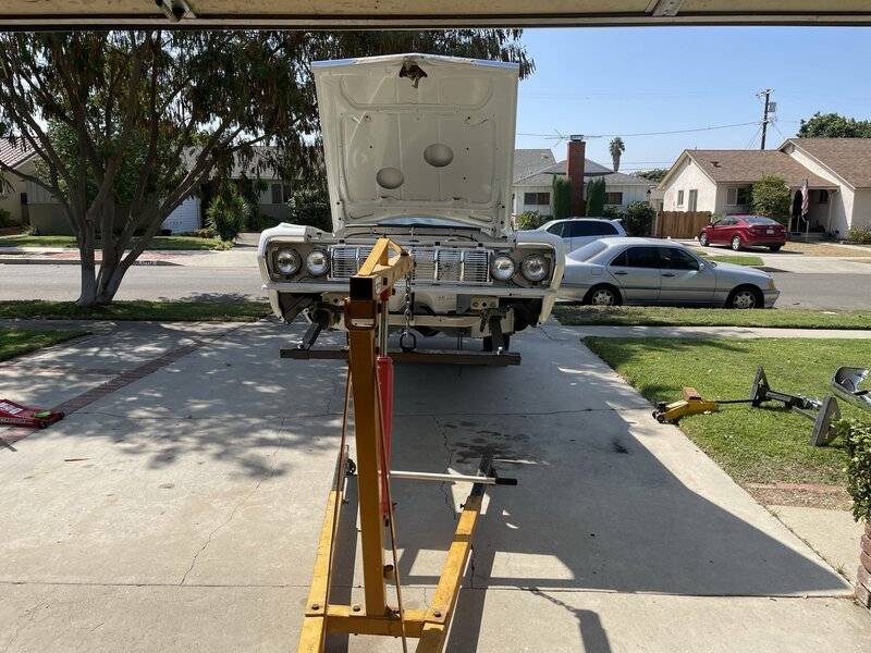

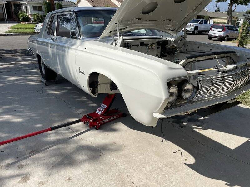

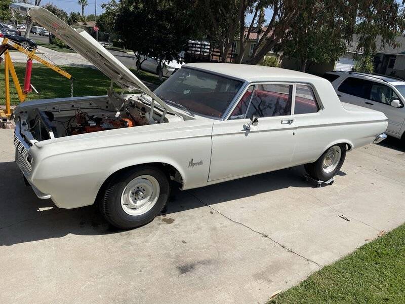

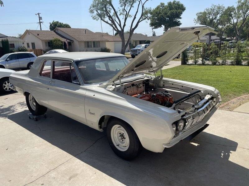

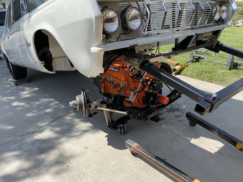

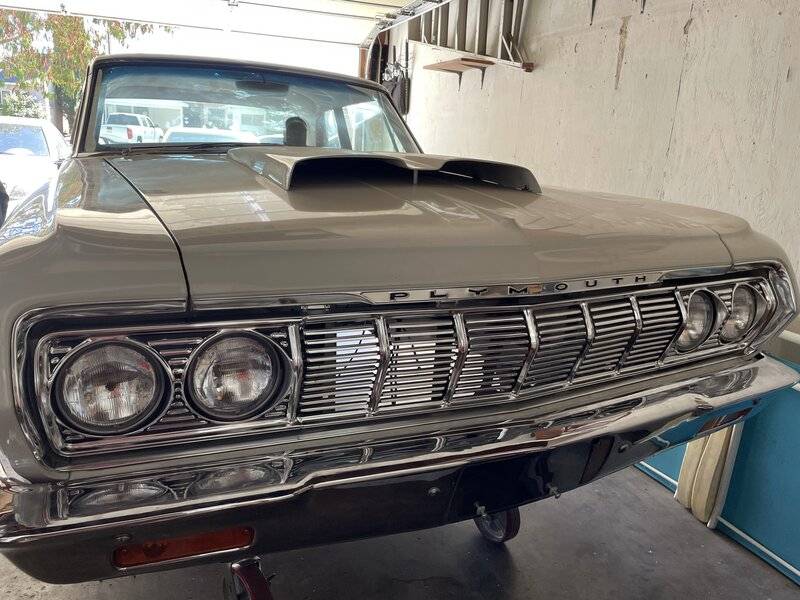

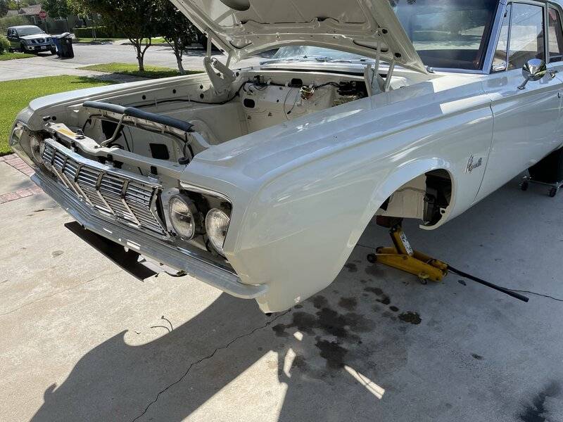

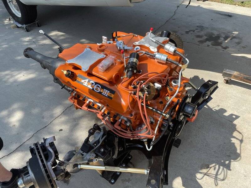

I order a uni lift from us car tools to put the motor in today. When I took the front bumper off I notice the uni lift mounting brackets will not attach correctly on my car so come to find out I some how ordered the 69-76 one and not the 62-65. I called and spoke to one of the guys in the service department and he jumped right on it and sent me an email shipping me the 62-65 one. Great customer service and they make really good products and tools for our cars. I've purchased a lot of stuff from them especially on my 68 Dart for chassis stiffening and mini tubes. I will be making a build website on that car as well on A bodies only lol!Any way I was able to male this one work and successfully installed the k member with motor and transmission!
IMG_2185.jpg IMG_2186.jpg IMG_2187.jpg IMG_2188.jpg IMG_2189.jpg IMG_2190.jpg

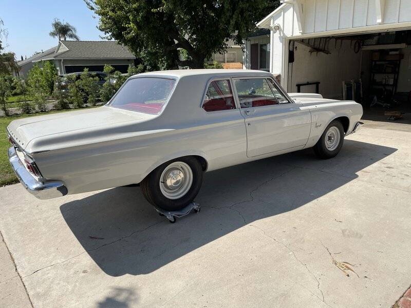

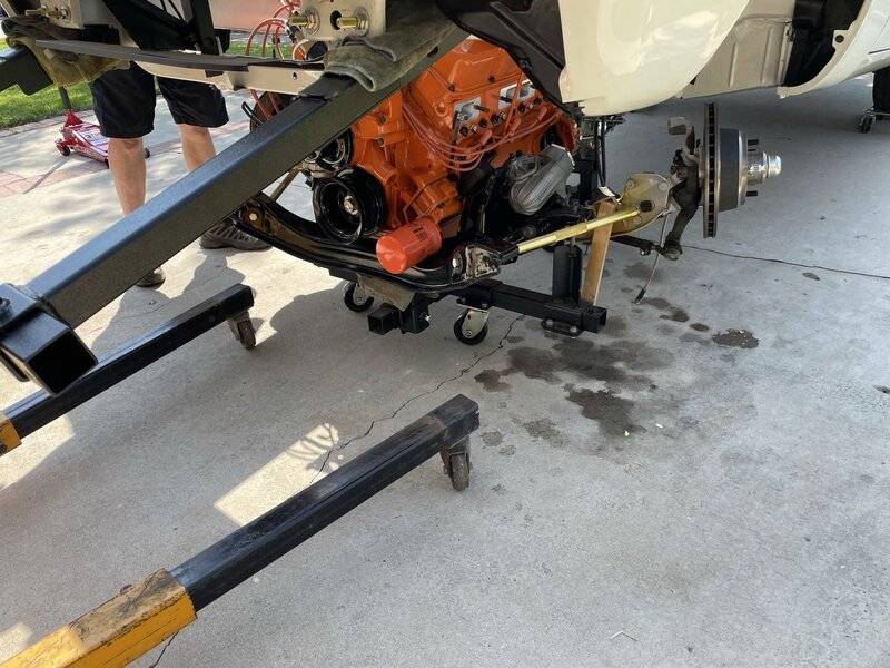

Rolling engine underneath with us car tool Engine dolly. Had to have the frame rails at 3 ft from the ground at the back mounting hole for k member. It easily went in and lined it up then slowly lowered the car down over the assembly. Worked great
IMG_2191.jpg IMG_2192.jpg IMG_2193.jpg IMG_2194.jpg IMG_2195.jpg IMG_2196.jpg IMG_2197.jpg

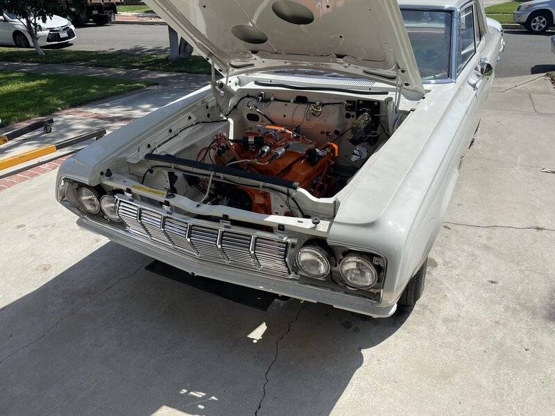

Got everything close and lined up then installed the four k member bolts and torqued them down. I looped a chain across the transmission crossmember mounting holes to hold the back of the transmission up. Should get my cross member for the transmission soon.
IMG_2198.jpg IMG_2199.jpg IMG_2200.jpg IMG_2201.jpg IMG_2202.jpg IMG_2203.jpg IMG_2204.jpg IMG_2205.jpg

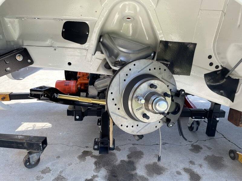

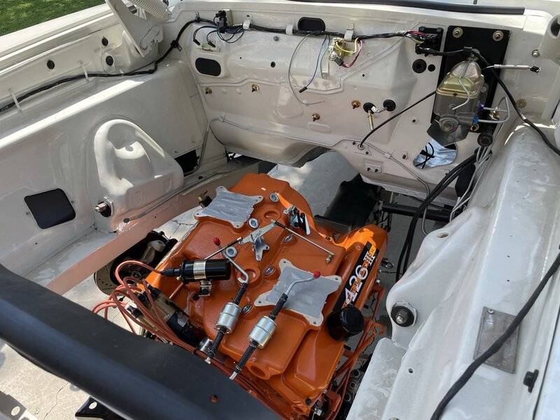

Got the upper control arms mounted and used block off wood on the lower control bumper and the frame to hold the car up. Don't have the torsion bars yet. I'm going to go with PST's and get a discount for members. But the motor is finally at it home in the car and she's got 4 wheels now!

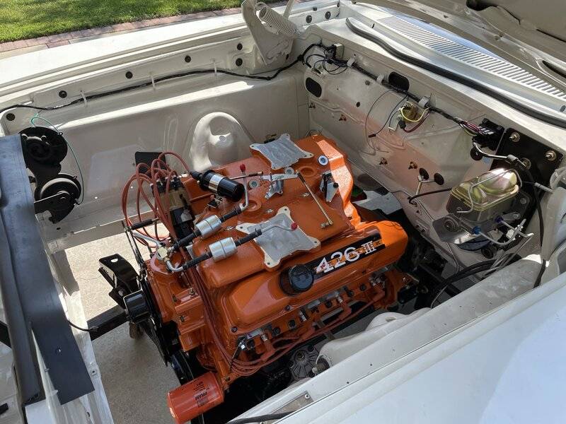

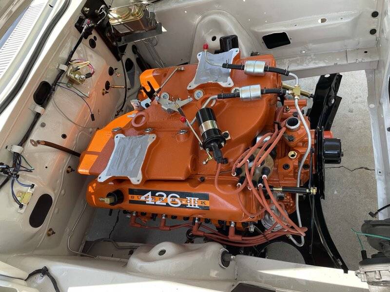

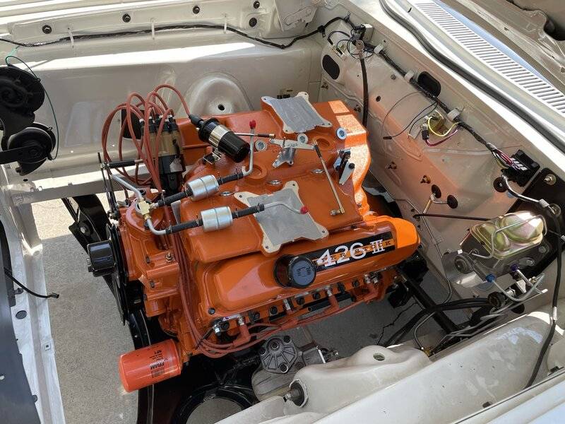

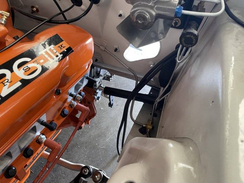

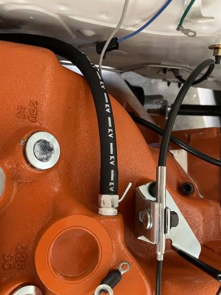

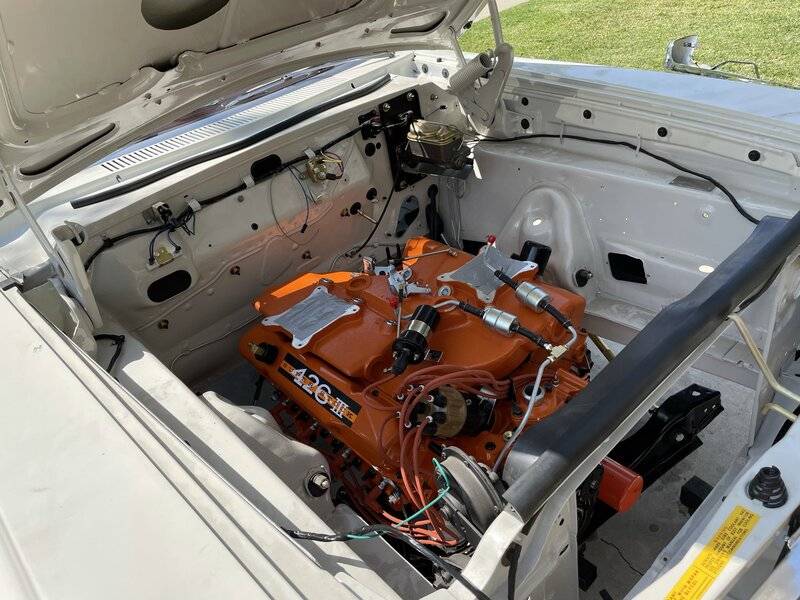

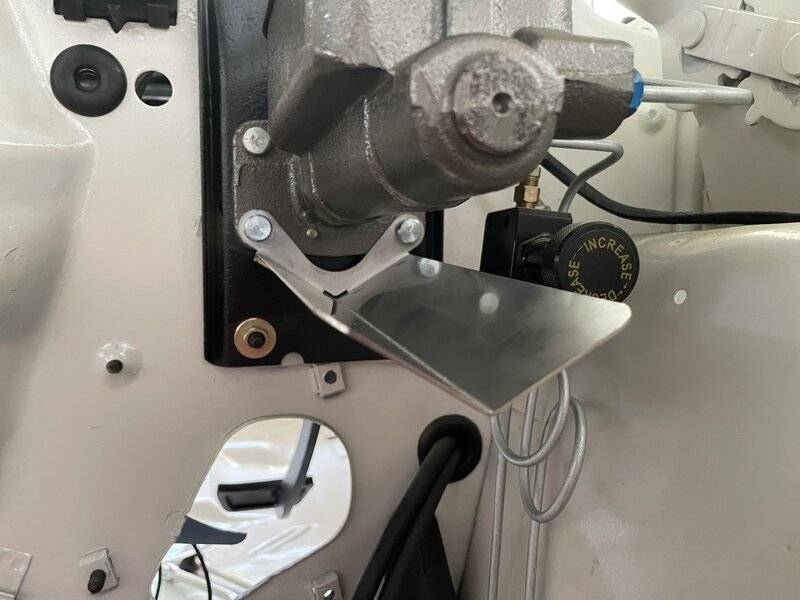

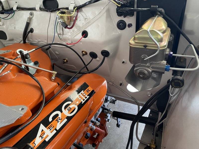

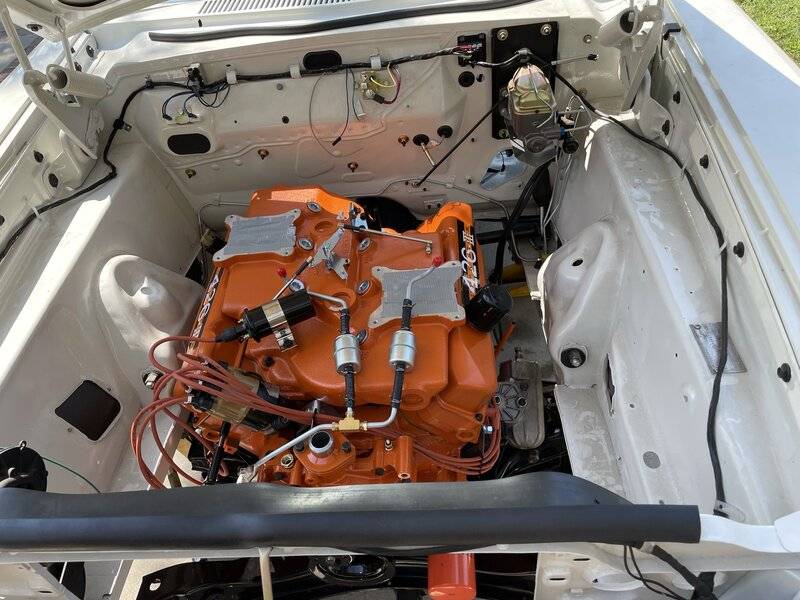

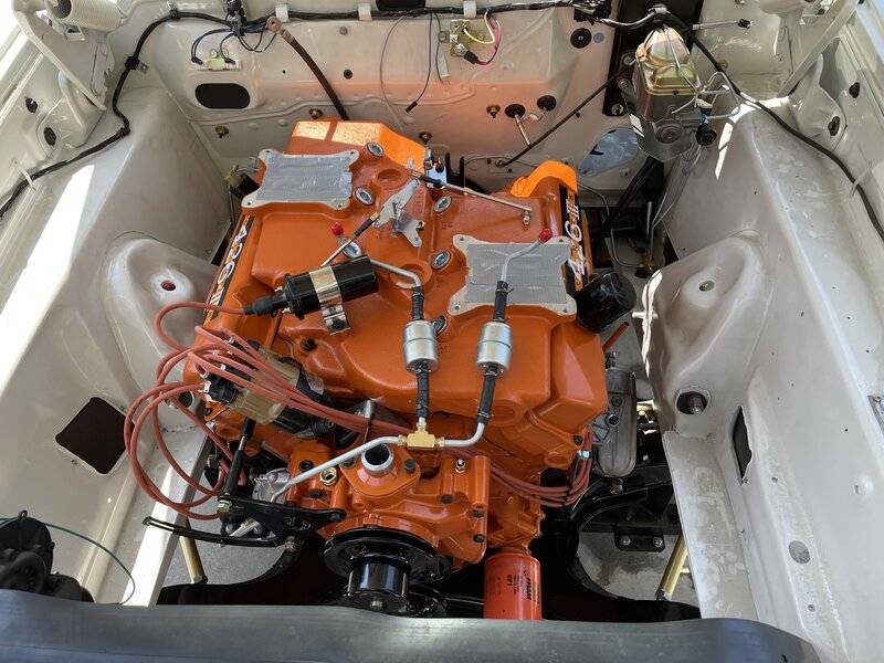

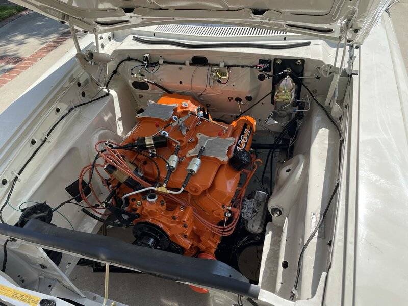

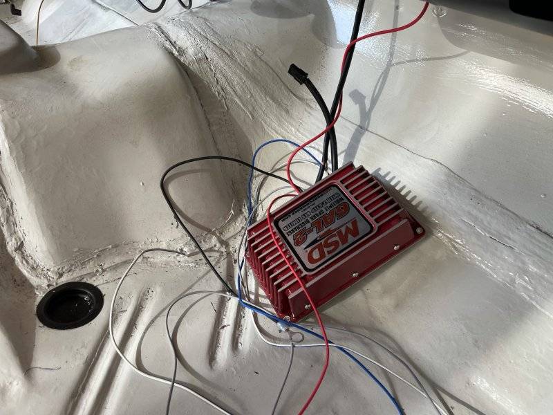

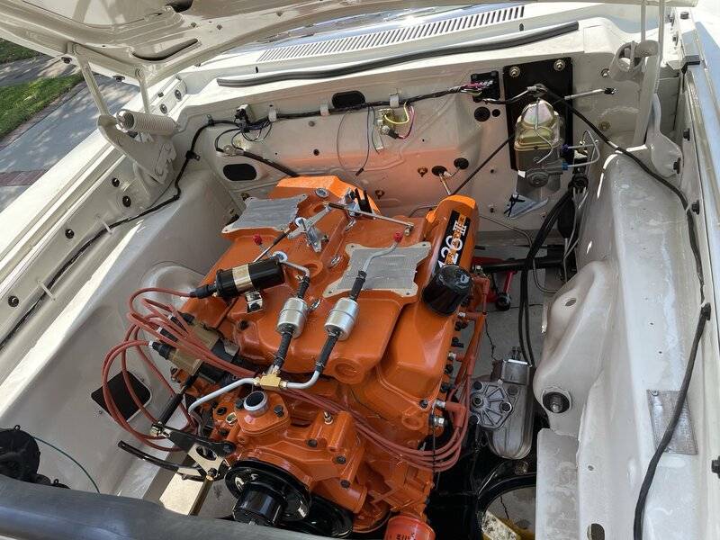

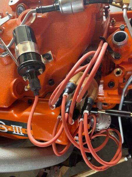

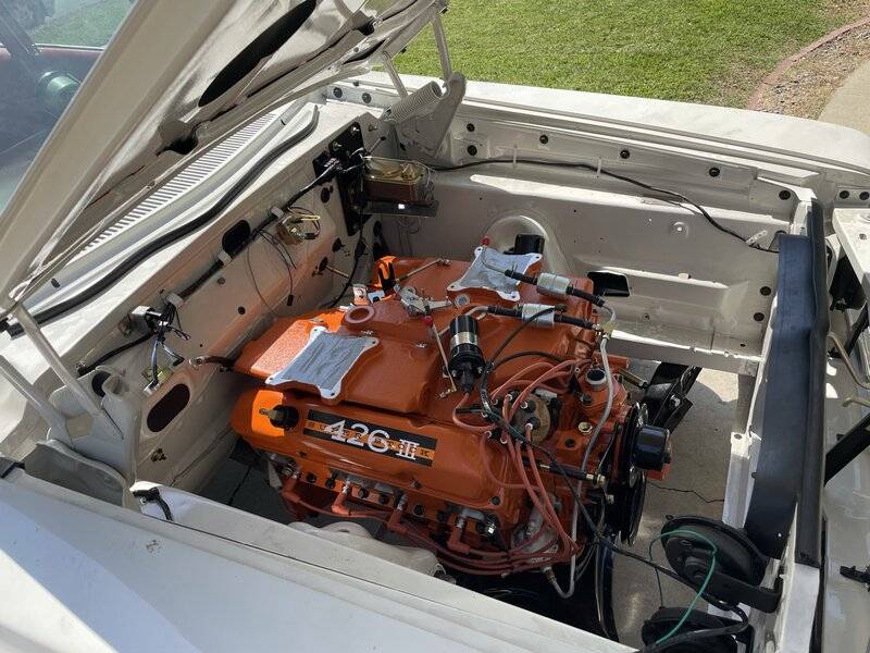

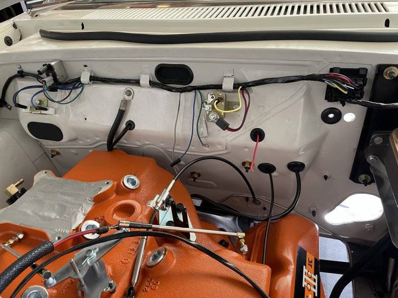

Got the clutch z bar connected, need the adjuster rod that goes to the fork. Also connected the oil pressure gauge feed line and the gray wire for oil pressure light switch.routed the coolant temp sensor probe cable and connected the throttle cable to the manifold and the engine ground cable to firewall.also routed the coil and white signal wire from MSD6al2 to the coil and distributor lead.will connect the voltage to the starter relay lug and mount the ground tho a good chassis point inside car. Trying to use all existing holes in firewall with out adding new ones.going to mount the msd under dash behind the glove box area like Mosher does. Leaving for Las Vegas this morning to go to the MATS, glad it's happening this year. I like the event been going for many years.

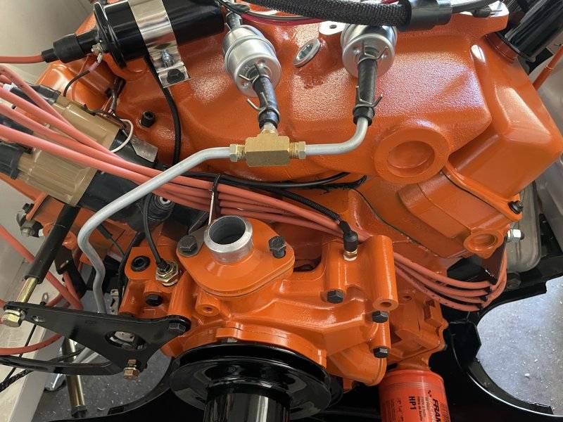

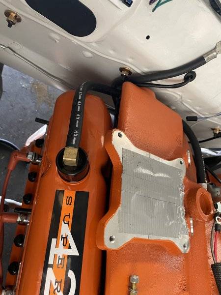

Pickup some 3/8 KV hose for pcv valve to intake fitting and enough to do line to pump and sender to fuel feed line from tank, need the clamps for those. I will install when they arrive.
