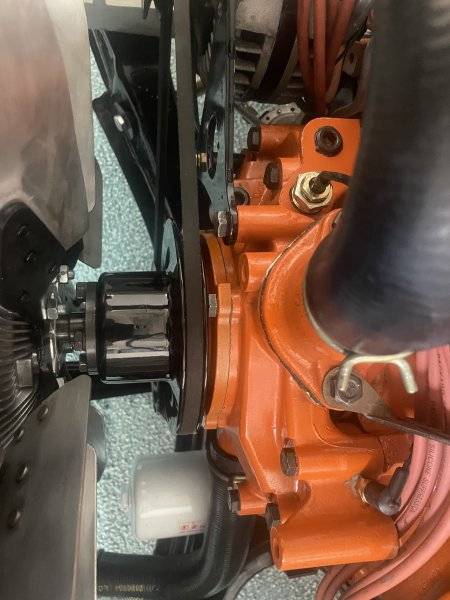

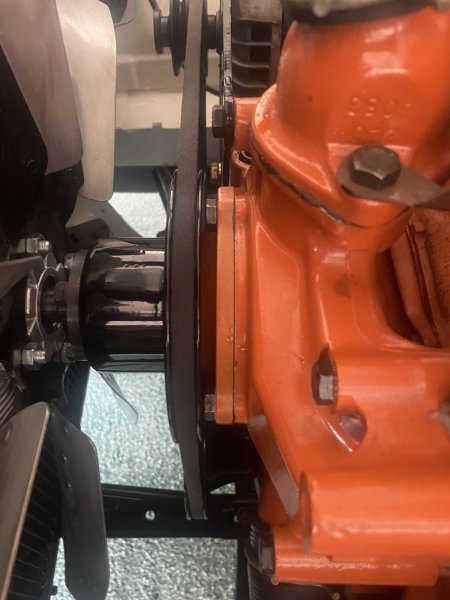

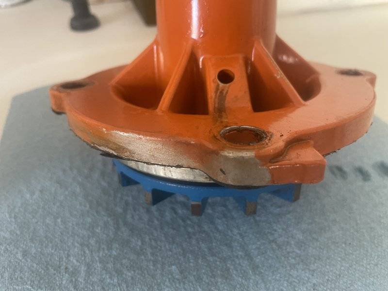

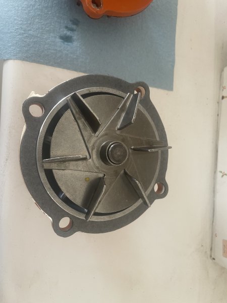

Here is the new 3rd pump mounted and picks at the show
Yes both had paper gaskets but this time I put liquid Teflon thread sealer on the bolt because I saw coolant drying up on the threads. Lol! Yeah that’s my Dad’s yellow submarine Lol!Your using a gasket? I put a MP aluminum pump in a housing no gasket and pump impeller fins dragged on back of housing. I'd check that even with a gasket. Car looks great. That yellow submarine hurts my eyes. Edit see you used a gasket.

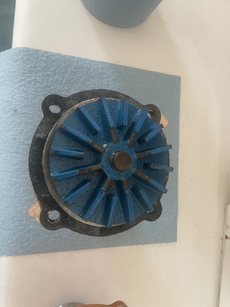

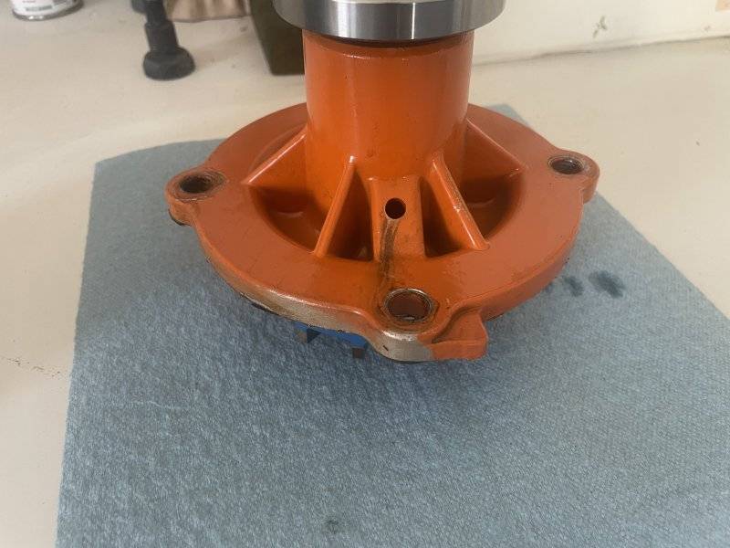

I use distilled water too but also add in a bottle of water pump lubricant and a bottle of rust inhibitor.....Well the other day I took the Savoy out to a local car show which was only 3 miles away and when I got there and opened the hood to change out the air filters to the velocity stacks I noticed splash marks on the inside of the hood and on the passenger inner fender, looked and saw coolant dripping from the weep hole on the water pump. As some of you remember when I first filled the engine with distilled water the Milodon pump I had was pouring out its weep hole and it was brand new never run. Now this 2nd one with only 550 miles on it and it’s leaking. It’s not a Milodon pump but a 440 source high flow pump. So when I was at Mats last weekend I got a Mopar high flow pump. I installed it last night and now I’m at a show this morning in Havasu and so far so good! We shall see
